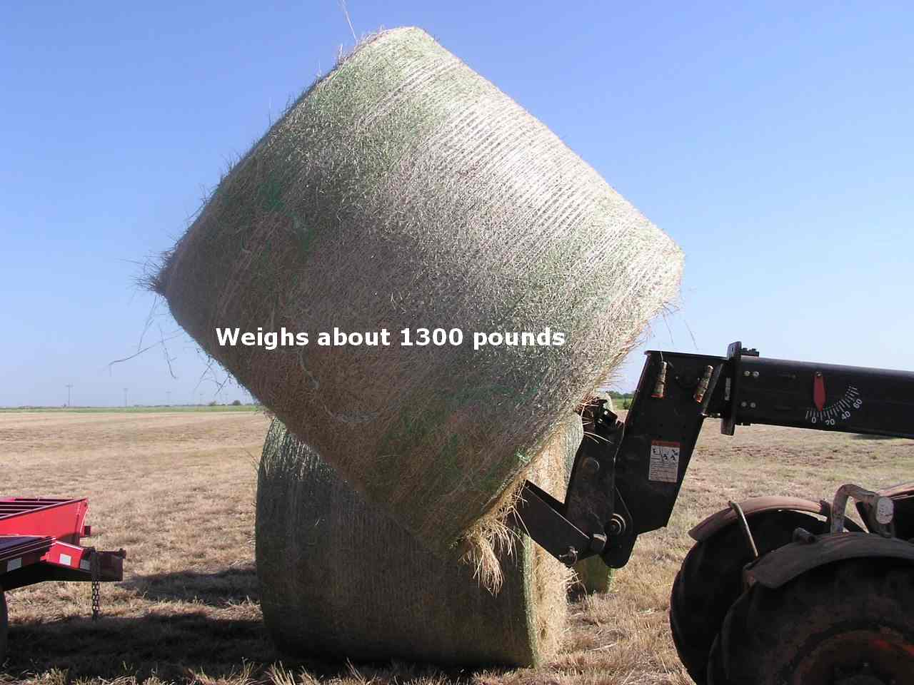

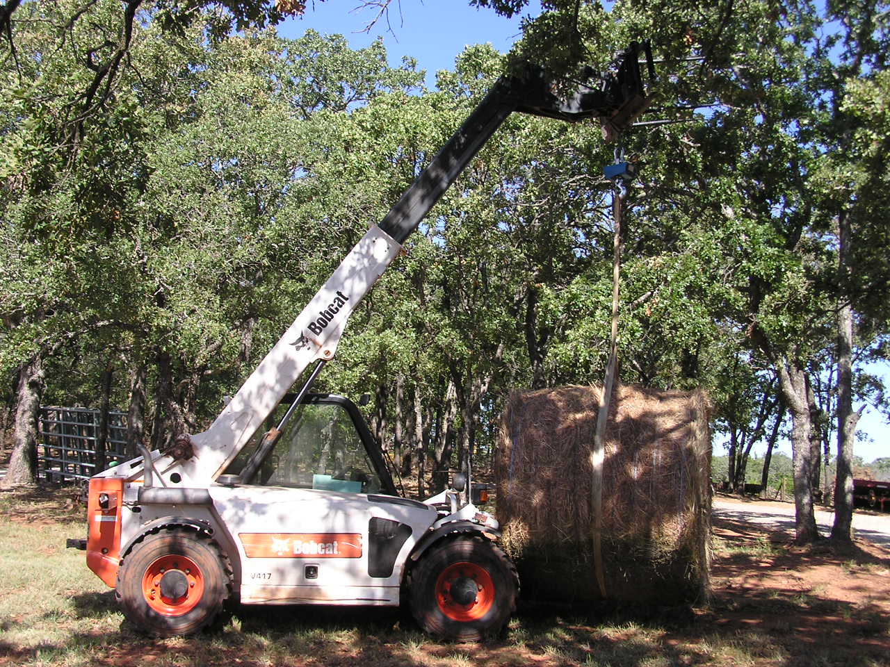

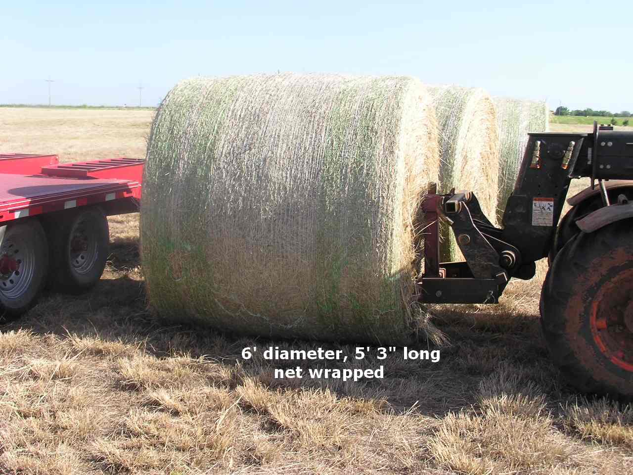

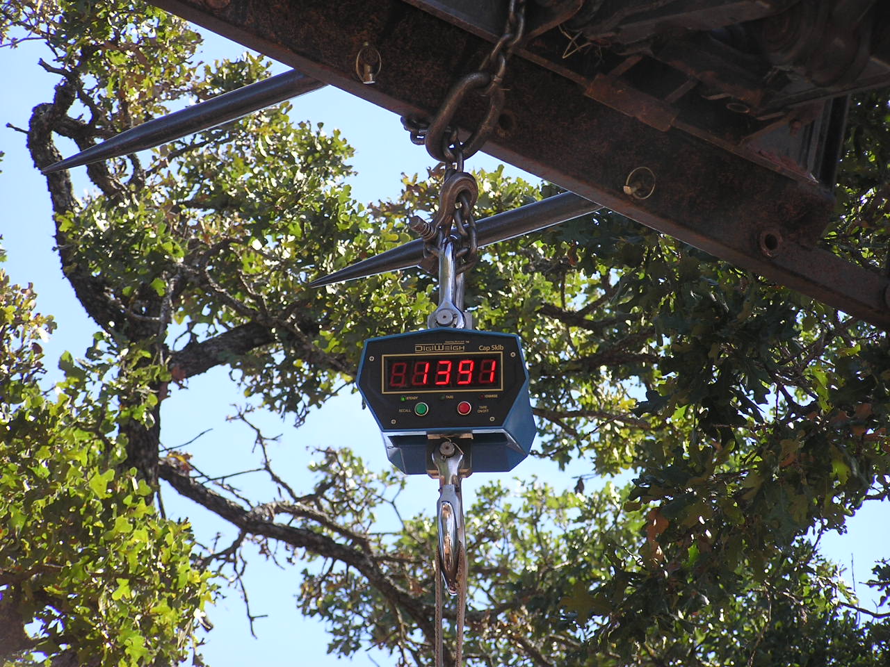

Full size utility. A 6' or 7' bush hog is heavy and requires a fair amount of HP. Round bales go 300 to 600 pounds depending; you will find the rear tires not biting well with that weight in front of the loader, especially in slop. Round bales mean livestock which equals manure handling and more slop. Could you do all this with a compact tractor? Sure. Could you do it a lot quicker and easier with a larger one?
I use my 23 HP tractor for mowing in narrow rows and sometimes pulling a wagon; I use the 50 HP one for everything else. It skids logs, plows, discs, used to make hay with it, ran a fair sized tree spade, runs the woodsplitter, etc., etc. And it does those chores a lot quicker and easier than a little tractor pushed to its' limits.
Utility tractor no question. fishead bob is spot on except even small round bales can weigh 800 lbs. Buy once, buy right.

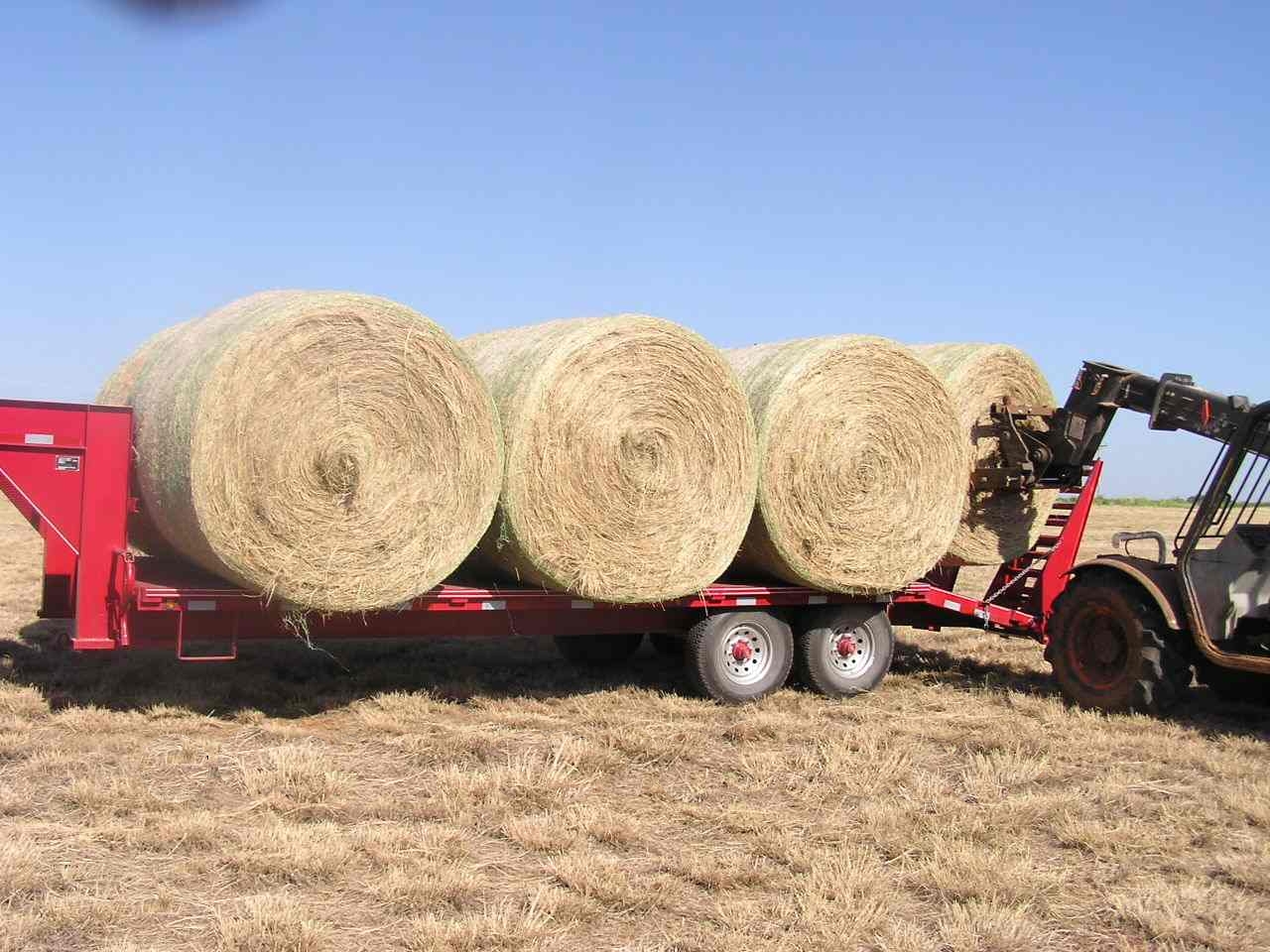

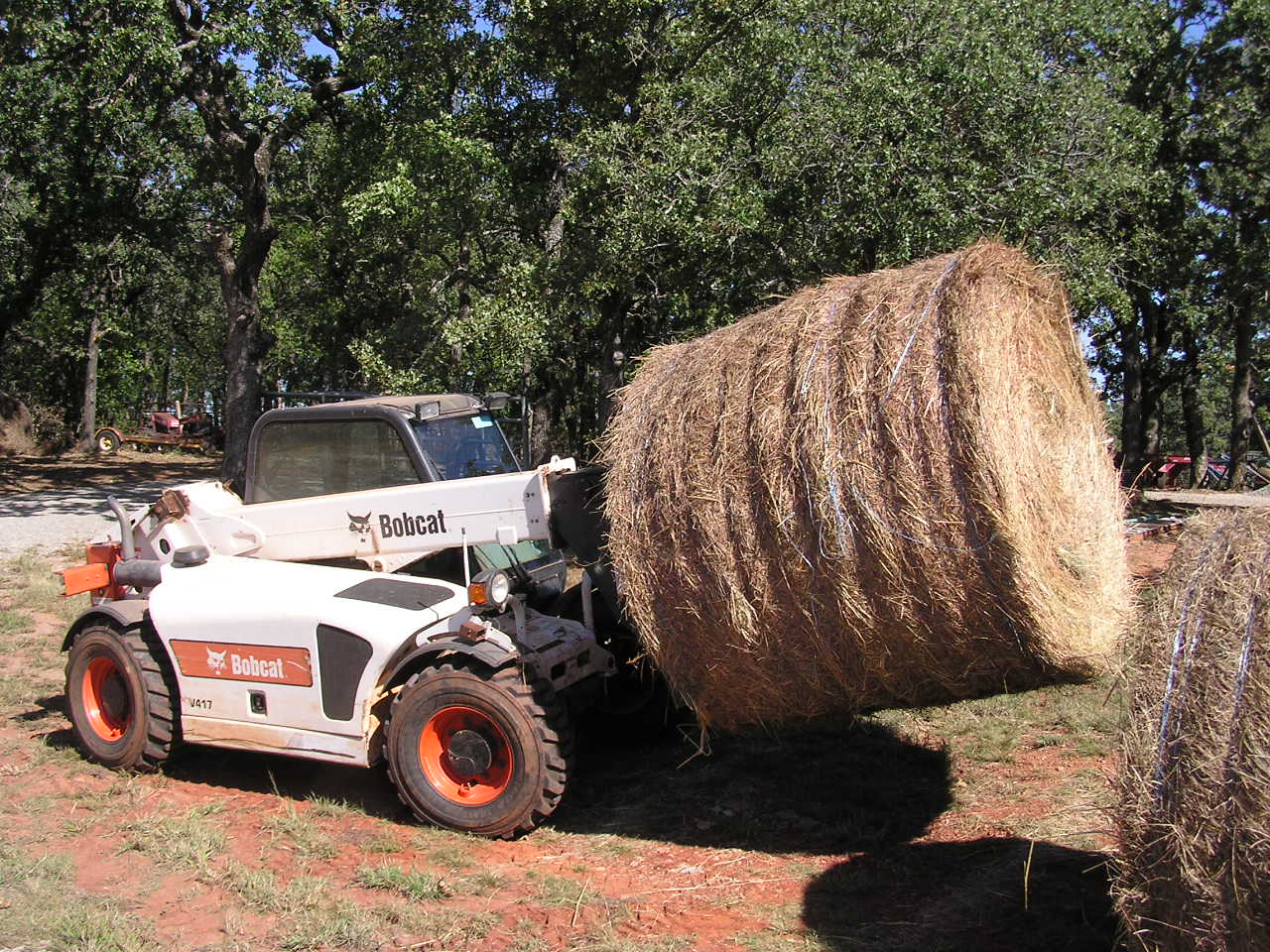

And the bigger 5x6 round bales that I use are 1200 to 1500 pounds.
