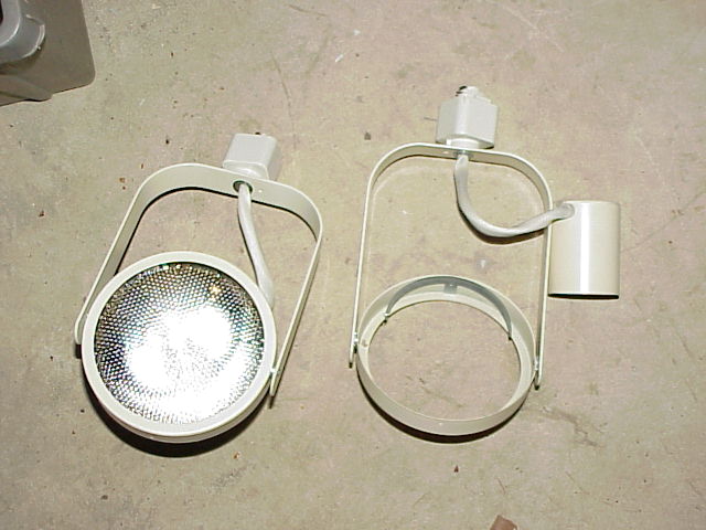

I used to manage a shopping center. Every time a tenant moved out and a new one moved in and did a complete remodel, the old panels, breakers, wire, etc. was removed and all new installed. To me it was a waste of money, but to the tenants contractors, it was faster than trying to figure out what was done in the past and how to make it work for there project. I just collected the old panels and breakers when they were removed. I have a abundant supply of Square D breakers and few panels. Unfortunately many of the panels were 3 phase, so I only took the breakers that I knew I could use in the future. This was before e bay got going. I only wish that I had takes some of the ceiling fixtures. They make great garage lighting. If the old tenant used a lot of track lighting and the new one didn't want it, out it came. I couldn't get them to take it down carefully, they usually just pulled it down with the ceiling. I have a box of old track light fixtures that I have used the bulbs out of in the cellar. Any one want them? If I get my garage wired the way I want to, it will be bright. I have 30 single tube 4' strip fluorescent fixtures to put along the wall. I even got a huge Onan generator that was on the second floor of the building and no one knew how to get it out of the building. I just waited till the next tenent started to remodel and had the excavator that was doing some of the work lift it down off the balcony and into my trailer. That tenent gutted the entire building to make a grocery store. The excavator was in there to dig up the concrete floor. They don't call me the Junkman for nothing. /forums/images/graemlins/grin.gif /forums/images/graemlins/grin.gif /forums/images/graemlins/grin.gif
