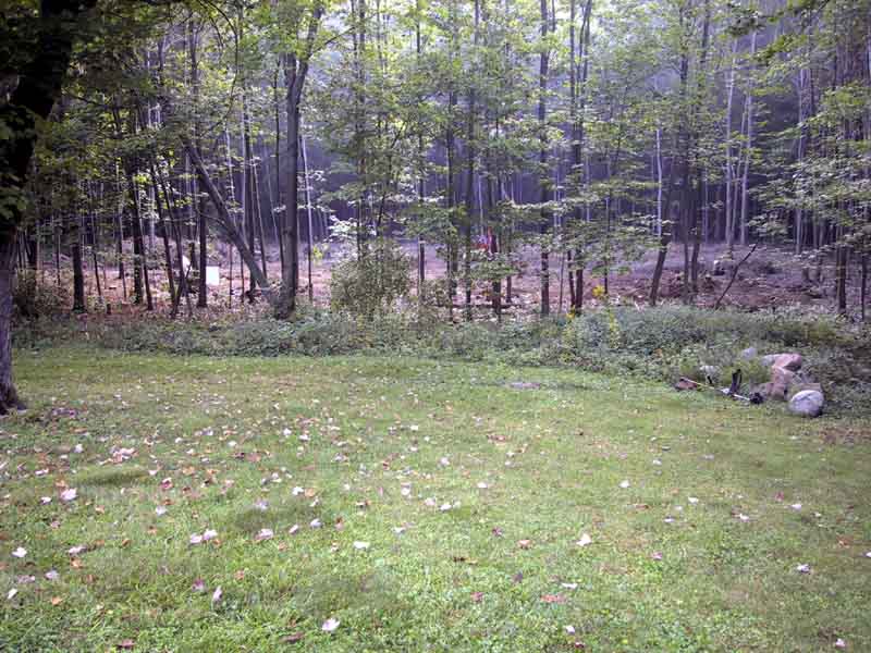

   / New Driveway and Polebarn
Attached is a pic of the site (looking due almost due east from the rear of our side yard) which is about 100' away from the house. Considering our current shed is a 300' plus walk from the house (almost all upslope) this will be an improvement. /forums/images/graemlins/grin.gif
I started working on clearing the site a couple of months ago and most of the following pictures were taken from then to this past week, except for some of the ones of initial work on the drivewayand road, which were taken last year.

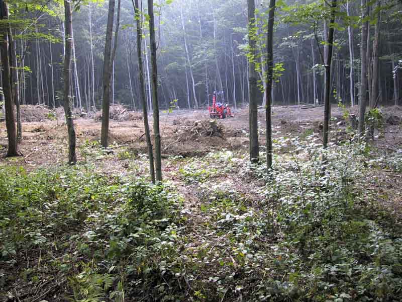

A little closer view looking East Northeast. Currently there is about a 2' drop north to south over 100' on the site and about the same amount of drop from the east/west sides of the site to the center. The building will be located towards the north end and on the eastern edge of the site. The area was originally a cornfield which grew up into a woods after the farmer quit farming it.
The plan is to remove the topsoil down to the clay (anywhere from 4" to 12") and then excavate clay soil from the high side (north & east) and fill in the low parts (south side & center)) and compact it. This will leave a couple of foot drop below existing grade on the north and east sides of the site. This is a little less than ideal but I don't know whether I can swing it budget-wise to bring in enough fill to raise the building pad significantly. Bankrun is probably the cheapest thing ..... any comments on whether it would be suitable would be welcome.
Barring that I will use some of the excavated topsoil to form a berm on the north and east sides on the remaining existing grade to channel surface runoff away from the building. Eventually I'd like to put up retaining walls on the north and east sides using landscape blocks.
I also plan on installing a french drain system using washed gravel and 4" perf flex pipe with soil sleeve encased in landscape fabric around the perimeter of the building on all sides to pull water away. Additionally there will another run of french drain under the approach/driveway in front. The layout of the drain system is like a bisected square - three north/south runs with two east/west runs at the top and bottom (north/south) ends - all of it connected together.

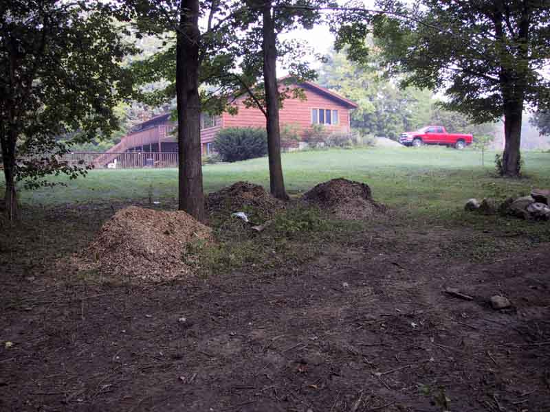

Looking back to the house from near the southwest corner of the building site.

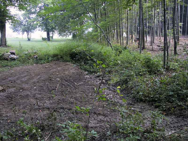

This is spot the previous two pictures were taken from. There's an outlet for a culvert that runs under the side yard in the weeds. It drains the front yard. We're planning on doing a dry creekbed sorta thing over top the culvert and down into the woods since during heavy rains the flow will exceed what the culvert can handle.

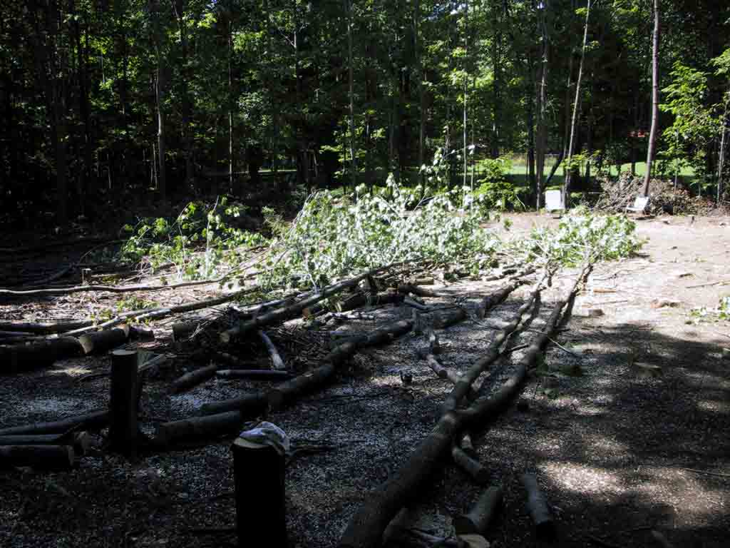

Clearing under way.

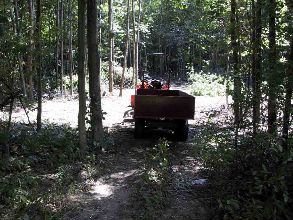

#9
Heading in for another load of wood.
Another pic.
