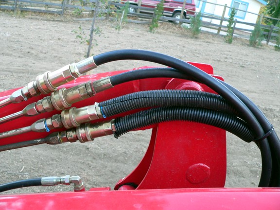

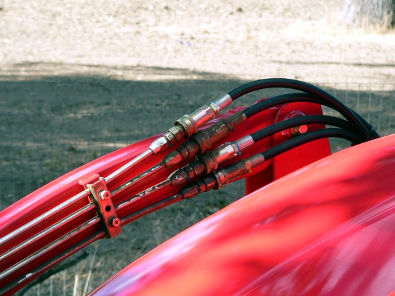

The new 2008 233/273 FEL hoses look better, but the bottom twohoses are close to the head of the boom pivot bolt and rub. I added some plastic split wire conduit for protection.
Before and after photos here.
