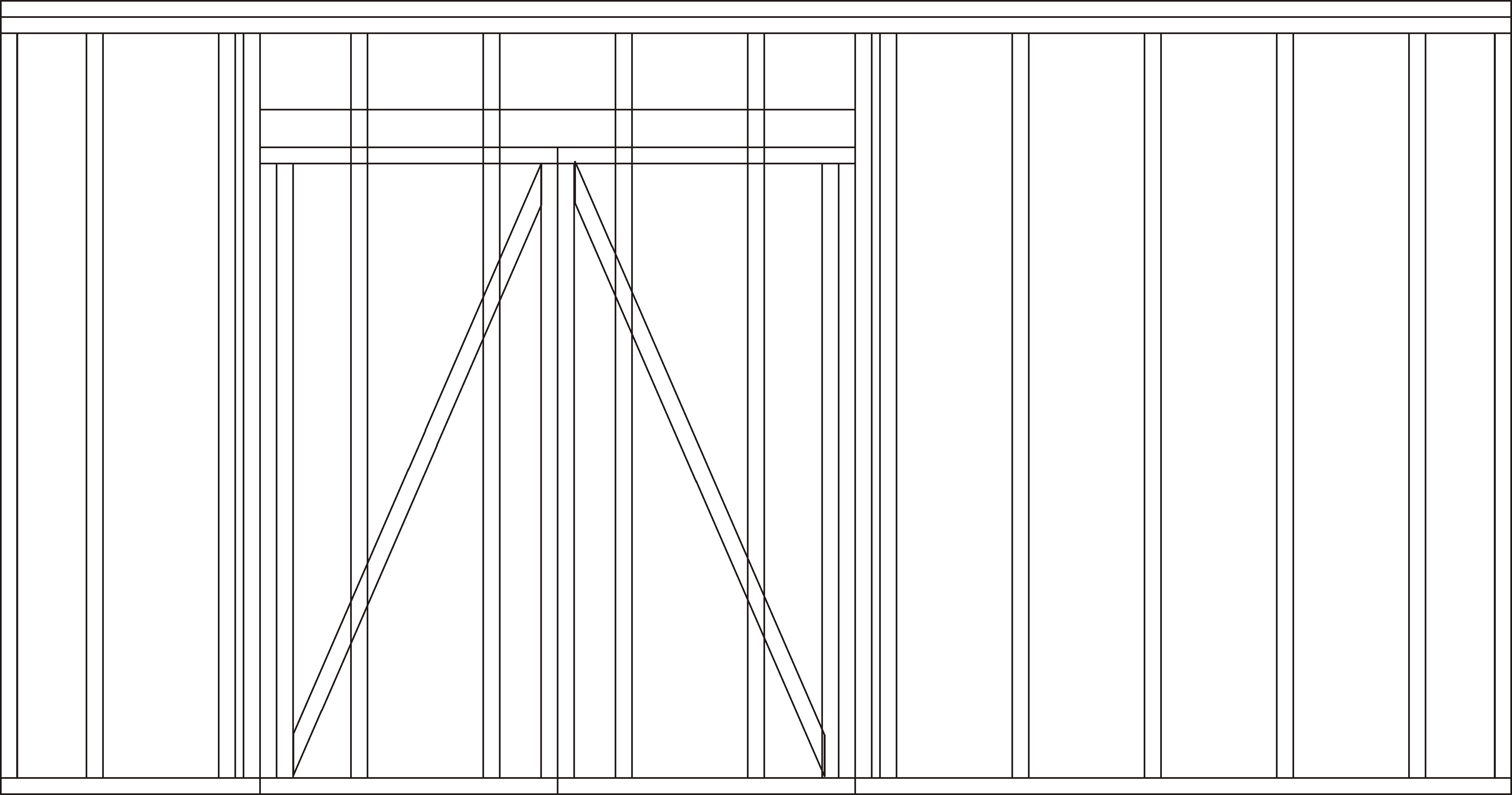

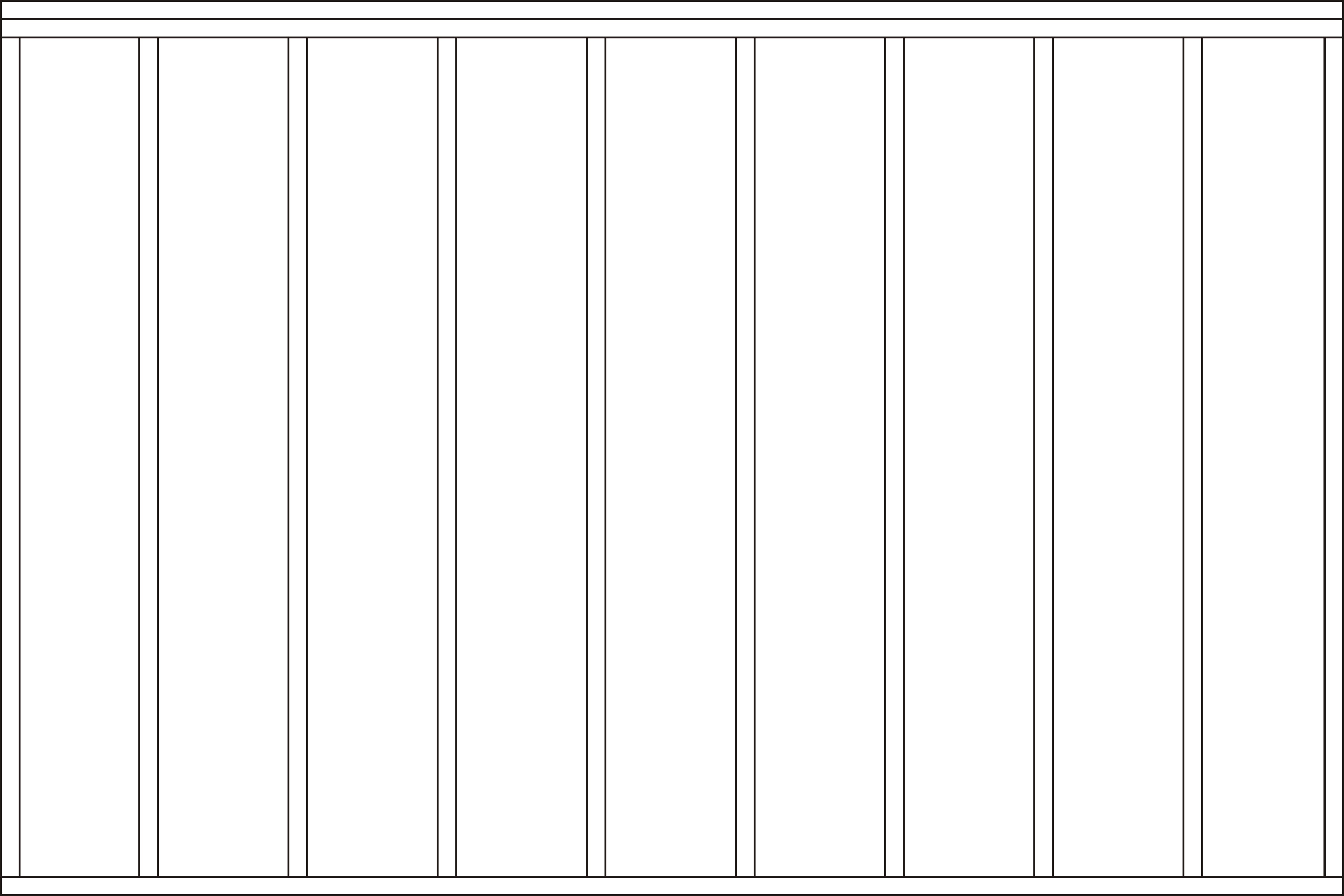

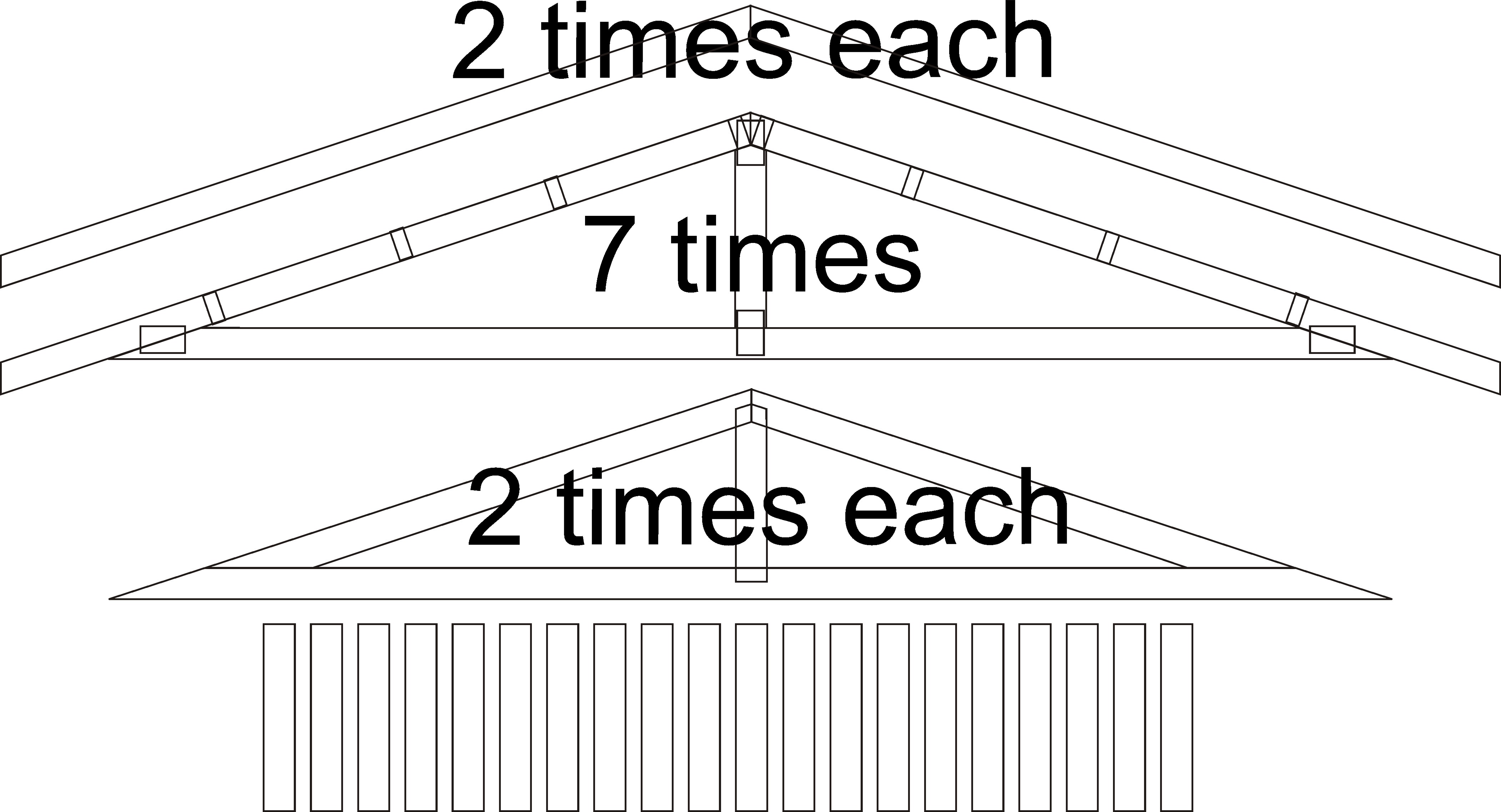

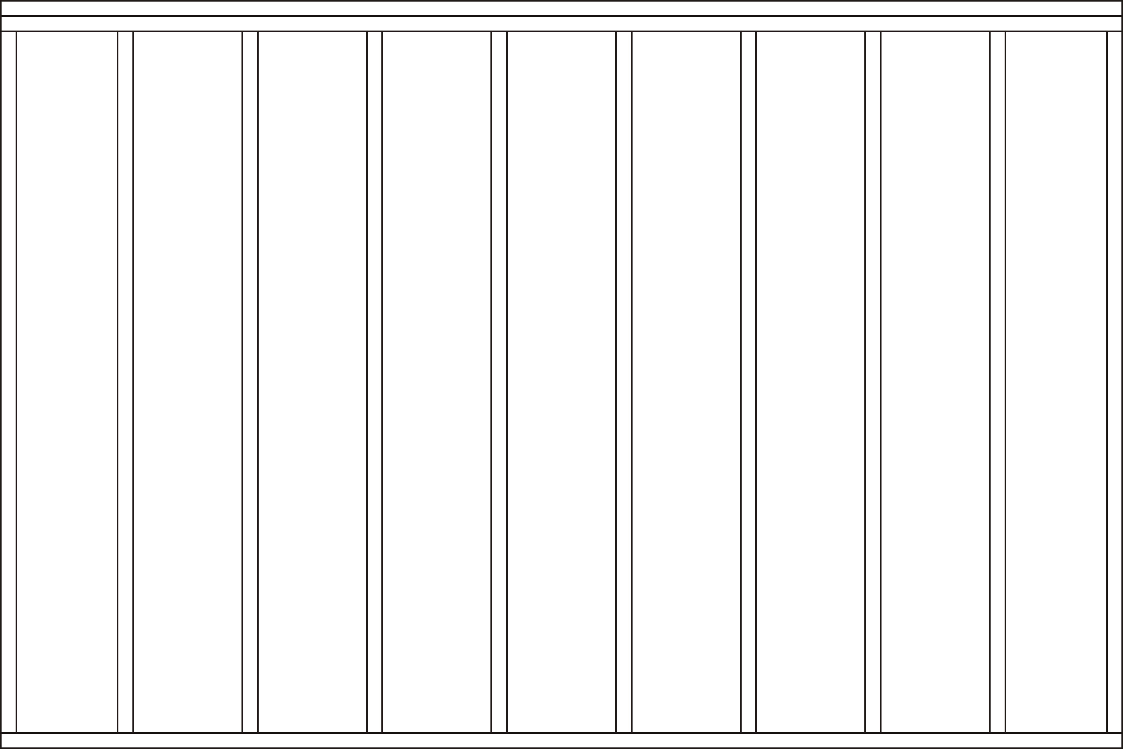

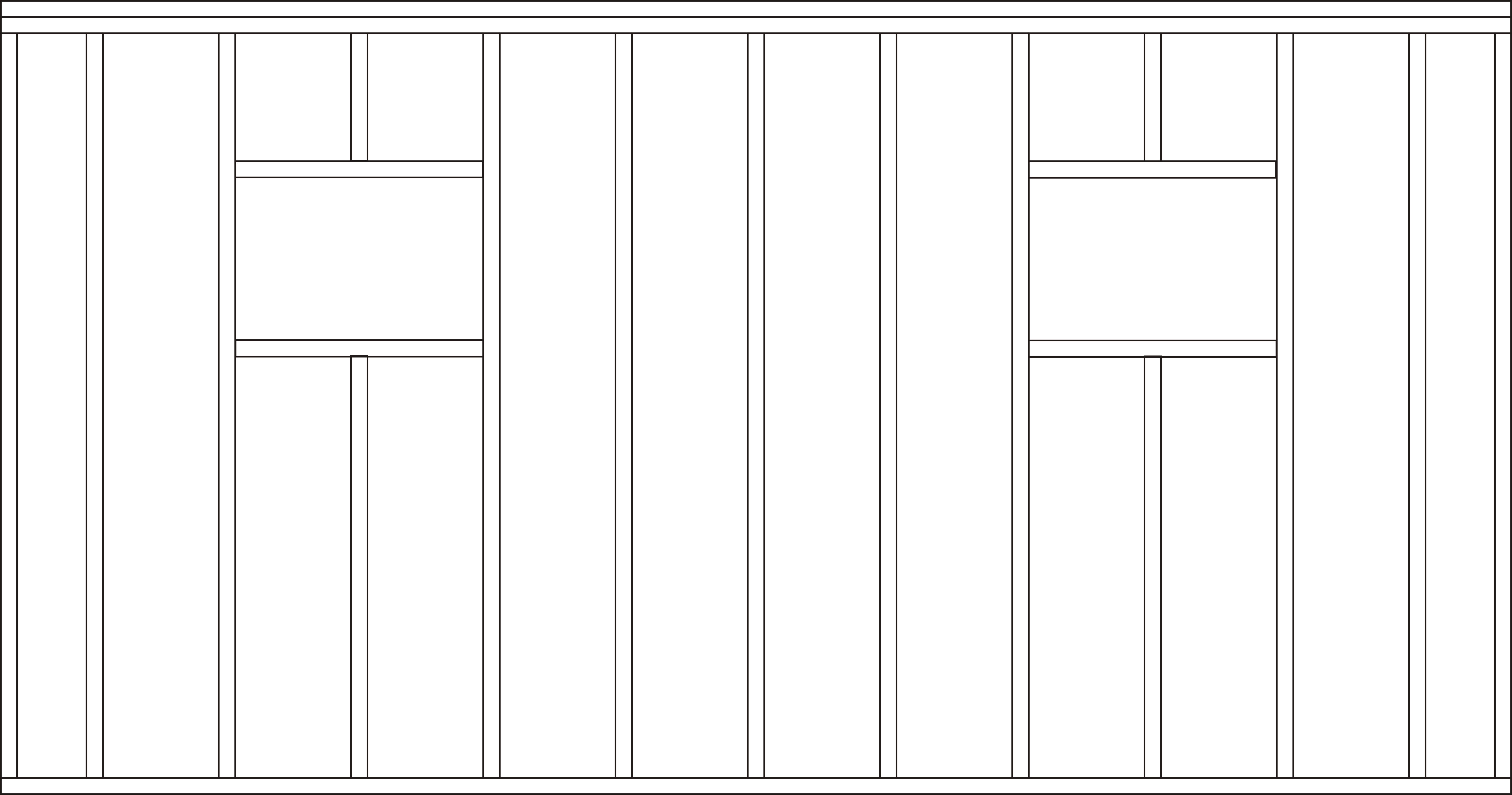

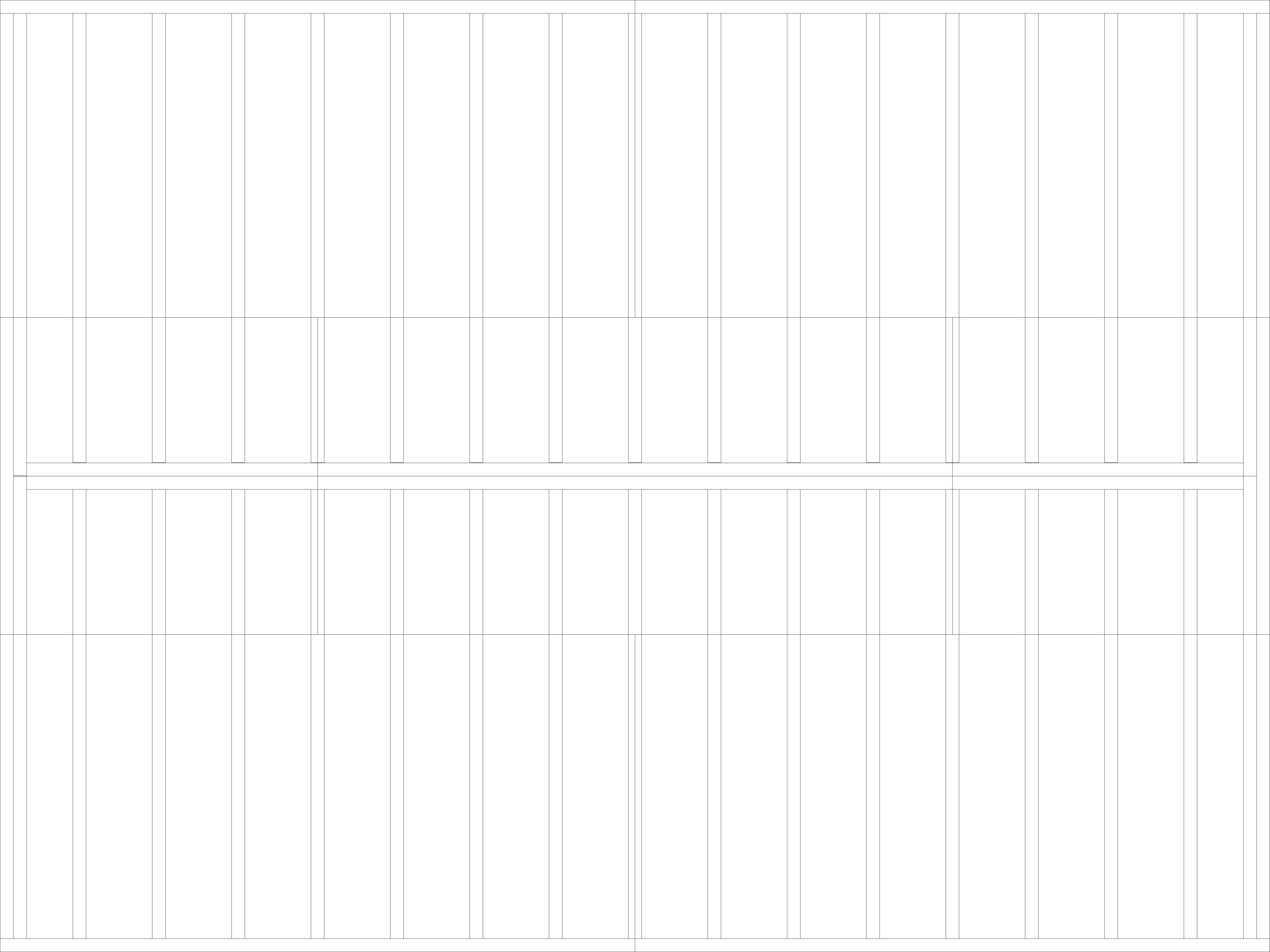

I built a 12' X 16' shed in peices in my backyard in Florida and transported all the parts to north Georgia and assembled them. It worked out great. I will try to include the layout here. OK that did not work I will try to shrink the file and try again. Ignore the first attachment I cant figure out how to delete it
