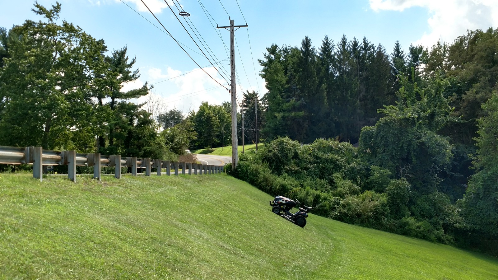

I have a brand new Craftsman Pro Series 7000 that makes me sick from the white smoke. It’s my second unit as the first one did the same thing so I exchanged it for another one. The oil level is fine. It is rated for steep terrain which is why I bought this model. I do use it on hills more than 15 degrees. It starts smoking after about 30-45 min of mowing. Has anyone heard of this problem? I am going to return this and buy another model next year. Not sure if I should stick with Craftsman or go with another brand that might be better on hills. Thanks.
   / new craftsman spewing smoke #2

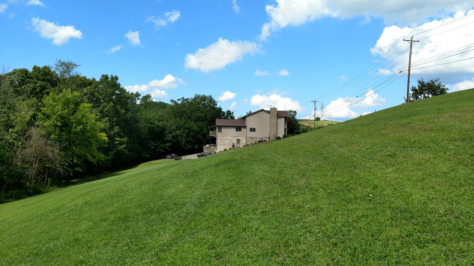

Is it equipped with the Briggs engine or the Kohler Courage? I have had the Briggs V-Twin version before and it had issues similar to your description on my property for around 4 years before the engine decided it had had enough and stopped rotating. My current is a Kohler Courage V-Twin and it is really working and running great after almost 600 hours of use on 17 degree average side cutting and 32 degree up and back cutting. The Kohler is a FAR better power plant from what I have experienced. My opinion based on my history with the 2 engines is that I'll never own another Briggs engine unless its a full commercial grade unit. The cheaper consumer engines are smoke machines and die an early death if used on hills.

This has a Kohler engine. I’m really disappointed as I love the mower apart from the really loud engine and getting sick from smoke every time I mow! Your hills look like mine. My last Craftsman was their bottom of the line mower and lasted about 12 years. I don’t have faith in this one, I think it’s a design flaw.

What hours are on it, and also... Alabama calls hills what we call level ground up here in the mountain regions. The issue is with getting oil while the engine is tilted 15-30 degrees, many of the lower priced (non commercial) engines do not oil well (or at all) on severe angles. Your 7 years may be on relatively flat earth and with 150 hours.... so you would need to tell the rest of the story for it to have meaning. Your towns elevation there is 449 feet above sea level. My yard has over a 400 foot change in elevation from front to rear :) Looking at the topology map of your area, you are nestled in the low lands between 3 mountains, in other words in basically low laying flat lands. Free Marion County, Alabama Topo Maps & Elevations
