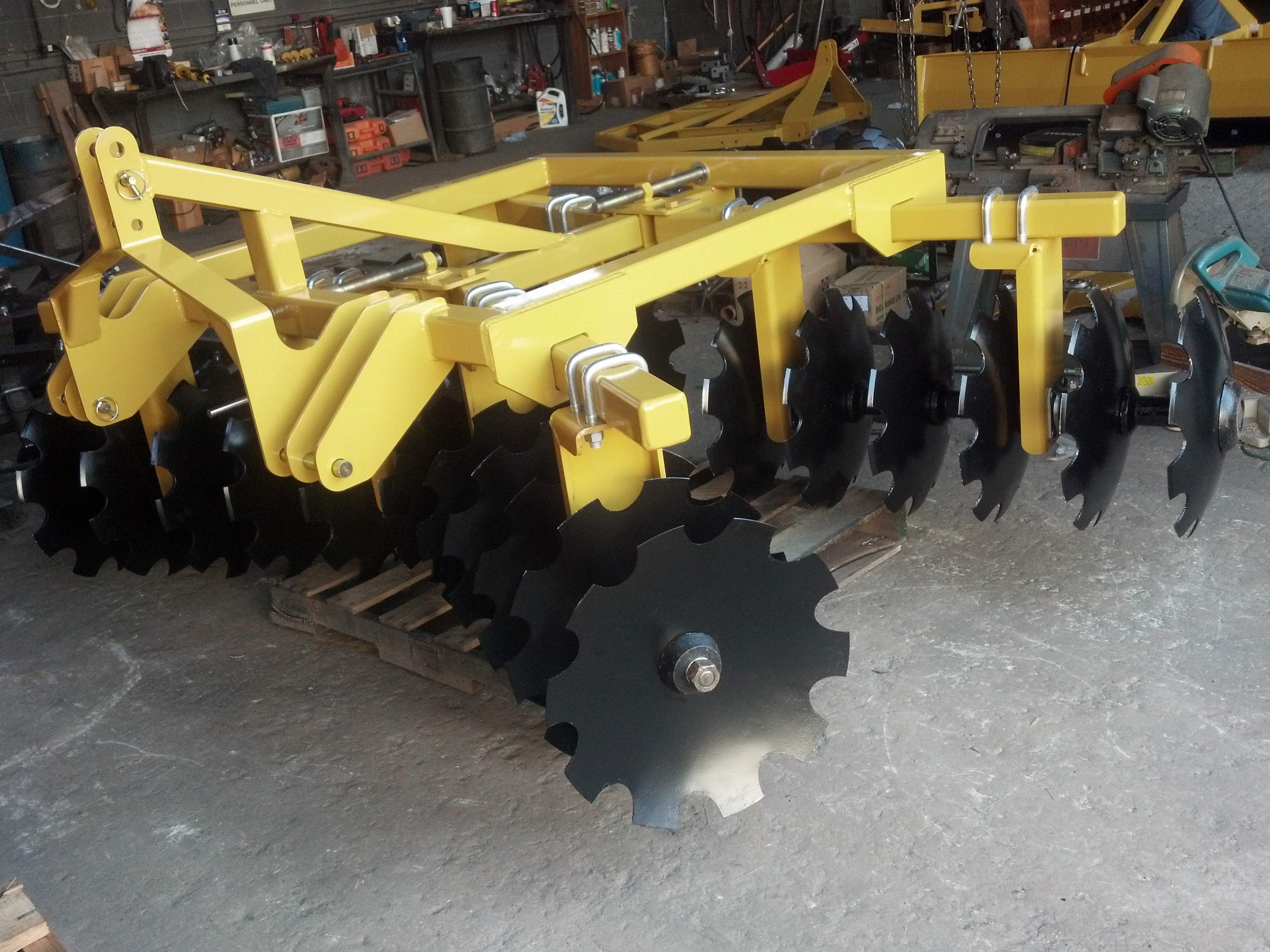

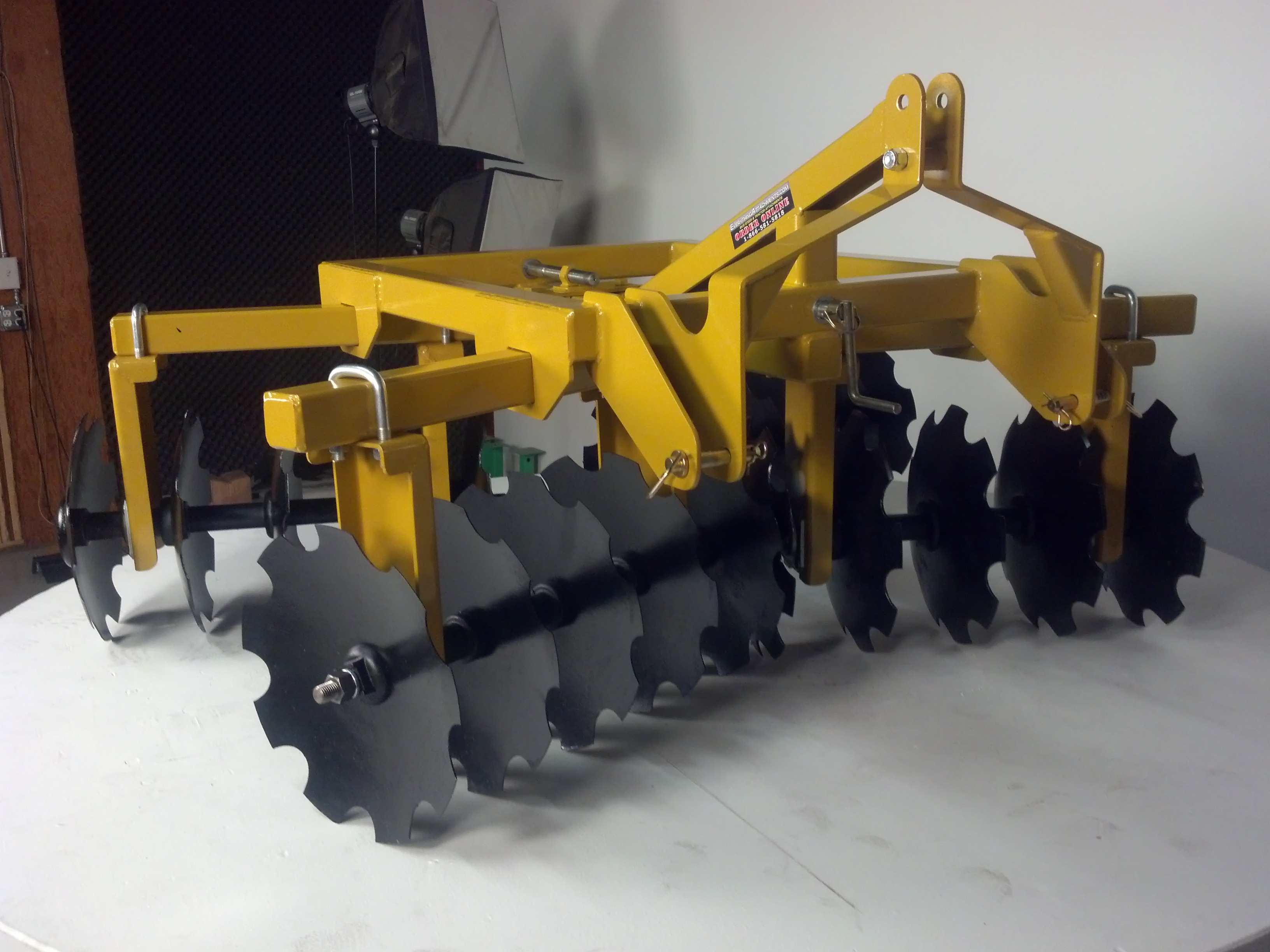

Here are some pictures of our new compact disc harrow, it has 12-18" discs, and is meant for a small compact tractor. We used our 45 HP class 3 Bobcat tractor to see if we could tear it up, as we have made some new design improvements over what we have been selling for a small disc. We are using greased roller bearings instead of friction bearings on all of our Everything Attachments discs, we have 4 models designed with this being the smallest one. The 12 disc model has a narrow hitch for subcompact and small compact tractors, it comes with 16 or 18 inch discs, only one angle setting, which is the most popular one, 21 degrees on the front gangs, and 14 degrees on the rear. More thought went into this than you think, and we will explain with a short video when we post on Everything Attachments for sale. All we lack is painting it now, and photographing it to post on our site.

Looks strong, Ted. Great job.:thumbsup:
   / New Compact Tractor Disc Harrow #3
Yeah, but did the 45hp Bobcat manage to tear it up?? If not, it is strong!! :thumbsup:
   / New Compact Tractor Disc Harrow #4
A closeup of the photos show nothing bent or broken.
   / New Compact Tractor Disc Harrow #5
It looks like a strong and simple disc. It does look quite similar to other products on your website. May I ask why you went with a tandem disc design for your new product, rather than an offset? It seems like that would have broadened your product offering. I own a couple samples of both types, and for my applications it seems an offset works better than a tandem. You obviously have solid reasons for designing things as you do, so I am interested to hear some of the thought process behind the design and manufacture of this product. Thanks for the post!
