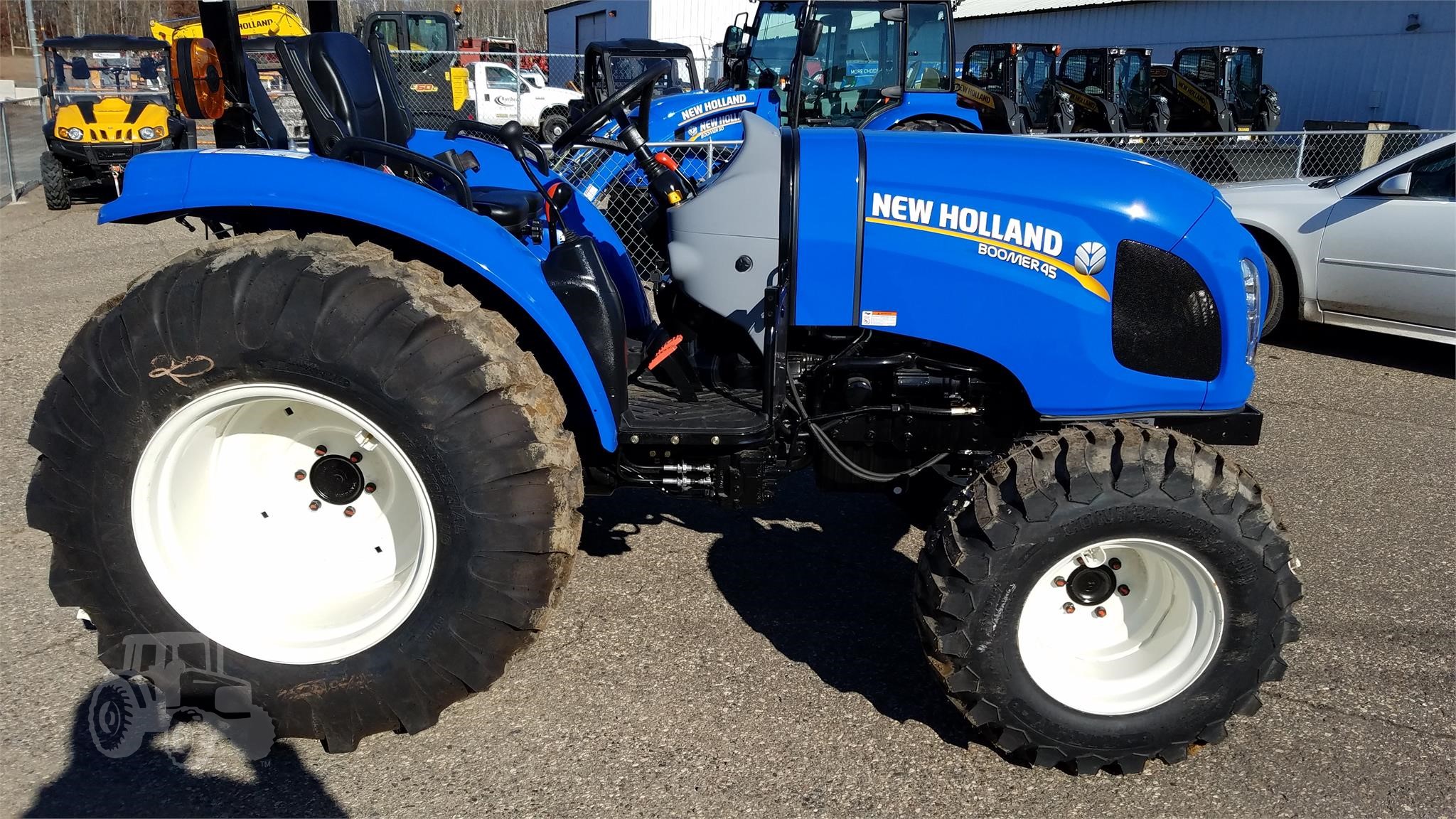

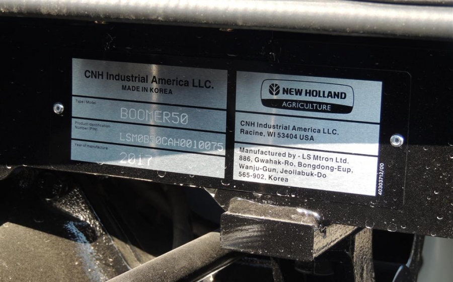

Just to clarify, the current (2017-18) New Holland compact tractors (Boomer compact and Workmaster compact) are made by LS tractor and have the same LS Mtron 1.9L 3-cyclinder turbo diesel engine. Other year New Holland tractors may be made somewhere else by someone else but the current compact models (Boomer/Workmaster) are made by LS. They have "LS Mtron Ltd." listed on the manufacturer VIN plates. The dealer I spoke with this month was not afraid to say who makes their tractors. :)
Side by side you can see they share nearly all parts.
New Holland Boomer 45
LS XR4150H
Your dealer must not have the Boomer Easy drive series, the 46d or 54d. They have the Fiat power engine and are made in Mexico. Ask him about those tractors.
