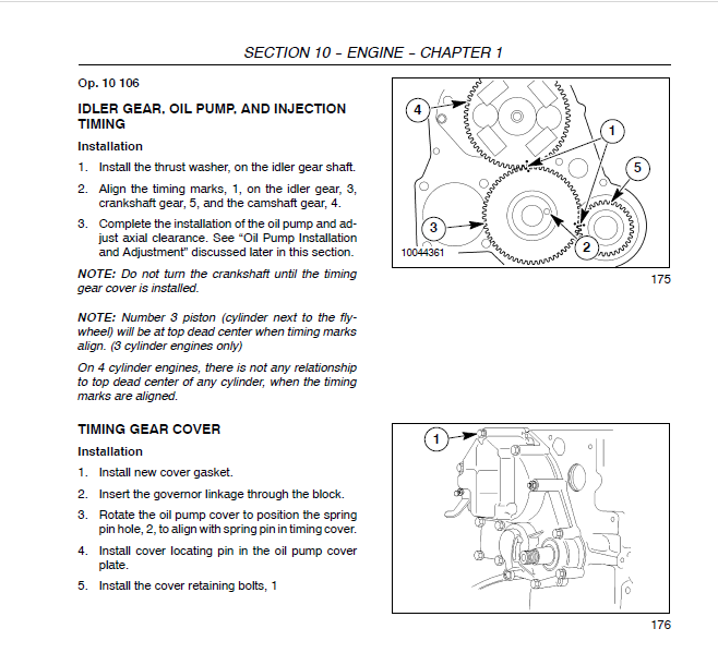

How do you find top dead center for a new holland tc35d? Need to redo the timing

Here is what I have from my TC40DA repair manual.

Thank you Randy. How do you find TDC to set the timing marks? Is there a vew port? Do you have to pull a glow plug? I am new to this.

All I can offer is what is shown in the manual. Mine is a 4 cylinder and has never had to be worked on.
