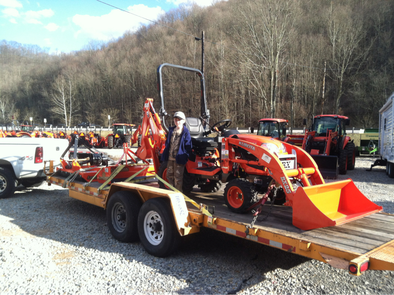

Well I finally bit the bullet and I am know the proud owner of a new BX25, LP box scraper and LP rotary cutter. Man am I psyched! The little guy in the picture is my best buddy (son) and he just wants to know when we can dig some holes!
Anyway, like I have read in many other posts, the list of options and add ons seems to keep growing. One option I want to add fairly quickly is a skid plate - so I would like to hear what your opinions are on BXpanded vs Brotek?
Thanks ahead of time for your input!

Congratulations!! Looks sweet!
I have various add-ons from both and they both produce first rate quality stuff, and I highly recommend both companies. It looks like you have a rear mounted mower. Is that for finish mowing, or do you have (or will be adding) a mid mount (belly) mower?
The reason I ask is that the BXpanded is one single plate covering the entire underbelly. It needs to be removed to use a MMM. The Bro-Tek is two plates. The rear plate covering the HST fan can be left installed with a MMM. If you remove the mower you can add the front plate.
For my situation the two plate set-up works better as I normally have a MMM on and can still have the back part covered. But, depending on your usage, this may not be a factor.
