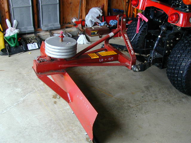

Hi rixtory; welcome to the board. I have a similarly sized MF GC2300 and I DON'T have a blacktop drive. But I DO have a straight Cat. 1 Leinbach Line 3pt-hitch 5-foot rear blade. This year I've rotated it 180 degrees so I'm pulling it into the snow with the convex side (therefore, blade is not digging in). In heavier wetter snow, I'll add some weight to the post a welding shop welded on for me (see pic). This has been working pretty well for me even though our winter is only a few weeks old (but it's coming in with a fury). I don't know if you'd want to try this on your blacktop. There's some good alternate suggestions here, but it gives you another option to consider. One more might be to adjust your top link so the blade isn't digging in. In any event, good luck!
