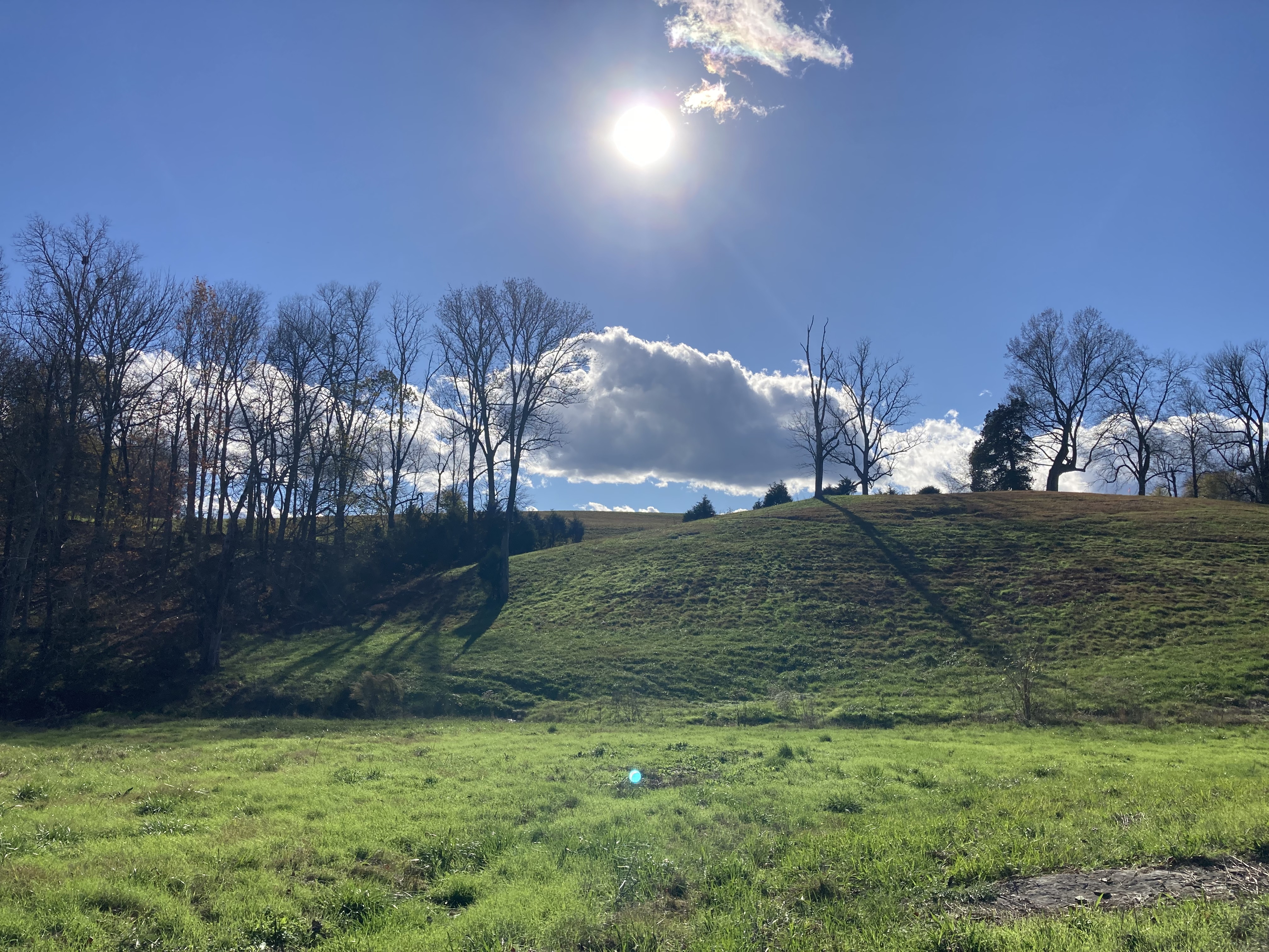

Hey guys, first post and need guidance in the purchase of my farm tractor. I have experience in commercial heavy equipment but want all info regarding my farm tractor purchase. I have a 14 acre plot with about 11 acres of pasture that needs to be brush hogged. Some steep areas so 4wd is a must…
Here is the list of questions and details i am working on:
HP rating and what size brush hog to go with it. Would like 6-7 foot if possible.
Brands which have good parts support for middle Tennessee.
Prefer pre emissions.
I’m an avid car and boat restoration guy so able to do several maintenance and repair tasks from my shop.
Hours I should consider on the vehicle based on how well it has been maintained.
I’m pretty much asking what you would do with a $21,000 budget living in my area with this land. I do need a loader.
Photo of land attached.

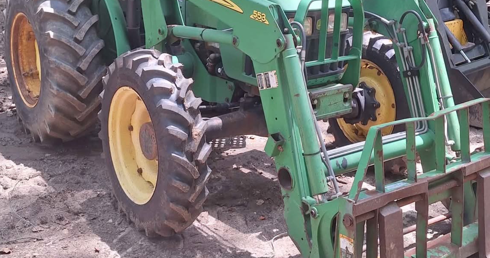

Looked at the photos. Look at the rear tyre RIMS. Construction tyre rims are 1 piece and Ag tyres rims are 2 piece. 2peice rims can be adjusted wider for a more stabil tractor, especially doing loader work. Spacers are another opion to increace track width for stability.
Ballast: liquid filled rear tyres and or make your own 3ph ballast box/drum(see threads re ballast boxes)
Loader: ASK if the lift capasity is calculated at bucket pins(looks good on paper) or 18" in front of bucket pins(real world weight ).
Loader buckets:1) 4 in 1 buckets are heavy, you loose lift. regular buckets are lighter.
2) many here have commented that a fork is very useful and wish they had got it sooner.
SHED: how high is shed clearance and how high is tractor. (bigger tractor, concrete floor etc)
Ergonomics: are slightly different for each model. eg a straight elbow is tiring on loader work. slightlybent elbow is best.

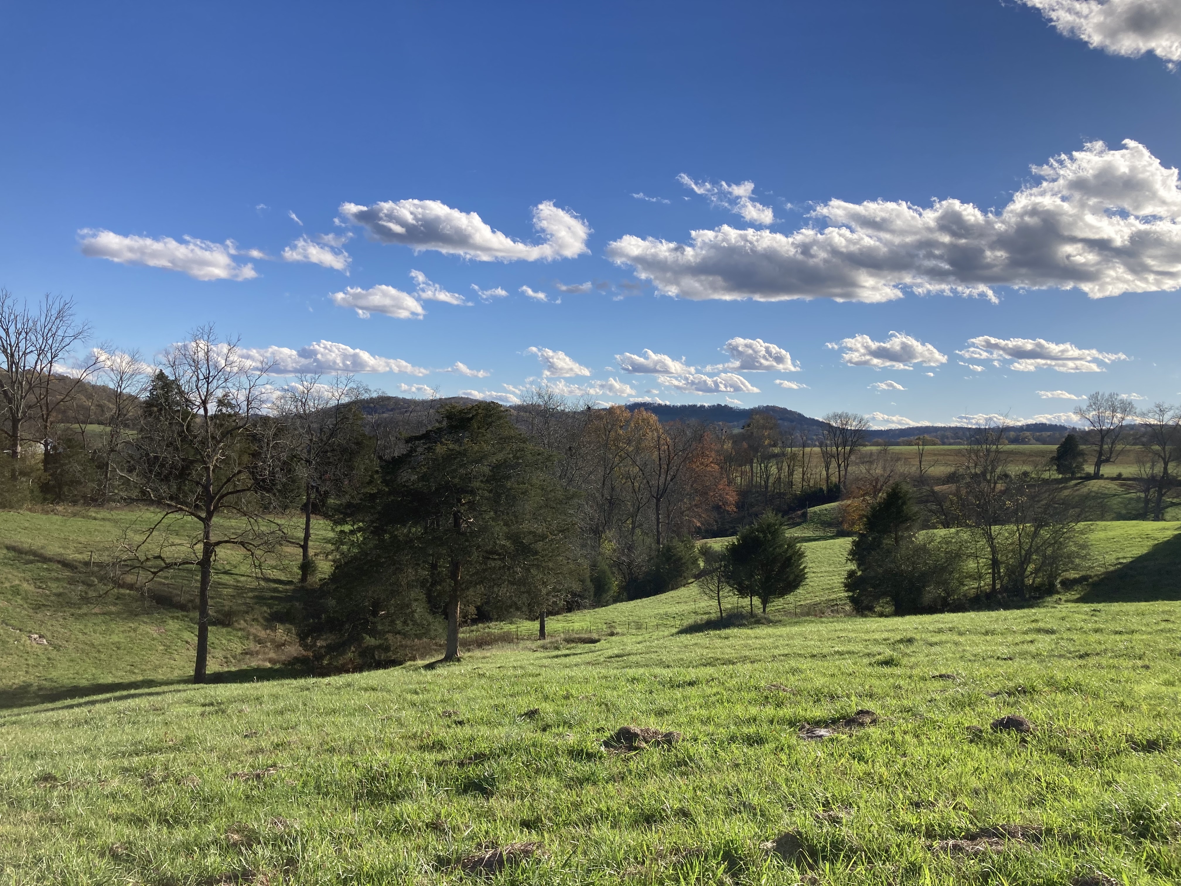

What I see in the first picture is a steep slope with either a creek or some kind of drainage ditch at the base of the slope. What kind of equipment has been used in the past to mow that slope?
My concern is that a typical 45 hp tractor might roll over on that kind of slope.
   / NEW BUYER IN TENNESSEE AND NEED OPINIONS
Straight up and down with a similar tractor as I listed. (Filled tires)
I also run a large zero turn to keep it trimmed.
That’s why I was leaning towards the 50+hp with wider track front axles and taller front tires. Appreciate the input.
