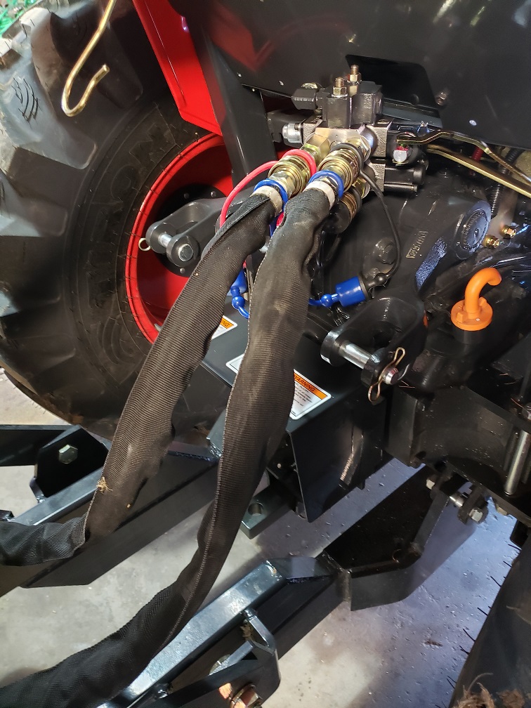

Got my remotes installed. I haven't got detent to work right (keeps slipping back to center) assuming I still need to do some adjusting.

Does not come standard. I added them (part#RMK2-02), and just so you know it was a simple bolt on with no additional fluid required. Now I'm thinking about a "tip and tilt". Do the add-ons never end on these things?

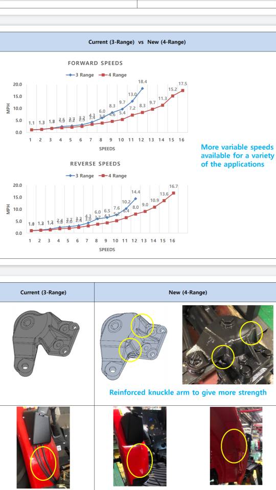

I found a chart showing the 3 speed vs 4 speed gear differences. Screenshot_20201012-150347_Drive.jpeg

So far the tractor has been all I wanted and more. Now I want more implements! Next on the list is a box scraper and brush hog. The thump I got was just the thump.. manually set in position by me. Now that I think about it I should have had the dealer add the hydraulics to it. I got over 10hrs on one tank (mostly backhoe and dirt work) and really didn't need to fill it. The dealer sent me that chart as well. No issues so far. And did I mention this tractor looks cool!?

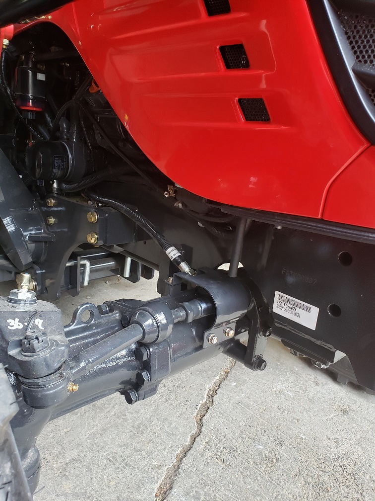

Just an FYI for those who care. Rumor has it that the new 20 series tractors are missing/may not be included stone guards for the steering rack. Mine didn't come with them and I've read in another thread of another. I let my dealer know and he sent them to me.20201015_160938-sm.jpg
