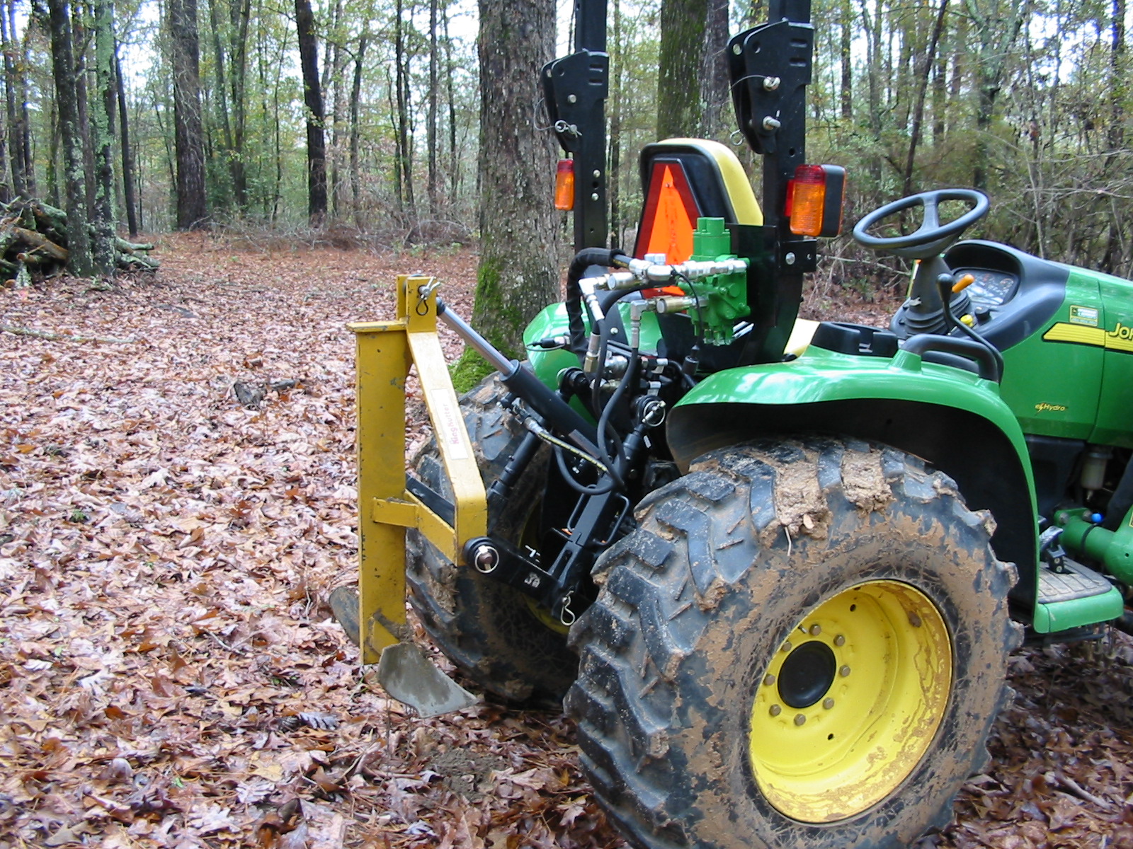

Both should be adjustable. One you have to take loose from the lift arm to adjust and the other should have two spin handles on it that allows for adjustment while still attached at both ends.

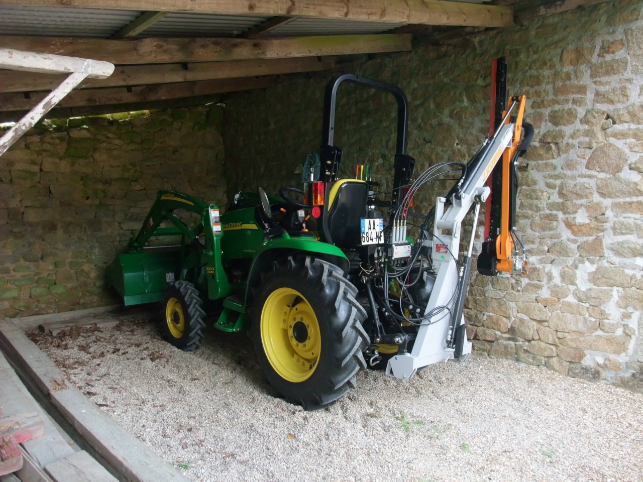

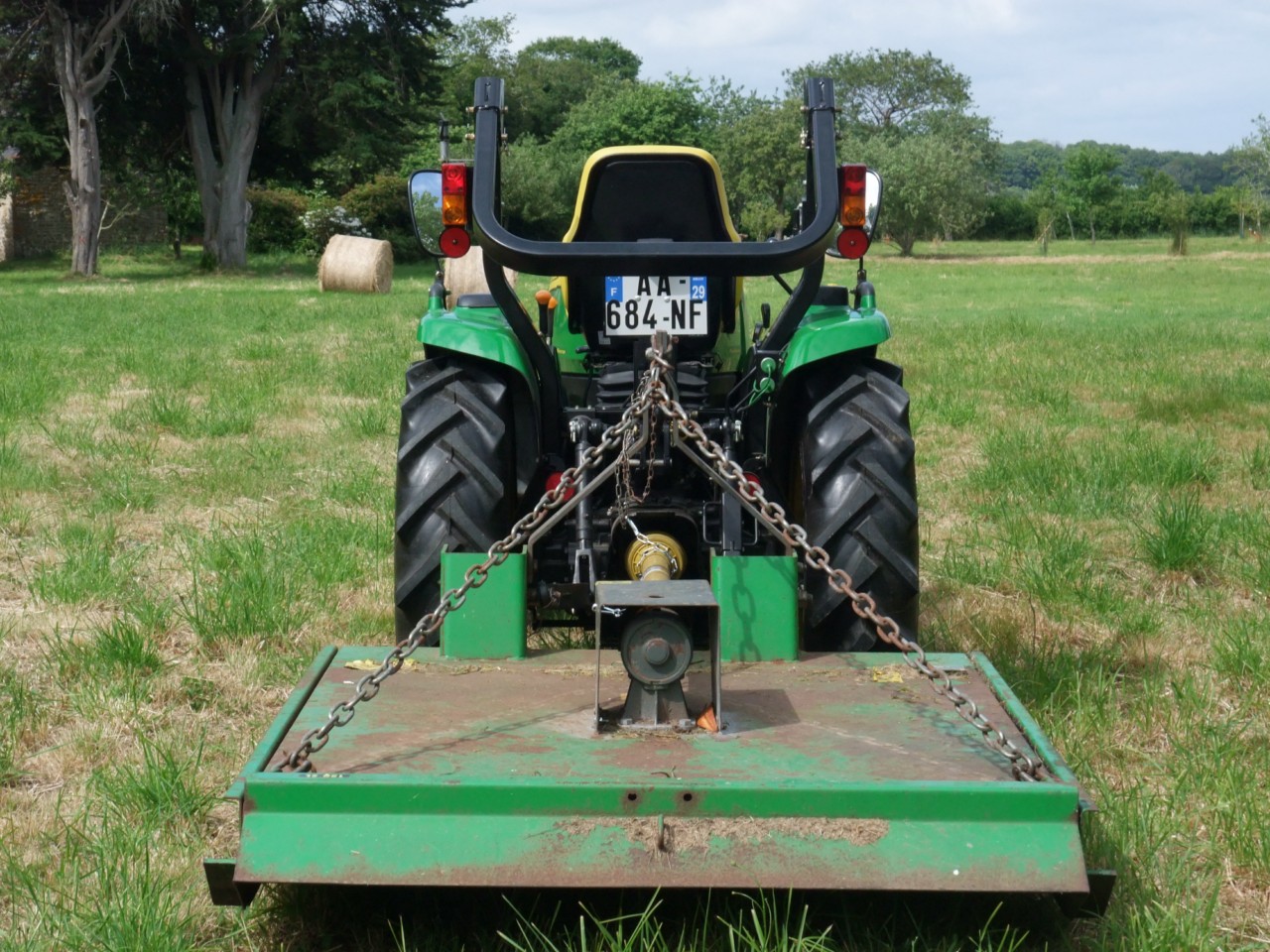

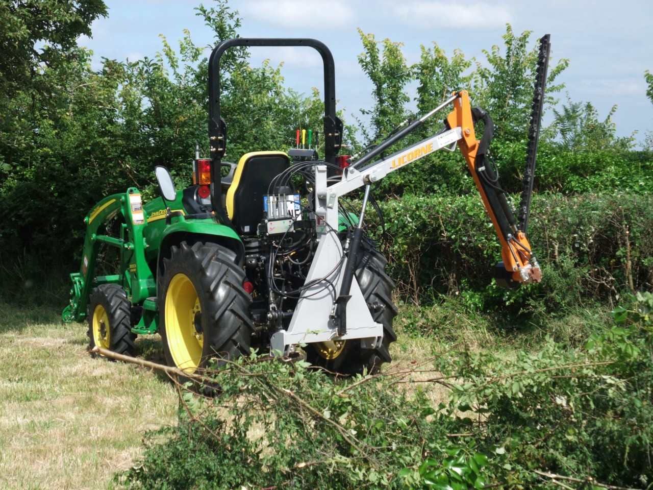

As COCRE said, it's very important to be able to adjust the lift arms to keep your implements level. Generally the right hand side is easily adjustable.

I was pretty sure that the one side should have a turnbuckle style side link. Both my side links are adjustable but only if you take them off at the top or bottom and adjust hem and then reconnect. I already took a few pics and sent them to my dealer. He was pretty sure it was wrong also he was just trying to figure out how it happened. I have had a lot of that from this dealership. I have really kept my cool with them because I figure they are warranty work if I have real trouble.
