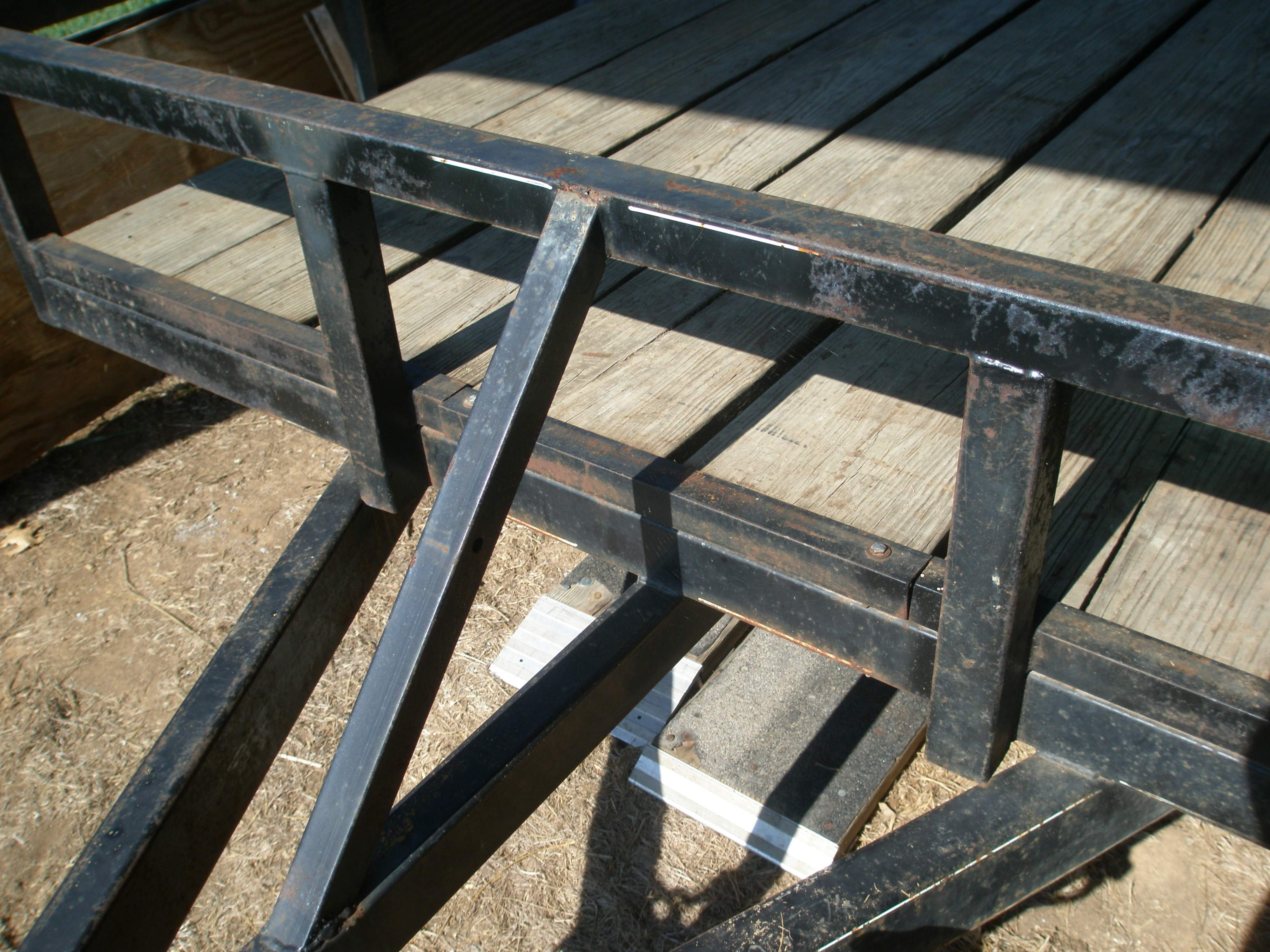

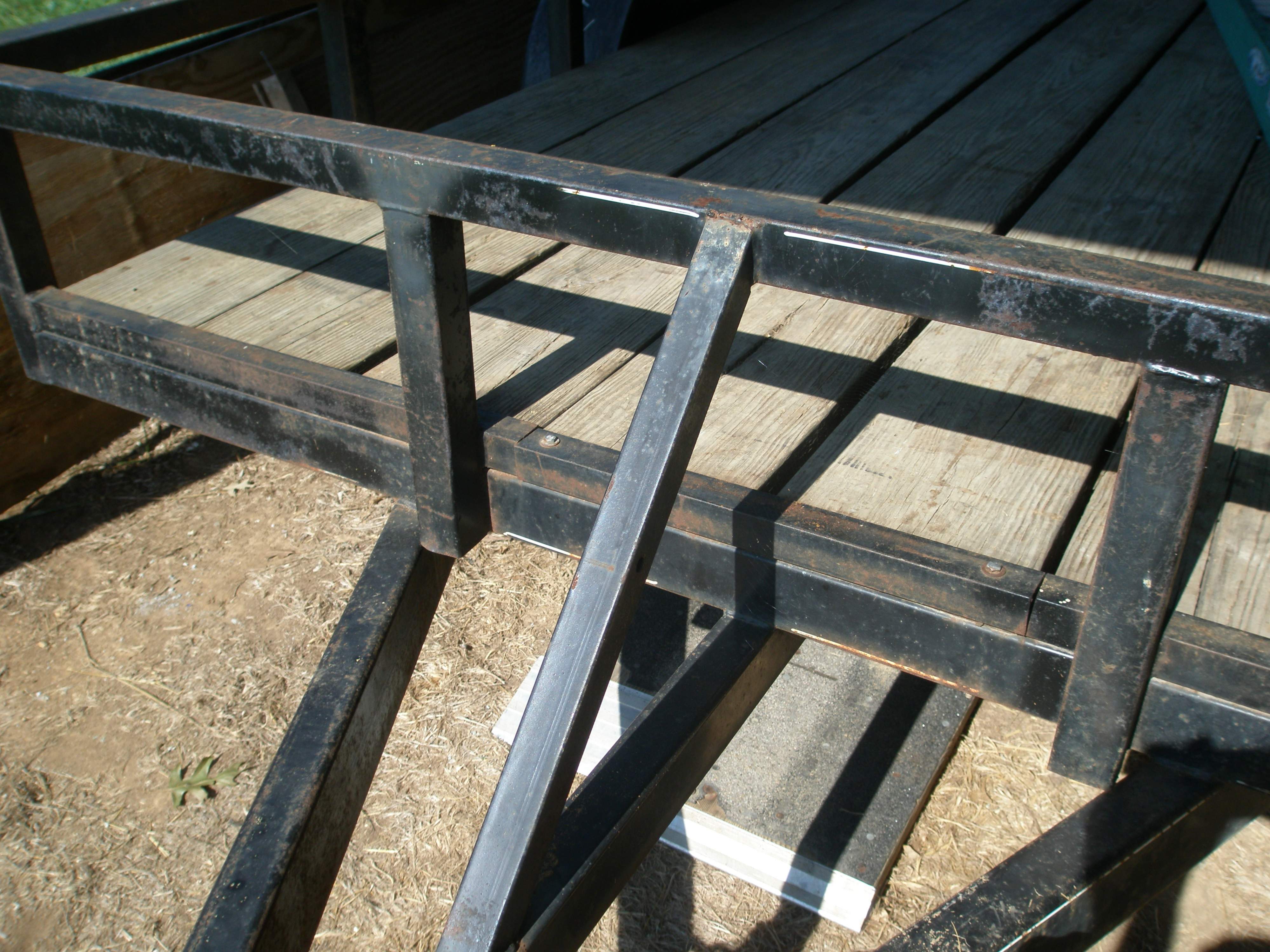

   / new board trailer floor #9
I took a reciprocating saw with a metal cutting blade and cut out the front piece of angle that act as a retainer for the boards. Dropped the boards in, slide them into place, and bolted the angle back in place. The new boards were pressure treated and I now store my trailer under my shop lean-to so hopefully it will last much longer than the first untreated floor.
well got a new floor done, it took most of the day to do. but it does look better than it did new. 2 coatings of water seal one coat on the underside, prior to installing the planks and 2 coats on top. still some water seal left, so one more coat before winter gets here.
