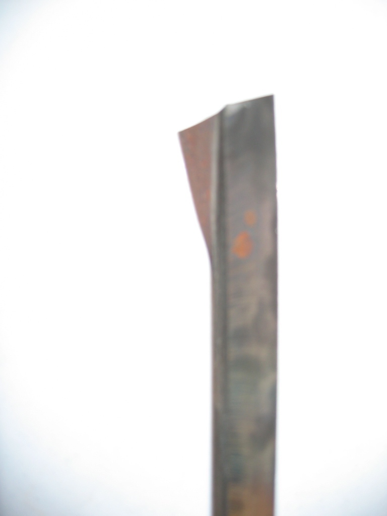

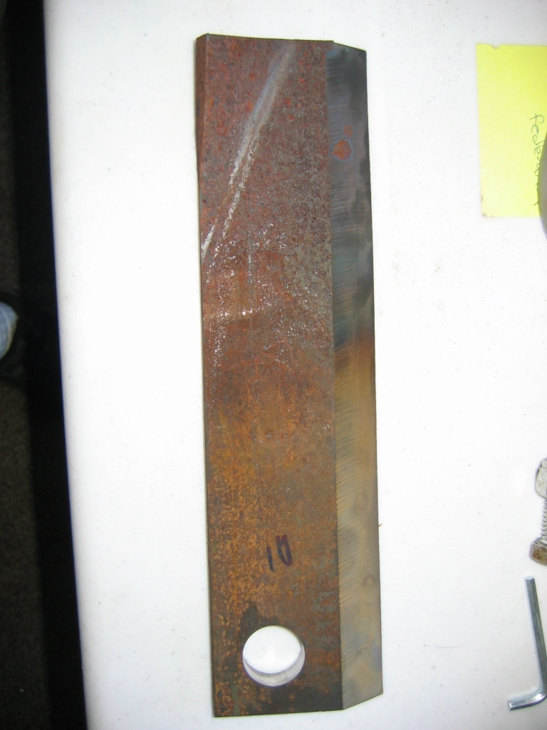

Here are a couple of pix... Amounted to $300 all in for new bushings, bolts and such. Now to install.... Oh, They are about a pound heavier than the original... Put them on the food scale (wife was not happy).

And for the follow up. There is a bit more vibration... But once at speed it is gone (and I am talking very little and I have not run the mower in a month).
The lift built in is a question mark. Clearly the tractor is throwing stuff up onto the top of the deck. Wether it is lifting the grass and stuff is a question
But the big news is that I hit a tire. With a rim. Made some noise, did not ding the blades. So far so good....
Carl
/ New blades for 1850
And finally... First thing is that these blades do create lift. And so much dust you cannot believe it. I am choking on my tractor where lat week I did not notice a thing... Second, they do swing heavier, thus cutting stuff up a lot better. But, I think because of the lift on the steel, I have now had two sizeable limbs get jammed under the blade and mower deck. Smoked my belt pretty good. The ear muffs I wear really cut down the noise. Not sure if I like that or not. Thinking about re-mufflering the Deutz. Or sending the exhaust note to the back... Not sure how much that would quite it down...
Vibration is more noticeable as I said before.... But the CUT I had a while ago with the 4' brush hog shook like a baby at a nanny convention...
Also, I need to install the bumpers everyone talks about. With the flare at the ends they get jammed in pretty quick
Finally, I think the blades have swung completely around. After 4 hours of mowing brush, I looked under the deck and a couple of the bolts had started to back out. I don't really want to use loctite on them. Any thoughts?
Anyway. All in all I would say it is a better deal than the blades from PT. $300 is a tough nut to swallow, it would have been $160 or so from PT with shipping. But, these things are really really tough.
Carl

Is there such a thing as too much lift?
Carl. Yes there is such a thing as to much lift. While it does make the grass stand up to be cut, it also will suck the dirt right out of the ground. I used to ride the 33 in Snappers a while back. and with the bolt on lifts, it would suck the dirt out of the ground. It did a very good job of sucking up leaves, beer cans, pine cones, pine needles, etc. With that said, if I had known that you were going to add a permanent lift, I would have suggested the bolt on lifts like on the 33 in Snappers. You could bolt them on when needed and take them off for bush hogging. Zero lift blades are good for rough cutting. The centrifugal action, will sling the grass or whatever out from under. On a zero lift blade, you could have the backside sharpened also, so that you could reverse the blade when necessary. Did you say what kind of steel the blades were made from.

JJ - T1 steel. I am committed to the lift. Didn't think anything could survive being bolted to a blade. Also the blade are now 1/2" thick up from 3/8"

The most important thing is to buy longer grade 8 bolts. Then use two grade 8 washers to hold the blades. I've had them fly off before this, after the stock washers got worn....scary deal.
We go through too many blades, but we also mow some rough places, so I expect it. I wish I could find some cheaper repalcements.
For finish mowing, you need lift, all of my finish mowers have high lifts on them. But the PT deck isn't baffled, so although lift blades will help, it may never perform like a finish cut mower.
A though would be to get a 72" 3 PT hitch pto mower; then remove the gear box and fit on a hydraulic motor, and mount an adaptor plate to it, and use it with the PT.

Bill... Thanks for all the tips. Yeah, I tried for a couple of weeks to find a blade solution. These 1/2" blades are really nasty on the rought stuff.
Good info on the washers. I upgraded the bolts but didn' think about upgrading the washers. Back to Fastenall this week...
