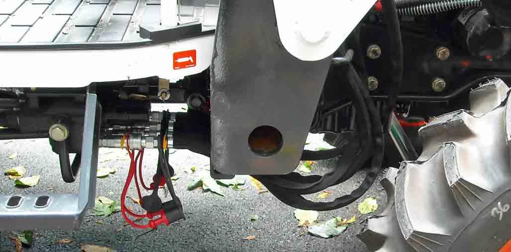

Is Woods now making a subframe for the CT2xxs? The loader is different
from the Kioti loader, so I don't think you can use the Woods subframe for
the CK30/35. Without modification anyway.
If you can buy a subframe, you will want to lower your hoe before attaching
it. Just rest the bkt on the ground and put 2 of your small wooden blocks
side-by-side under the main frame. I see you already have the boom
lock hooked up, so it will not fall over and squish anything.

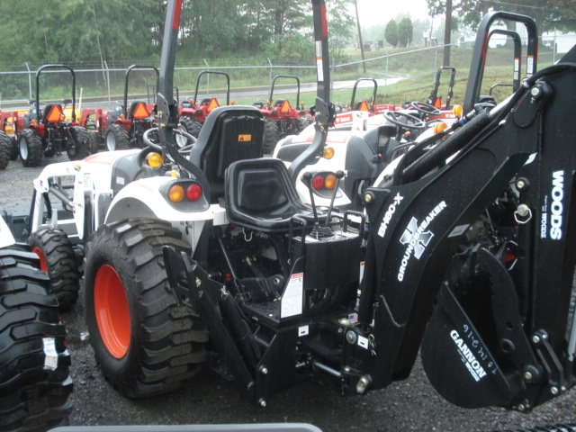

Woods does not make a frame specifically for ANY BC's but I just ordered a BH-80X and have been told the subframe for a Kioti will work at least for the CT2xx's.
I hope that is the case.
I remember several weeks ago when I started a thread on a BH that Wallace mentioned he thought it would work also and they were getting ready to try to put one on in few weeks. Maybe he will chime in and tell us if it works.
I know I would be interested in knowing how it turned out so I will know how hard it is going to be to get the subframe to match up with my 230.

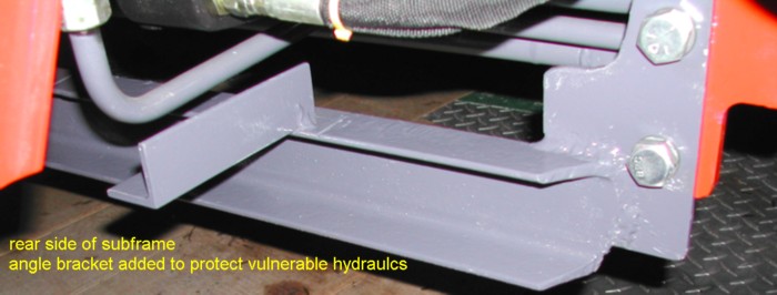

The Kioti's FEL is much narrower than the Bobcat FEL, which changes the
forward mounts for a hoe subframe. I used the handy FEL subframe "ears"
for my CK's forward hoe subframe mount, but my hoe subframe is
custom. Woods probably uses these mounts, too. Bobcat has no such
ears on their FEL subframe.
WALLACE: Nice photo. Did you use the Kioti subframe from Woods?
Modifications?
   / New BH7500... to me. #8
It was a direct fit with the Kioti/Woods subframe!:thumbsup:
   / New BH7500... to me. #9
Just curios as to why Woods does not list it as a Kioti/Bobcat subframe
   / New BH7500... to me. #10
That is a good looking tractor Wallace. Mine should look exacly like that if I can ever get this guy to send the hoe to me! The price was good but so far I am unimpressed with the service. It took over three weeks to get the thumb from Woods and they were supposed to put it on Friday. Still no word on a ship date yet. I had my Dodge truck special ordered new in 2005 and had it in less than three weeks!
I wondered the same thing so I asked that question to a Woods tech on one of my several calls to them asking questions (because the salesman I was buying mine from favorite answer was "you should call Wood's tech support, they will know more than I do") and both guys I talked to almost sounded mad when I told them I was putting it on a Bobcat. Both of them said we do not make a subframe for BC and we can not say whether or not the Kioti subframe will work. When I asked when they would start making them for BC they both said due to their resources, there are no plans to engineer a subframe for BC. When I mentioned that I was told by a couple of different people that the Kioti subframe would work their response was "well someone has taken it upon themselves to modify a Kioti bracket then". Really, they have to know it works or at least have looked into it. I would think it could only help their sales if they would just add Bobcat to the Kioti subframe!
