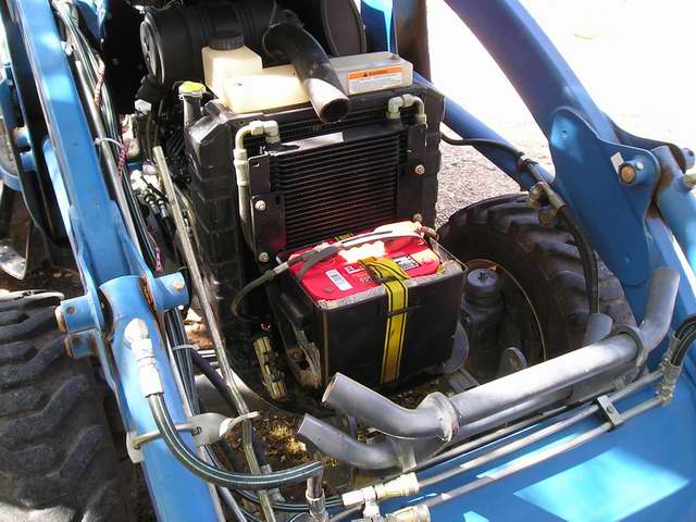

I replaced the factory battery in my TC45D about 2-1/2 years ago. I chose an Optima red top. It has been flawless since I installed it. I had installed a battery box to keep the acid from the OEM battery in check, so I just dropped in the Optima and put a piece of padding around it to help hold it in place during rough operation. Here's a picture.

jinman,
Is that hydraulic oil cooler in your photo the stock unit? No hose clamps, or the soft rubber hoses that like to leak? Jealousy rears it's ugly head.
