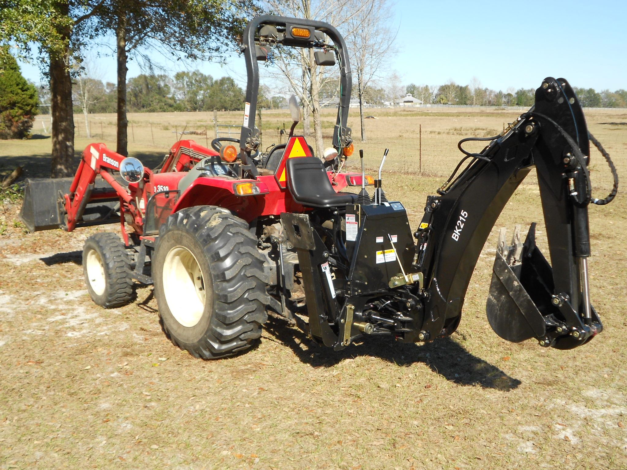

I bought the bh250 last week with 13" bucket and gen 4 [short] plumbing kit.. should get it Friday or next week..I,ll post some pics.There are no specs other than dealer input from dealers selling just a few. Locking legs, upgraded mount, heavy duty bucket are a few changes from the Bh860 I,m told.

My BH200 doesn't really have any "steps". There is a little ledge that I can shimmy up, though. As for the specs., The BH200 is almost completely identical to the BH76. I posted a pic of the specs a week or so ago. I have about 9 hours on my tractor now, but only about 1 on the BH. The rest has been clearing brush with the FEL.
