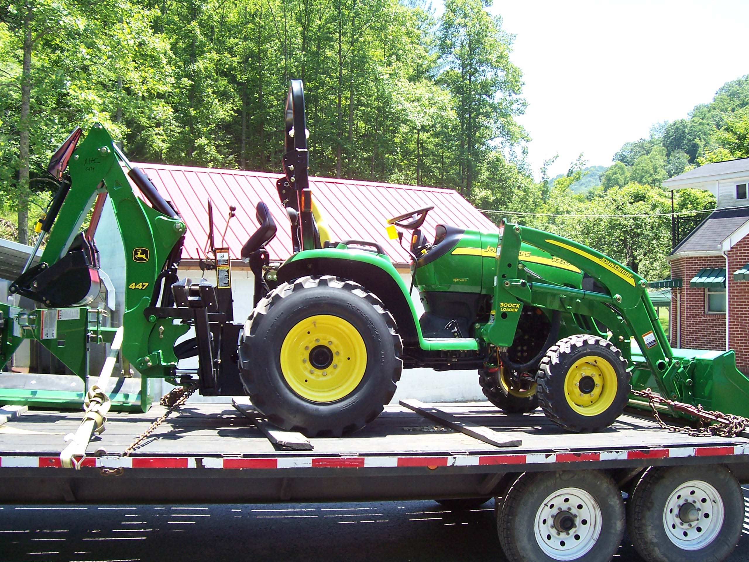

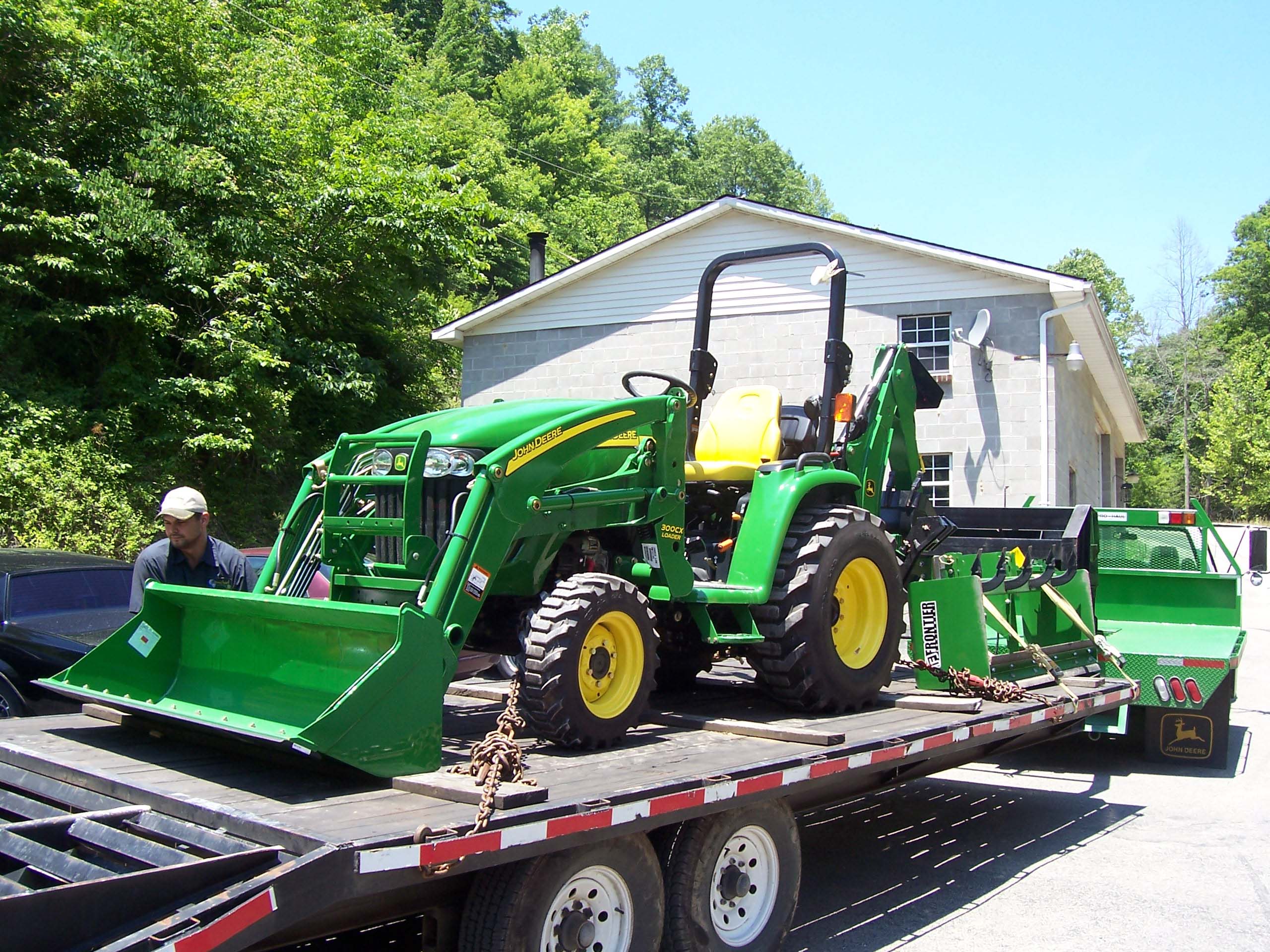

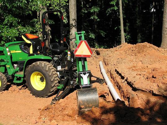

Delivered today...Now, if I can just make myself get it dirty!!!
