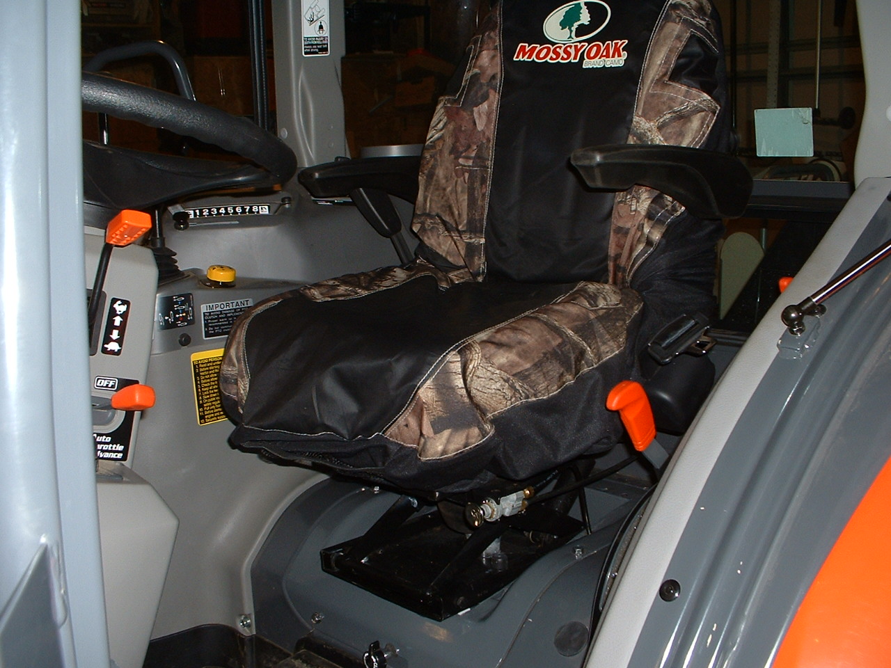

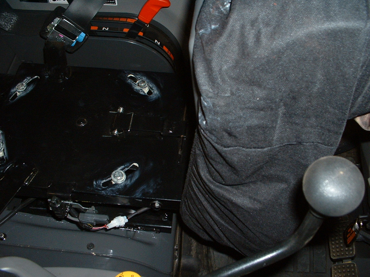

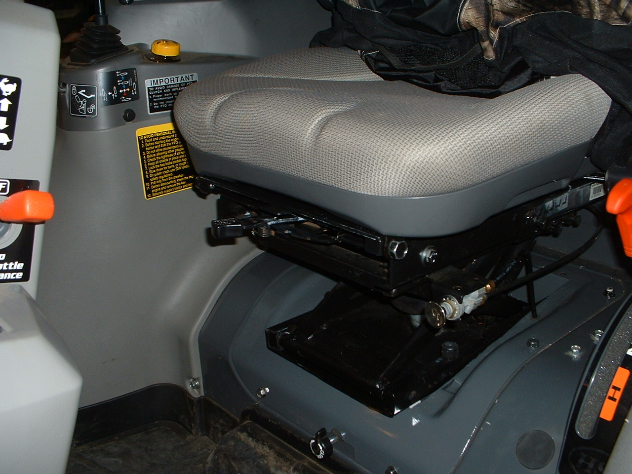

I finally got around to getting my new air ride conversion done. I followed 4SHORTS example of cutting the seat pan and welding in filler panels to level the pan. I had a Bostrom 910 air ride seat I had purchased years ago that I bought and used in a GMC Top Kick company vehicle. It had terrible seats and if I wanted something better for my back I purchased it myself. Truck is long gone but since I bought the seat I kept it and put original back in. Back to topic, I adapted the original Kubota seat to the pedestal of the Bostrom air ride complete with the swivel part. This also allowed me to keep the factory seat safety switches in place. BIL had a 2 gallon air tank he gave me that I cleaned up and mounted under step which I can fill when needed. Air system is leak free and 2 gal of air will run the seat for a long time. Temperature will affect the pressure more than seat will use. Tractor is always used at home so I can fill it from shop compressor easily. Here are some pics of the install. Thanks to 4SHORTS for posting his pics and giving me the idea to do this to mine. I had everything laying around to do this and all it cost me was a little mig wire and paint
Competed seat installed
Kubota swivel base adapted to Bostrom pedestal
Exterior Air Tank

Now that's just plain cool. Nice install and even a better price! Looks great and I bet your back with love you for it. Thanks for the credit as well. Much appreciated :thumbsup:
   / New Air Ride seat installed for under $20.00 #3
pizzaguy,
Awesome install! And I REALLY like the price. :thumbsup:
Also, very nice "factory paintwork" on the modified seat pan, and air tank.
And yes, we all owe 4shorts a debt of gratitude. And this is one welding project of his that might just be simple enough for me to copy! LOL (And since it's under the seat, it's low visibility, which makes my welding look better). :laughing:
I've often wondered if a used air ride seat from a semi, or a straigtjob, could be used. Obviously, it can. Does anyone know if ANY air ride seat would work, or must we be on the lookout for particular brands?
Anyone got any ideas about where to find such seats, other than ebay? (I'd just like to avoid the $1,100. price tag of a new one, if possible).
Pizzaguy, what would you estimate the weight of the seat and seat base to be? Just wondering how difficult the "wrestling phase" of the install will be.
Thanks, and congrats on saving $1,080. dollars on your air ride install!
