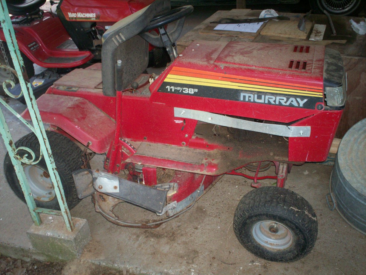

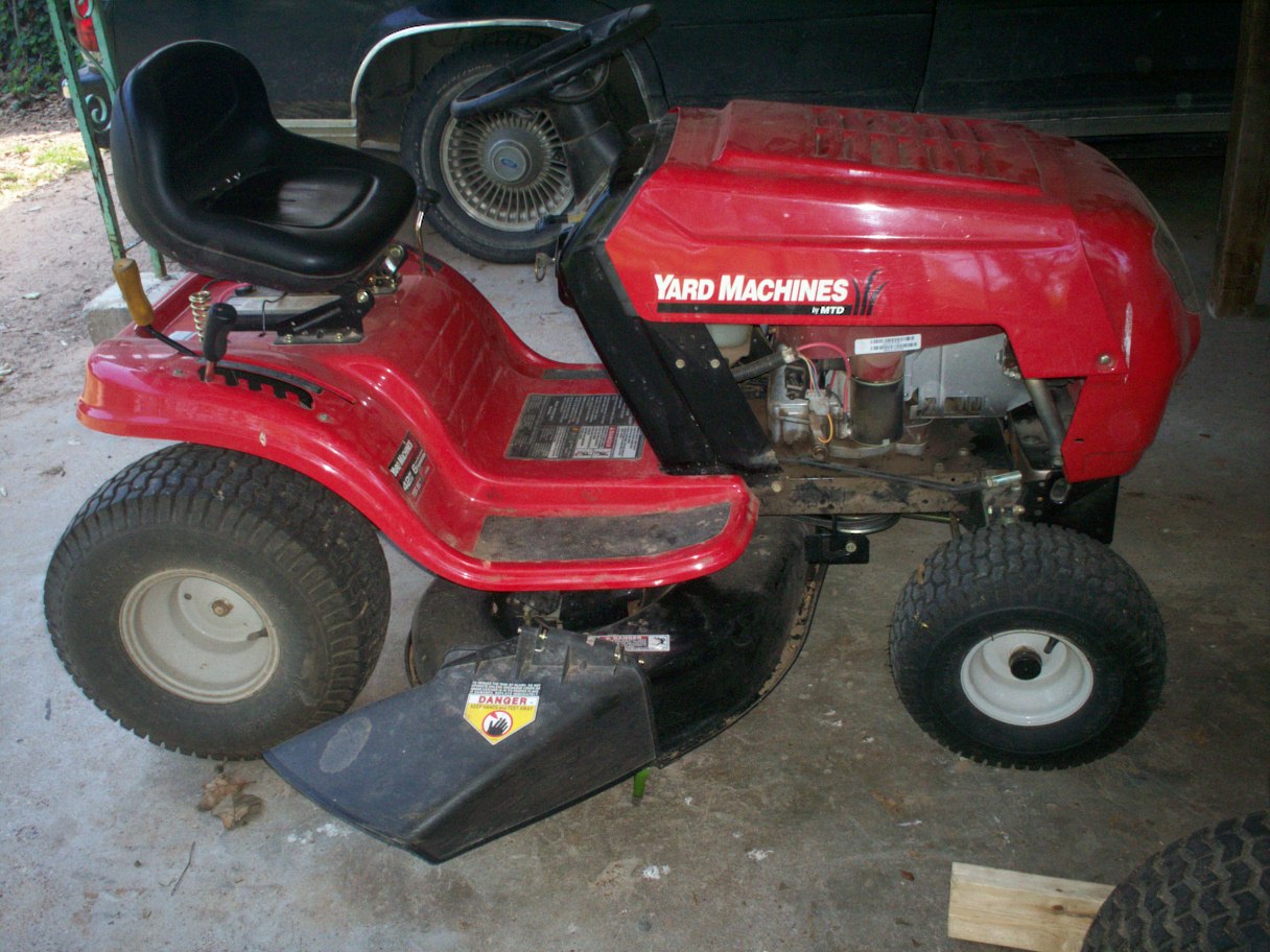

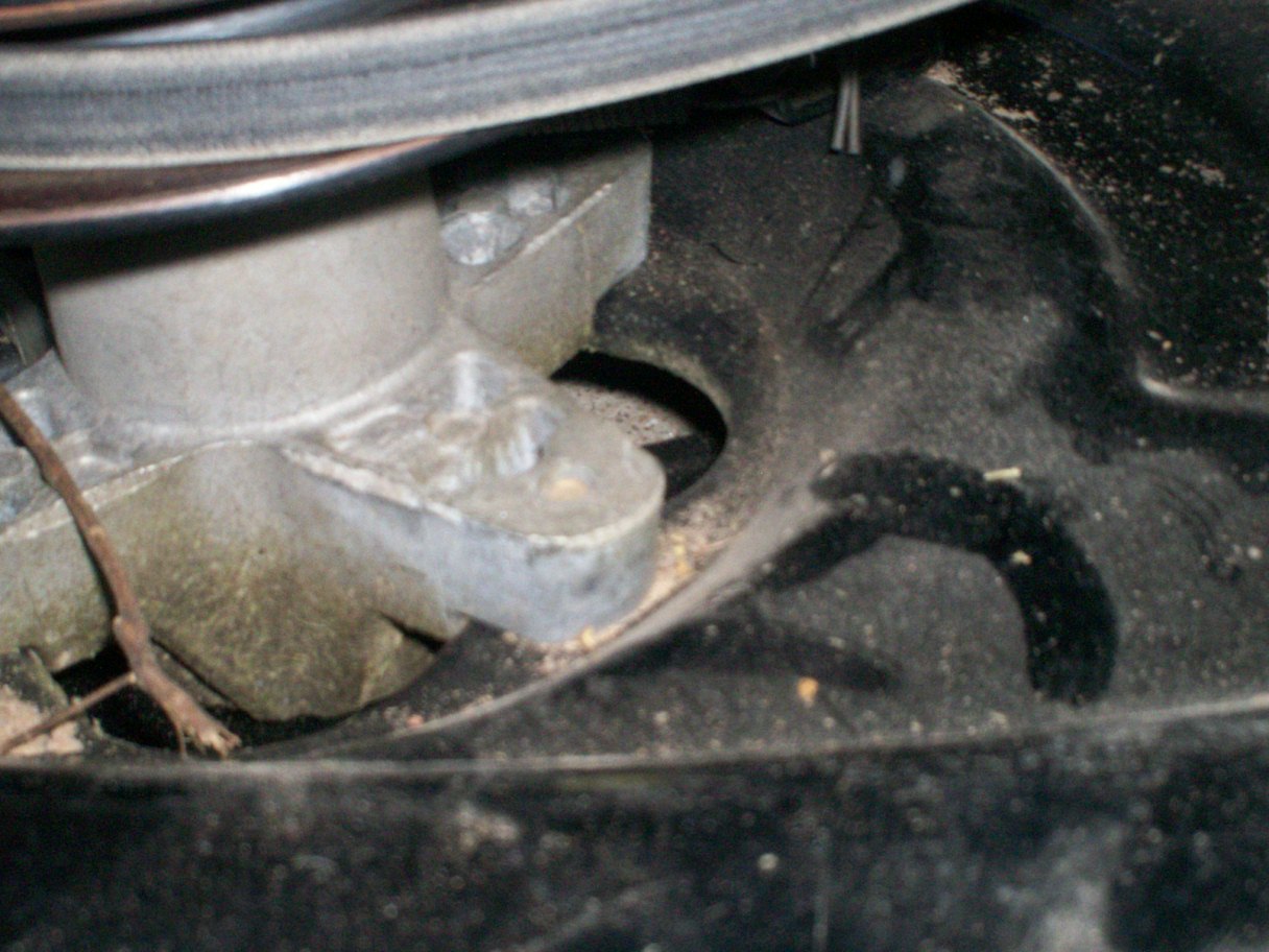

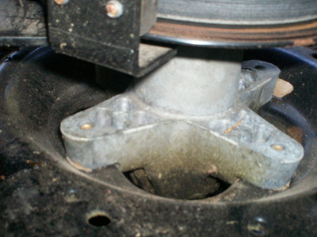

Fordlords, you nailed this one. It was the brake dragging on the blade pulley. I went back out there today to check closer, took the belt loose, and the blade spins free, no noise. My fil was trying to spin the blade by hand. Thanks for pointing me in the right direction. Here is pic of spindle assembly. I am not impressed. I think the deck will crack and fall apart before too long.
Pic 3,4, are of spindle area. Pic 1 is old mower that new one replaced (threw a rod after about 10 yrs), pic 2 is new mower
That's why the best bet is to buy the garden tractor version of whatever manufacturer you like best. Generally, the tractor itself and matching components are built far better.
