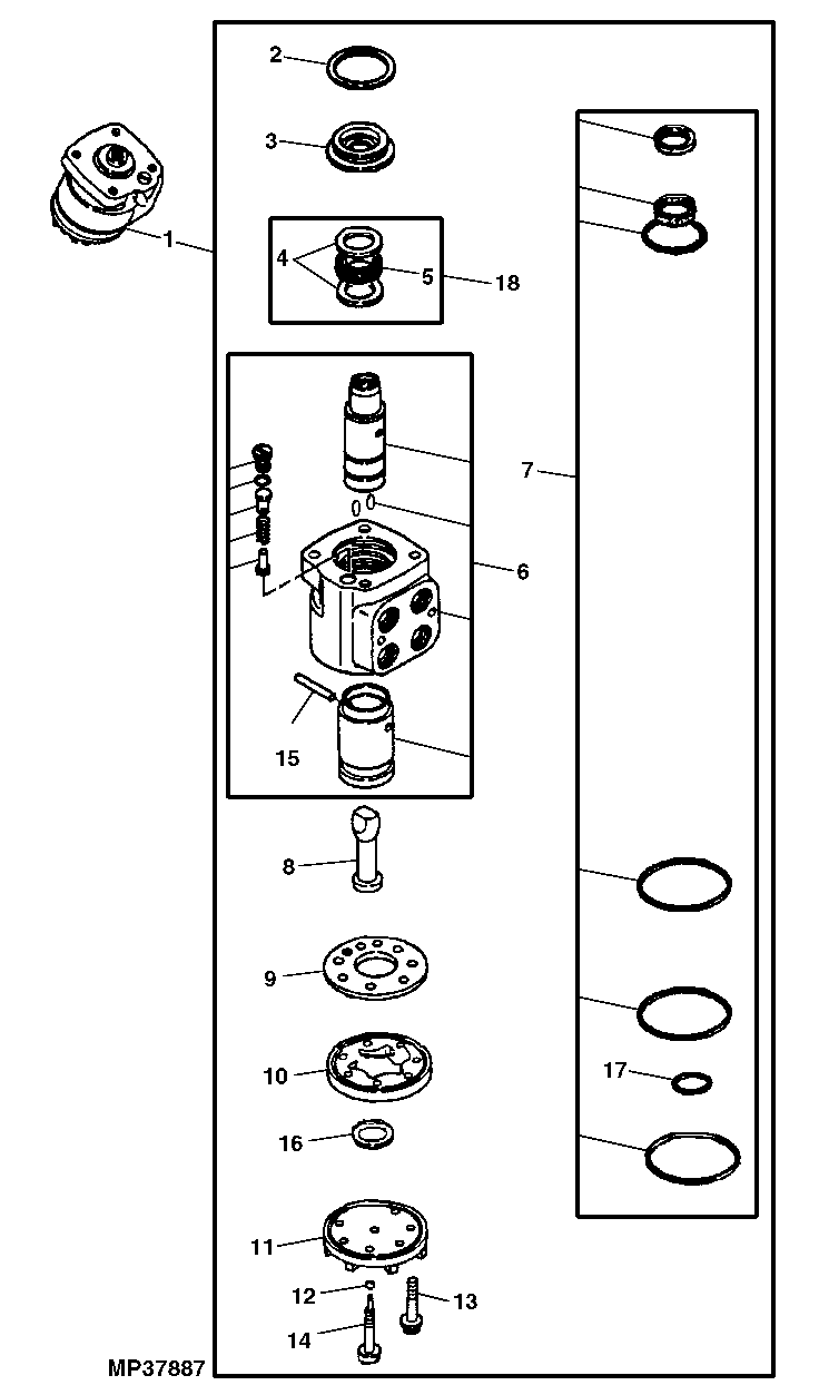

I bought a 870 4x4 with hydraulic steering. Has about 1200hrs on it. Cranks and runs fine but it will puke oil out the blow-by-blow tube ever so often. Not sure why this would be or what I need to start looking at. I will try to post a video. It has the common problem with the fuel and temp gauges not working. And finally the steering is slow to react and when it does it seems like it turns all way. I mean I have to turn the wheel like 5 times before it starts to respond, then it just turns to full lock. New fluids and filters. Any help would be appreciated.

When I bought this tractor the injection pump had been taken off. They said it idled real high and would not idle down. They got it shut off and it would not crank after. So I reinstalled pump. The number 2 delivery valve was hanging. A light tap and got the valve to moving. Tractor fired right up, but when I gave it throttle it would just keep reving up. After running tractor and working everything it freed up. Called it good. So I went and mowed about 8 acres that was thick. Good hard days worth of work. After that is when this issue started. I have not checked the drains in head or the baffles in breather. My other question about the steering kinda confuses me. I'd think it should be more responsive and tight like.
   / New 870 owner, got some issues #6
Here's the parts schematic of the steering valve. One things for certain the steering valve isn't very cheap. AM876679 Valve - VALVE ASSEMBLY ADD 1,189.66 USD
