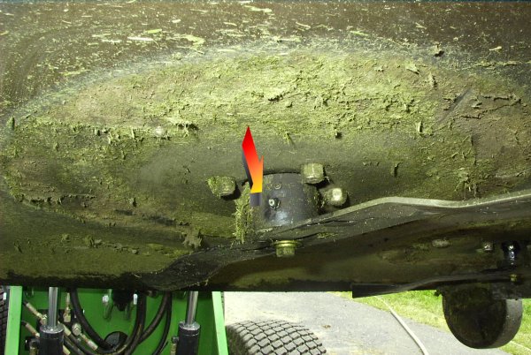

Speaking of the maintenance on the mower... I see a couple of zerks on the front wheels and one on the part that attaches to the quick attach plate (sorry, don't know the terminology)...
Are there any other areas I need to be aware of or any other maintenence issues. I really love my PT but the documentation comes a little too short for my liking. In this case there apparantly is none for the mower... /w3tcompact/icons/frown.gif

Chris:
If it is the same as my 72", and I bet it is, you also have a zerk at the base of each spindle bearing. I was advised by Power Trac to use high temperature grease in those. I bought synthetic at $10 a tube, which is probably unnecessary. There are blended high temp greases at any parts store.
I grease between uses, even when reasonably short. I can't see the bottom of the bearings, so don't know when they're full. I give them an arbitrary 20 pulls on a pistol grip gun. On yours, you can probably pick up the deck and see where grease is coming out above the blades, right Hans, David, other 4xx users?
Mine has zerks on the kingpins of the front wheels and on the hubs of all four wheels. The rear ones are nearly impossible to grease unless the mower is at its highest setting. I recall someone saying that the rear wheels on the 60" deck have sealed bearings, but my recollection is often faulty.

The only grease zerks that I can find on my 60" mower are the one on the center pivot for the qucik attach and the one on each front wheel. I took off the cover for the belt and cannot find them anywhere on the spindles. I'll call Power Trac tomorrow to check with them. Believe it or not, I only have about 7 hours of mowing time on it. It only takes me about a half an hour at the most to mow my yard /w3tcompact/icons/smile.gif
/ New 60" mower #10
Re: New 60
Talked to Terry at Power Trac today. The mystery spindle grease zerks on the 60" mower are on the UNDERSIDE of the deck. Ther is one on each spindle. You have to lift the deck up to get to them. He said we need to use high speed marine grease for these bearings only. The wheel bearings and pivot bearing on the quick attach use regular grease, just like the joints on the main tractor. He also said they need to be greased every 8 hours of operation.

I use AMSOIL Synthetic Multi-Purpose Grease, NLGI #2, GC/LB. I grease the mower every three hours (i.e. before each use) and it takes about 12 pumps in each spindle! That’s a lot of grease. At first, because I don’t use “high speed” grease, I was concerned the bearings may be getting hot and the grease was leaking out. However, after mowing, I raised the deck and the bearings were completely cool. I have no idea where the grease is going.

Here's a picture of the greas zerk on one of the spindles of the 60" mower.

Thanks, I was going to grease tomorrow, so this picture will come in handy
