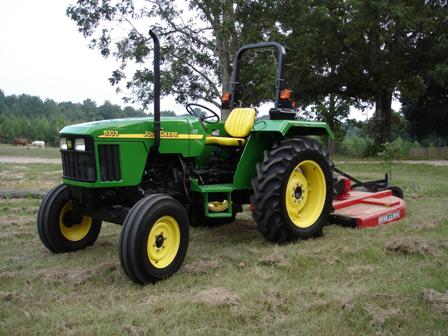

Finally able to post pics....took me a while. I've had the tractor about 3 months now but these were taken 30 minutes after it was delivered. /forums/images/graemlins/grin.gif

Congrats - nice lookin tractor. I really like those tough fenders on the 03 series. They seem to much more durable than the plastic ones - easy to bold a toolbox on too.

Very nice!! I sat on these at the dealership when I was looking at my 3320. Quite a different tractor all around. The 3320 seemed very much toyish compare to the 5103 to me. The 5103 seemed more agriculture based vs hobby farm usage of a 3320. It was quite a bit larger as well.
No HST though correct?
   / new 5103
No, it is gear drive only. Looks a little "old timey", thats what sold me. /forums/images/graemlins/grin.gif

Nice tractor....good choice! It'll last you a lifetime, and then some.
