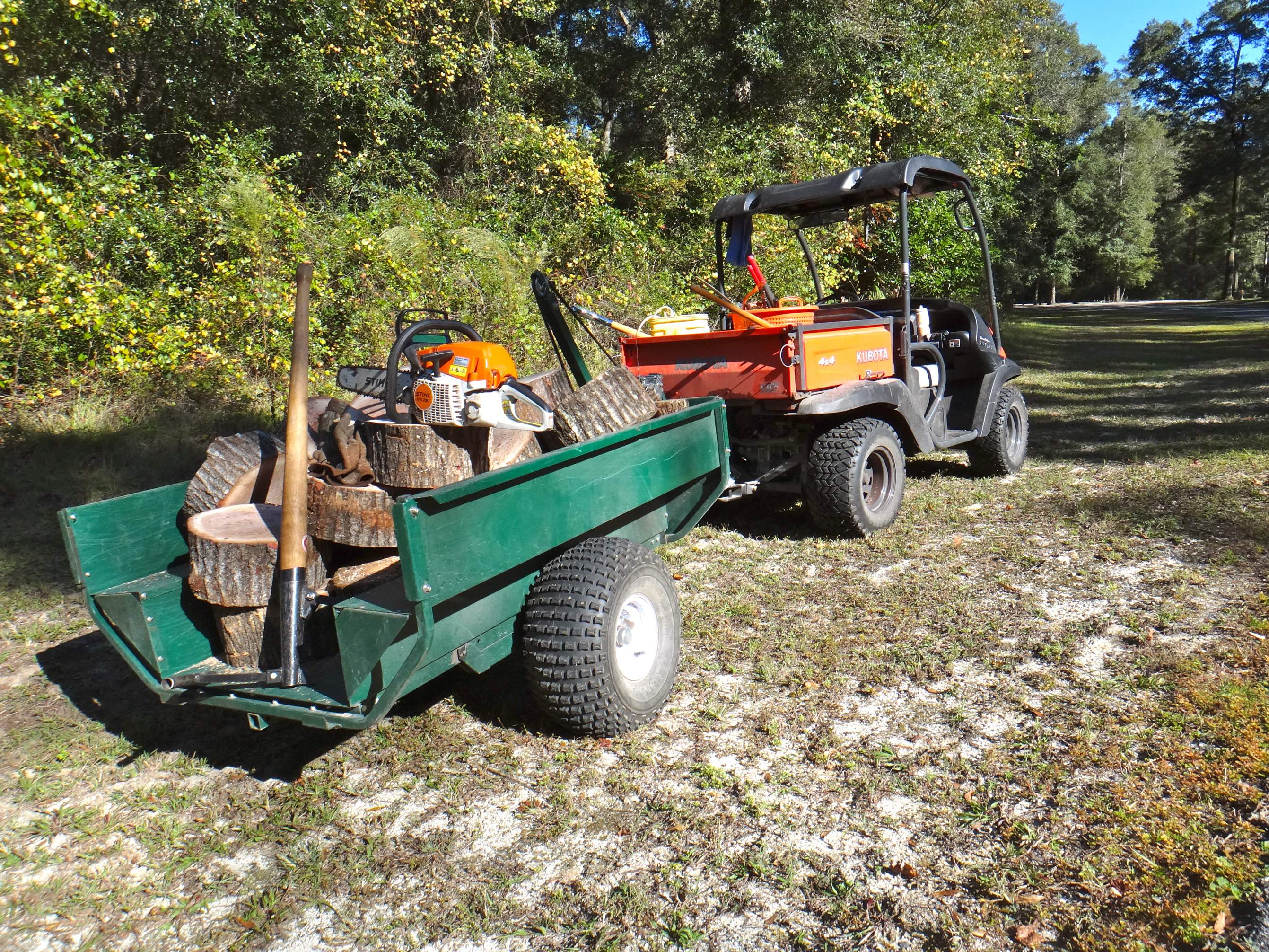

Before long you will want a Utility Vehicle and a dumping trailer.

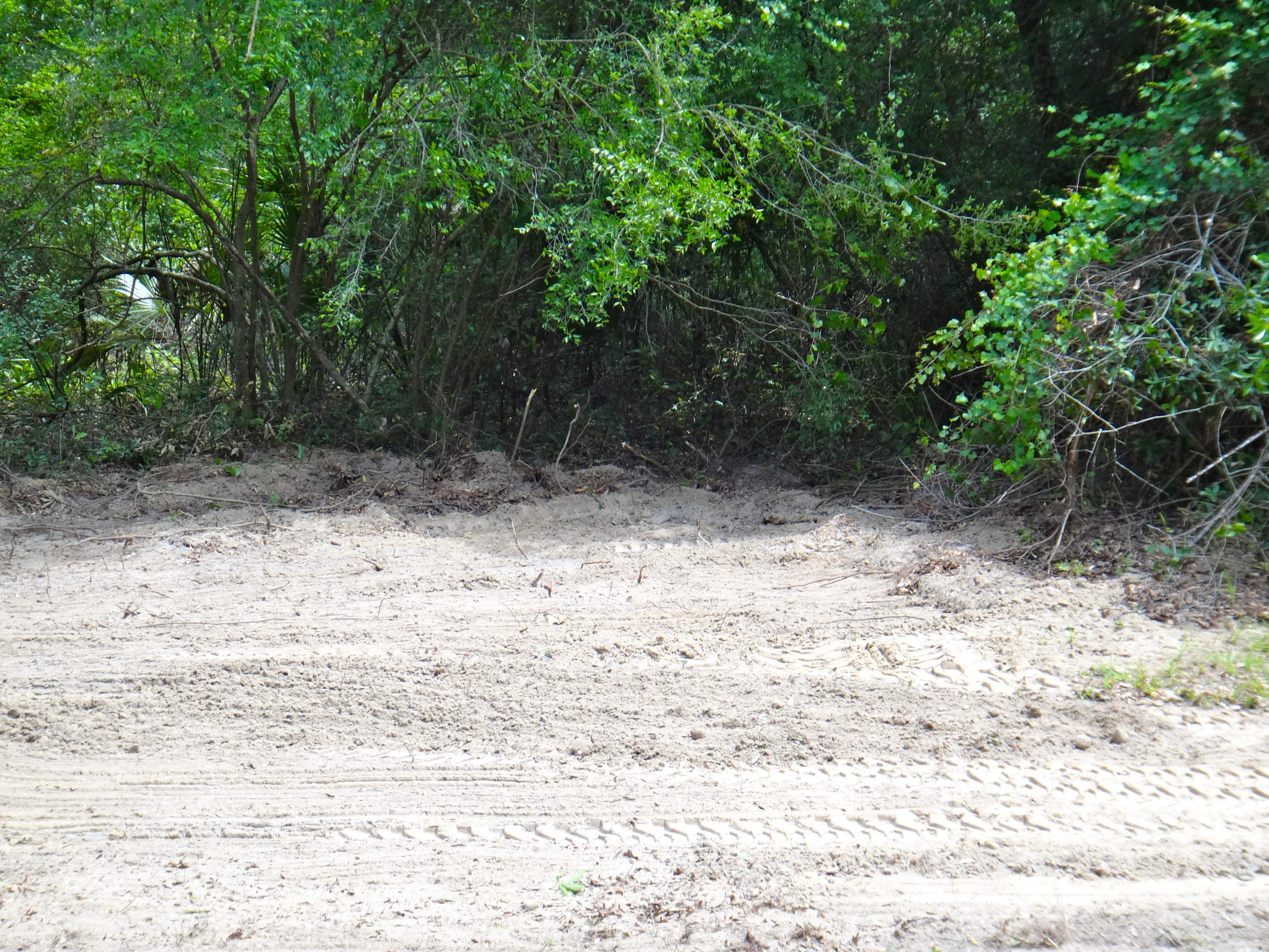

FINALLY, SOMEONE WHO BOUGHT ENOUGH TRACTOR IN THE BEGINING​

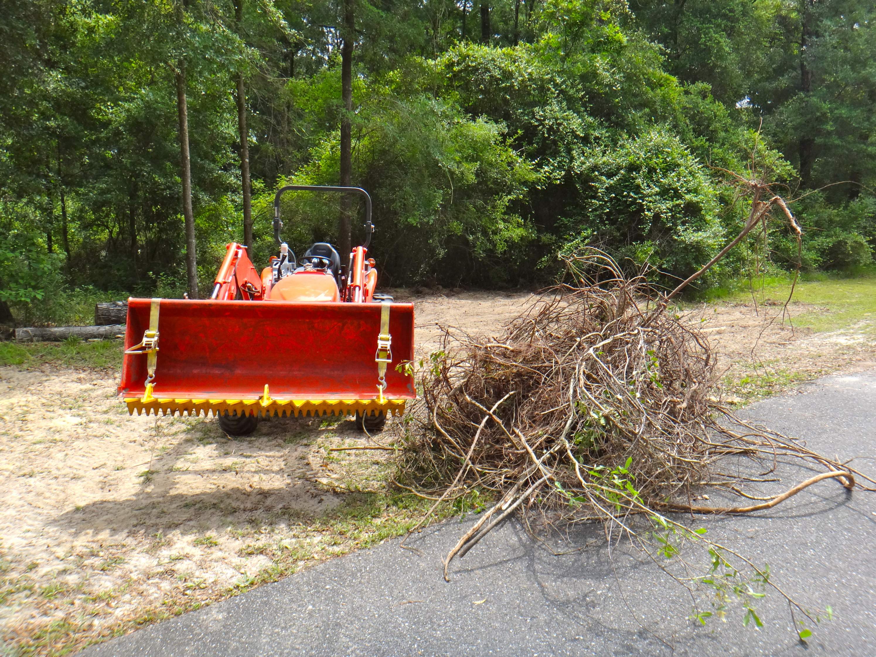

I commend a $400 Ratchet Rake bucket attachment to you. Available through the T-B-N store with convenient UPS delivery.
That ratchet rake is pretty cool. I was planning on using the teeth of the grapple for the raking function. Is there something the ratchet rake is better at that than the grapple?
FINALLY, SOMEONE WHO BOUGHT ENOUGH TRACTOR IN THE BEGINNING[/CENTER].
Wouldn't have it any other way. :thumbsup:
