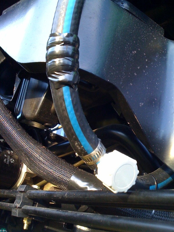

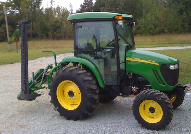

Just registered tonight. Took delivery on new 4520 with cab a few days ago. I noticed that where the heater hoses (black with blue strip, I'm guessing heater) go up into the cab, they cross a large metal bracket that holds the cab. This happens on each side on the front of the cab. With just 6 hours, these hoses have small (.01" or so ) cuts from the sharp bracket. I put spiral wrap and 1.5" electrical tape on them so there will be no more damage.
I've enjoyed reading all the posts here, look forward to more, and wanted to share this 1st feedback so that other cab owners could check their rigs for similar problems.
Thanks again to all who post, getting educated is a wonderful thing. When I have pix I'll post them.

I've got 6 42# weights for the front. I had the weights from the 318 tractor where I have a bracket on the back and use them when working with snow (not a common event down here). It's odd- the ballasting number for the MX6 is a code 82. In the 4520 manual, it would take 10 70# weights to meet that. Yet you see the MX6 on these things with no weights all the time. So I'll see how it behaves and then decide if I have to get a weight bracket and 70# weights. This is the exact sort of information exchange I'm looking for here. Knowing it works OK with 6 will help if it's a bit squirrelly with the 42# weights.
They all look nice when they are new, but add some dirt, a few scratches and some wear and tear and then you know you appreciate them.
The sickle bar broke after 2.5 hours of use. It popped in 4" of grass, so it has to be an infant failure or initial assembly error. I greased it and check all the bolts at 2 hours, they were fine. It popped yesterday, dealer is picking it up today, can't complain about that. These things happen...

jenkinsph: Here's a pix of the hose and my fix on the right side of the tractor.

eepete, thanks for posting the pic makes it faster to find.
