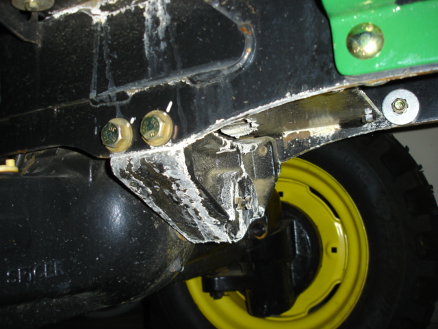

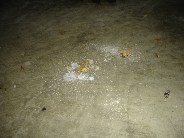

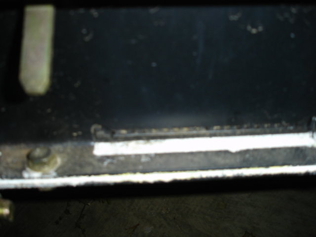

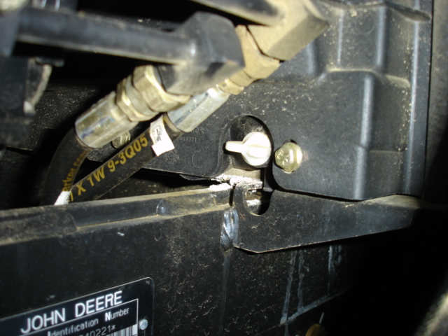

Today I noticed white powdery stains on the floor under my new 4520 with only 18 hours. Closer observation I noticed this white powder leakage under the radiator and also covering the battery tray. The model of JD battery is a LVA12925. Is this an ongoing problem with JD batteries? I've tried a search and did not notice any current issues with the batteries. Look at the pics. Does this not look like battery corrosion? I didn't notice any corrosion on the terminals but it did look like some of the acid had overflowed from the top. I'm contacting the dealer in the morning. If it is in fact a defective battery and the dealer replaces it shouldn't the affected area be neutralized and repainted?

It sure looks like battery corrosion although the lack of corrosion on top of battery makes me think the battery case must be cracked or damaged somewhere. I would be pulling the battery out and check it over carefully. If it is still in warranty, the dealer should clean and paint all damaged surfaces and replace the battery.

I haven't been successful in finding the messages here on TBN but I thought that it was a problem. I can tell you that the dealer replaced the battery at my 4320's 50 hour service, without my complaining about it, so there might be a recall.
