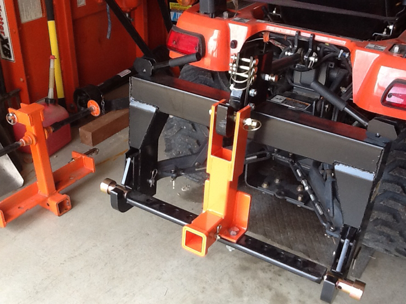

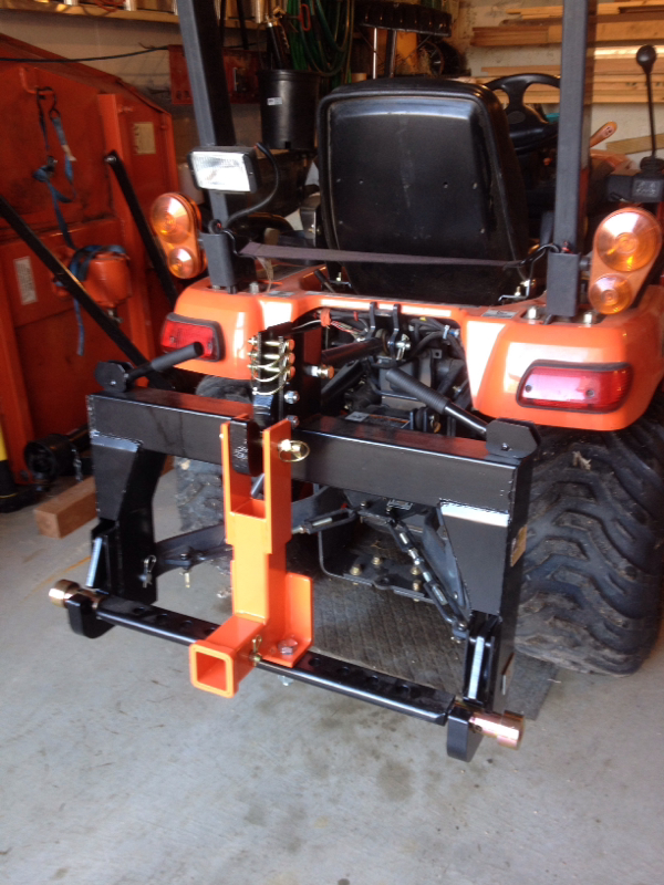

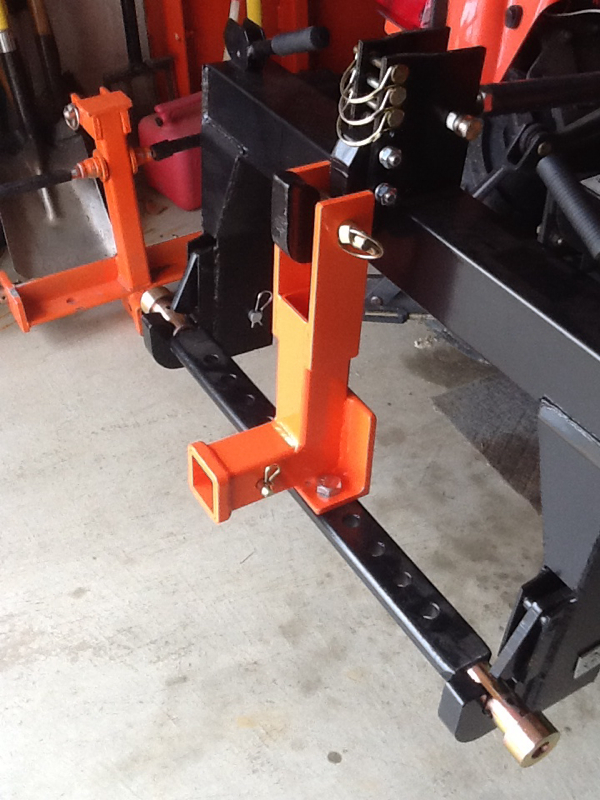

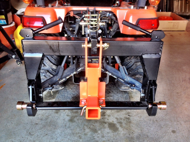

Got my new 3pt quick hitch from Norther Tool and a draw bar receiver from Omni all put together. I needed to get extended length pins for my King Kutter box scraper and rotary cutter. I also added Speeco quick hitch pins on to reduce the slop when attached.

I already had the Omni hitch for my bx, but when I got a quick hitch, I already had a drawbar and would've needed to figure out how to make it fit the new hitch. Instead I just bought something new from Omni to fit the quick hitch and bolt to my drawbar
