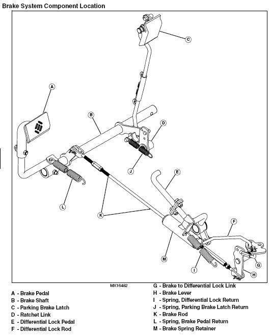

I just moved up from a JD GX345 to a 2210 and absolutely love it, but I seem to be having a problem with the releasing of the brake lock. Engaging the brake lock works fine, but when trying to disengage it, the only way I can get it to work is by pushing down the release mechanism and then pressing the brake firmly. There's a popping noise when the brake releases. When I try releasing the brake by pushing down on the brake pedal first, it won't release. Has anyone else had this problem? Also, does anyone know if there's something that I can adjust myself or should I schedule for the dealer to come out to take a look at it? Thanks for any help that you can provide.

Congrats on your purchase. /forums/images/graemlins/cool.gif As for the brake, it sounds like an adjustment of the linkage is in order. It might be worth a call to your dealer -- he may be able to describe it over the phone -- but then again on a new machine, perhaps you would be more comfortable if they did the adjustment. Let us know how you make out.

I have noticed on my 2210 I do have to push hard on the brake pedal to release the latch. It does sound like an adjustment. I have attached a picture of the linkage but not sure what you would adjust.

DJLX, thanks for the schematic. After viewing it, you're not the only one who is unsure of what needs adjusting. /forums/images/graemlins/crazy.gif I've called the dealer and am waiting for them to get back to me. When I try releasing the brake, I'm pushing the pedal all of the way down and it just won't release. When I press the release mechanism first and then the brake pedal, it works everytime. At least I have a temporary work-around until the dealer calls back.

<font color="green">"Unlocking Park Brake:
1. Press down completely on brake pedal with foot.
2. Push park brake lock completely down to the unlocked position.
3. Remove foot from brake pedal. Pedal should now be released from the locked position. "
The above comes straight from the 2210 Operator's Manual.
The brake lock does not release automatically when you press down on the brake pedal as it does on some lawn and garden tractors.
