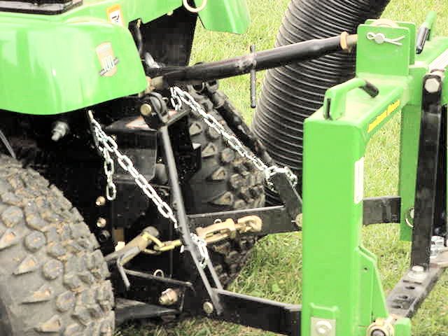

Well I just got a new 2210 on my birthday. I had the 54" MMM Rhino lined and finally have it adjusted and now find that the 3PH must be used to lift it. That is a problem to me as I use a box scraper along with a 72"MM scraper blade at the same time and am trying to figure out how to add another small cylinder to lift the MM scraper blade as well as how to add a positive stop to the 3PH to control the depth of the box scraper. Has anyone else ever added an indendependt lift for the MMM and if so where did you hook into the hydralucs.

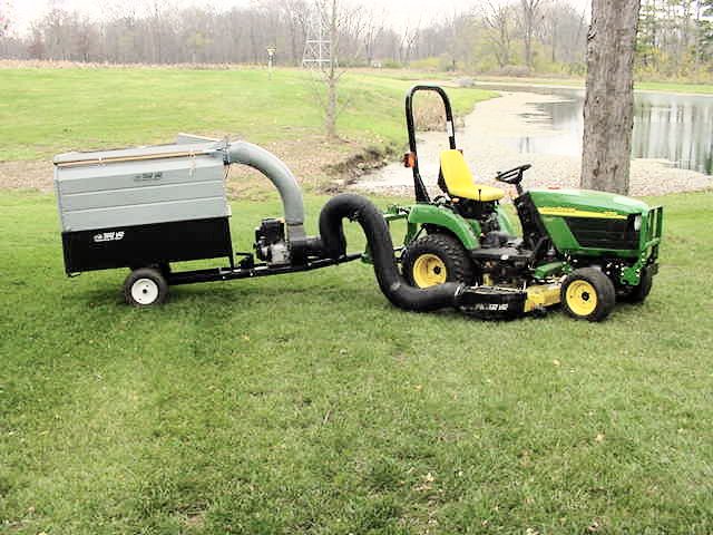

Last weekend when I hooked up the Trac Vac to my 2210 to pickup leaves. I discovered I needed stops for the 3 point hitch so I could keep the vac hitch high enough so it would not drag the ground. With some eye bolts, S hooks & chain, I made some stops that worked out very well. I will try to post some pictures in the next couple days.
I also have been thinking about installing a seperate lift cylinder for the MMM. I was going to do as beenthere said & use the loader control valve. That will be a winter job.

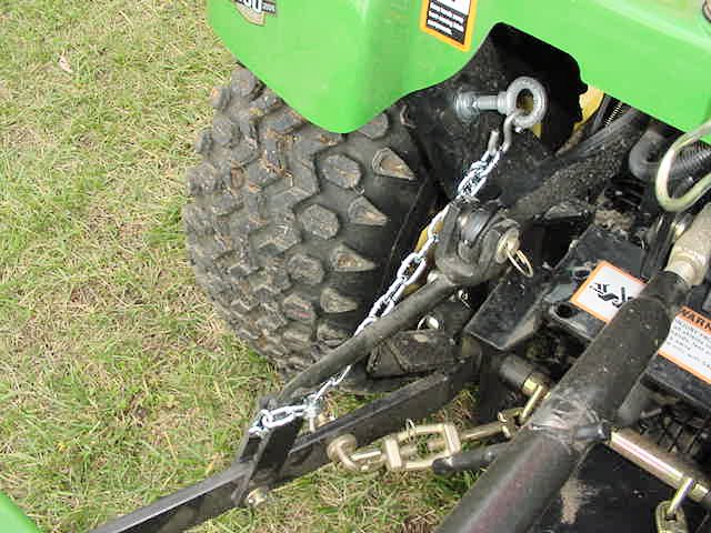

Denny,
I am attaching pictures of the chain stops I installed on my 2210. I used heavy duty 1/2" eye bolts & mounted them in the existing holes in the ROPS braces. I used 3/16" chain & 1/4" S hooks.

Another veiw.

2210 & Trac Vac.
