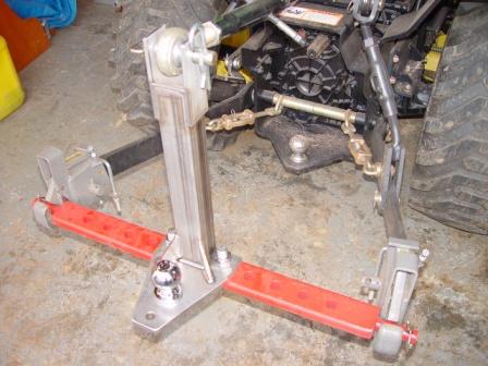

Sometimes I pull around my trailer with the 2210. The ball mounted on the rear tractor frame works but not great due to it's height. Here is my solution to the problem. I bought the draw bar from TSC for $20 something dollars and the ball from walmart for $7. The stainless was scrap(free) and the welding free.

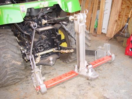

here's another from a different side

   / New 2210 attachment #4
AND it's much nicer than that stupid spacer bar required to operate the mid mount mower. /forums/images/graemlins/grin.gif
Yup! I hear ya and hopefully will have a solution for the MMM lift in the future. JD dropped the ball with the remote lift kit by plugging into the loader SCV. /forums/images/graemlins/frown.gif
   / New 2210 attachment #8
Hey DJLX, are those "Pat's Easy Change" on your lift arms? If so, how do like them?
#9
Well -it is definitely better than no Pats. I have left out the little set screws on the sides which allows some flexibility with the angle of the attachment spacing. My attachments have casters so it is pretty easy to move the attachment to the lift arms.
