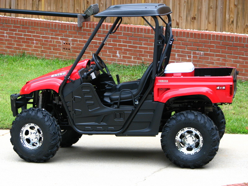

I traded up my 2005 Camo Rhino for a 2008 Rhino Midnight Armor. I waited to post until I had run 20 hours on the unit and had it serviced. The new Rhino has been perfect for the first 5 weeks.
Overall I have been very pleased with the new Rhino. Yamaha made a number of improvements some of them I knew about others were kind of surprises.
Pluses (over the 05)
* Fuel injection (starts, idles, and accelerates much better than the 05)
* Better handling (The 08 steers much easier than the 05. I did not see this listed anywhere but has been noticeable to all the drivers.)
* Quieter and less vibration.
* Fuel gauge and cup holders are nice to have. Fuel gauge is not quite linear and reads more empty than the amount gas left in the tank.
* Frame is stronger. We noticed this we we loaded it on the trailer.
* Better CV joint protection.
Minuses
* Runs a little warmer than the 05. It did cool down after break in but definitely runs warmer.
* Yamaha did not improve the headlights. I can overdrive these headlights easily.
My only additions are my ITP 14" Terra Cross tires and a WARN XT25 Winch.

i bought an 08 700 hunter green rhino . it's been fun to ride but if this thing is easier to drive than the previuos models man they must be rough. i do my best not to lock the front diferentials because when i do this thing just wants to go straight. i can see where a good power steering would come in handy on this thing. other than that it's nice starts real easy.

great looking rhino....my buddy has one and i been on the fence for a long time about getting one........tough as nails........he has flat out abused it.....keeps on going....
