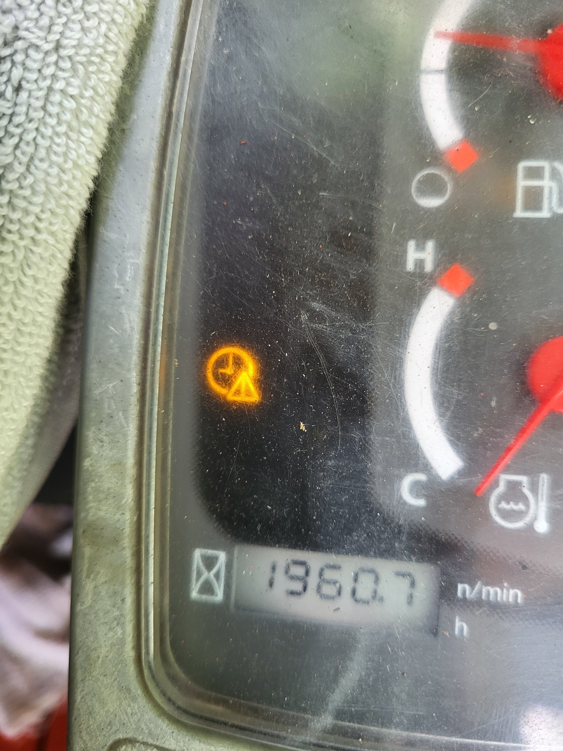

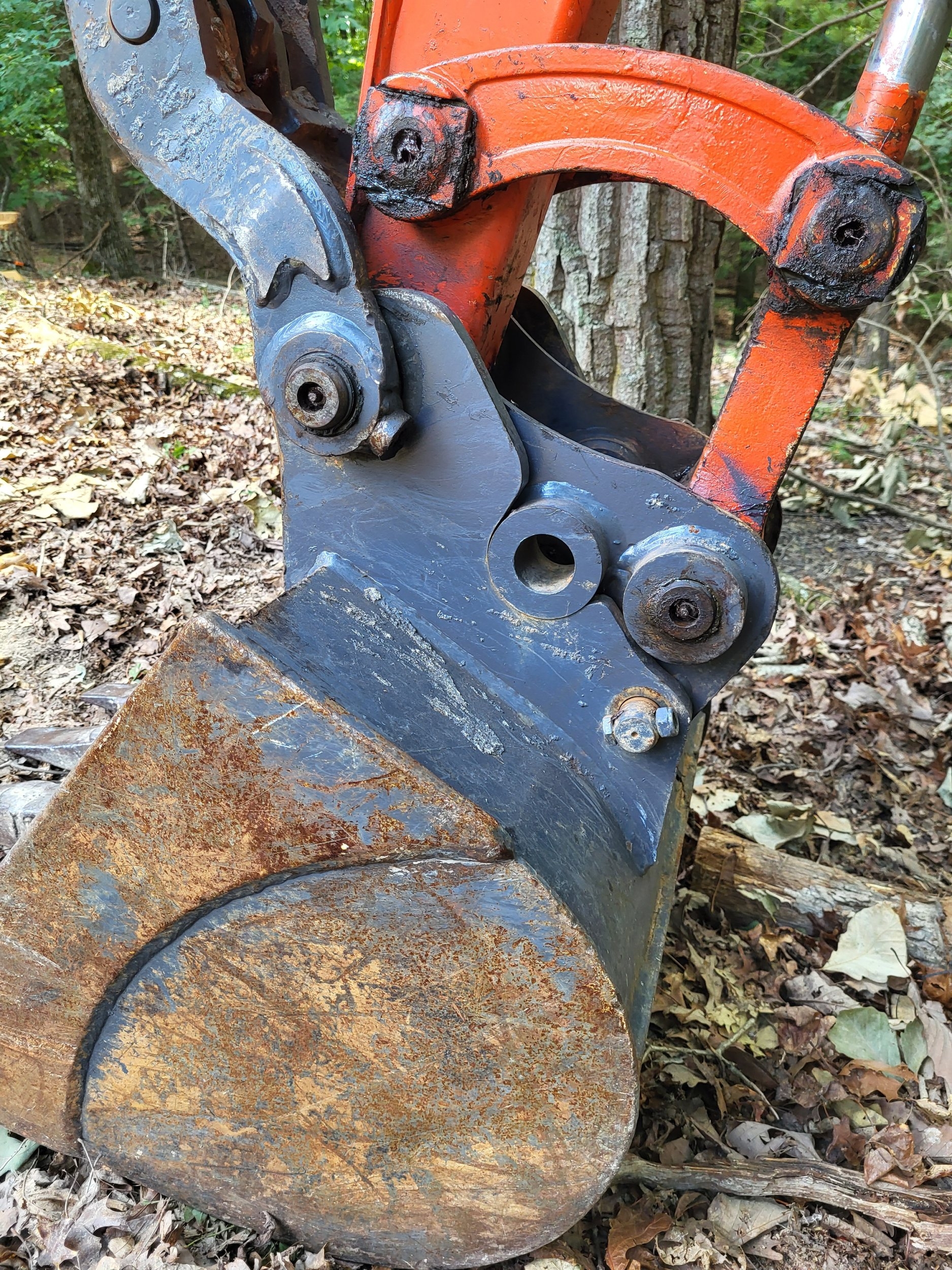

I have had it a week working through doing the next service, greasing, filling fluids etc. I have 2 questions. 1- I have a warning light that looks like a simple clock. A circle w/ hands set at 9 oclock and the typical warning triangle stabbing the clock at about 5 oclock. I have spent hours and can't find what it means. I thought maybe 'time for service' and found 2 different ways to reset a service reminder but neither works. Also my display is different than any I have seen in online manuals etc. 2- I have a quick attach bucket and want to get a narrower one. How do I determine if this is an official Kubota quick detach setup? Do I need to match dimensions when looking for a bucket or will anything advertised as fitting it actually fit? Thanks for any help you can give me.
   / New 2 me 2018 KX71-3 excavator #2
Life would be much easier and simpler if K would standardize their BH QA mounts
   / New 2 me 2018 KX71-3 excavator #3

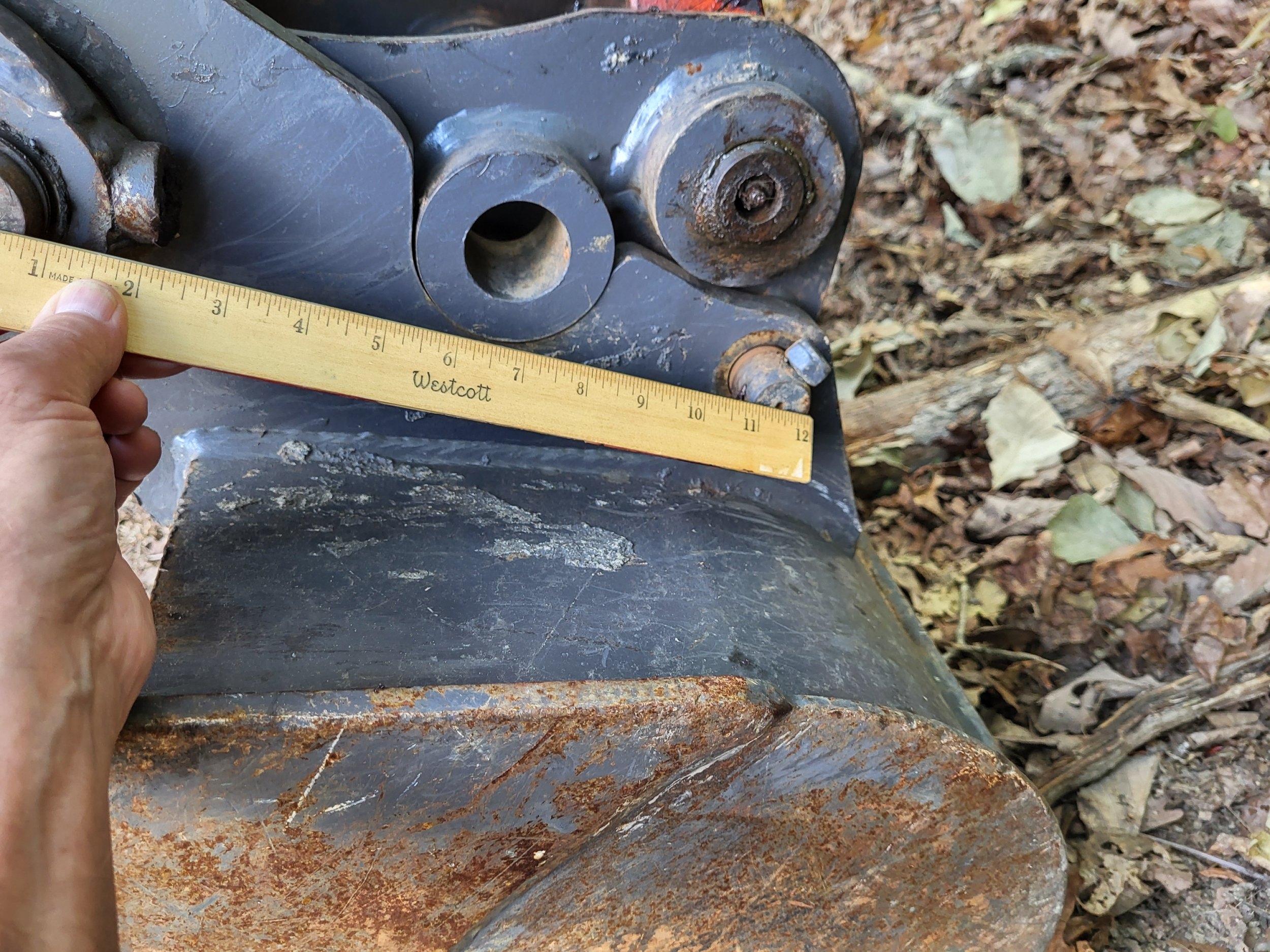

A couple pictures of the quick hitch with a measuring tape on it would help.
This indicator light is flashing and keeps flashing all the time the engine is running but I am not having a problem w/ any function that I can tell. The bucket dimension is 11.5" center to center.
Clock needs to be reset....
Oh man, I wasn't even aware there was a clock in the display. Raining now but first thing tomorrow.......Thank you Peter
