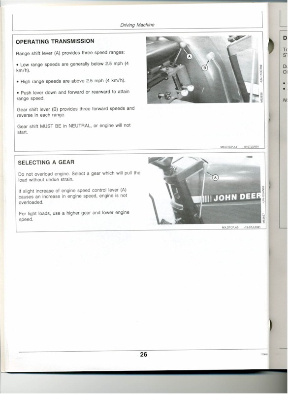

   / New 1070 Owner needs some help. #7
The 1070 operator manual, attached, provides zero help. Also have not yet found anything in either 1070 maintenance or parts manuals. Need a current 870/970/1070 operator here.

For my JD 870 I just push it forward to get to range #1. Push down and forward/reverse for #3 &#2. Have your gear shift in neutral when doing this.
Seeing the post about lifting to get into #1 will make me try that tomorrow just in case I should have been doing that all along! :eek:

Thanks Jeepin4fun that worked!:thumbsup: And thanks to all of you who responded. I appreciate the help. I'm sure I'll be back with more questions later.:confused:
