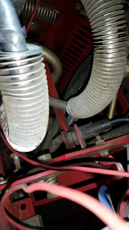

Anyone know where the neutral start switch is on the 4231? Looks like it should be around the left foot peg, but I don't see it. Having some intermittent neutral lockout starting problems. Thanks!
Bruce
   / Neutral start switch #2
On my 4231 it's between the dash and the radiator,behind the parking brake lever,just above the main hydraulic line with the coiled cooler in it.i took a picture,hope this helps

Thanks RD. Really appreciate the picture! I tried to follow the blue wire from the starter solenoid, but lost it in the bundle. The Ventrac part diagrams are not very helpful. Been starting the unit with a jumper wire from the solenoid to the 12 volt lug on the starter which works but is less than convenient.

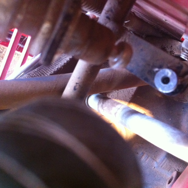

There is a tab on the Selector Lever Shaft that engages the switch - where that lever goes through the right side of the dash, mine wore the hole into an egg shape and that made the tab farther from the switch - The switch is adjustable (not the easiest to get to). The whole in the dash assembly needs a bearing surface for that lever rod.
Thanks BK. Rather than aggravate myself with the switch adjustment I super glued a couple of thin washers to the tab (picture attached). Maybe just a band aid, however it fixed the problem for now. Also the switch is easy to jumper if I choose. I noted the lever shaft wear on my unit also.

The B in BK is Bruce also. The wear I mentioned was on my 2004 4231 - I now have one of the last 4231 Gas, Liquid Cooled, Briggs/Daihatsu 3 cyl. that Ventrac assembled. Between the 2, I have over 1,500 hours - 900 & 600+ & that lever / switch causing a failure to start is one of the only headaches I have had.
The washers should work as long as they stick to the tab. :thumbsup:
