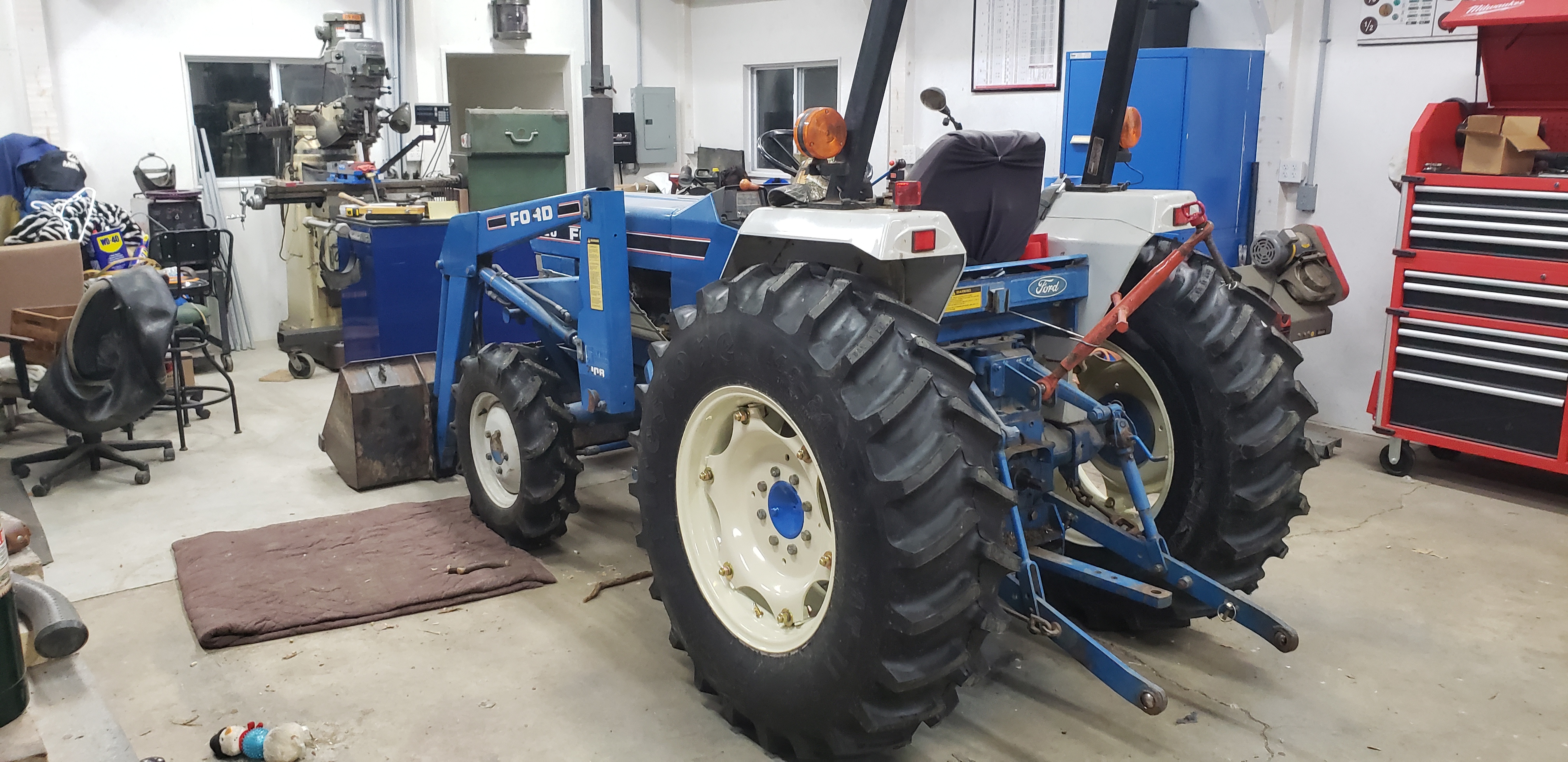

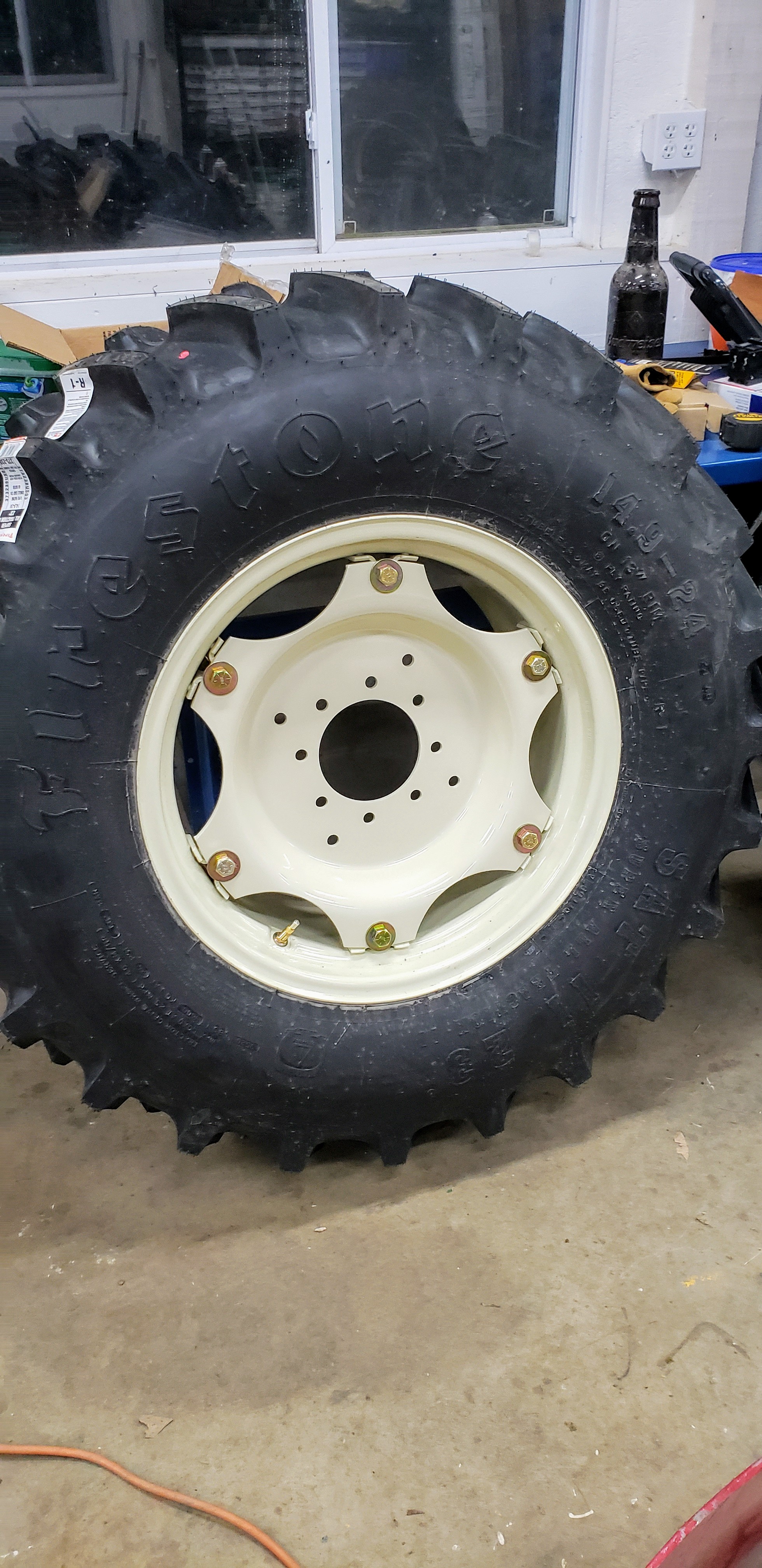

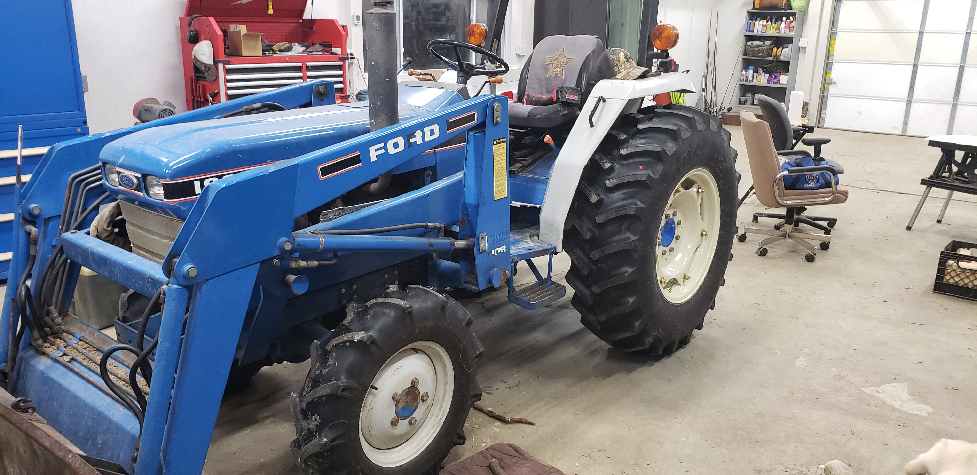

Well I finally got these on the tractor last night. The rims were not an exact match to the center plate bolt pattern and required the holes being slotted .090 outwards for the bolts to go thru correctly. The rims came powder coated IH white so I opted to paint the center plates to match since they needed painted anyways.
