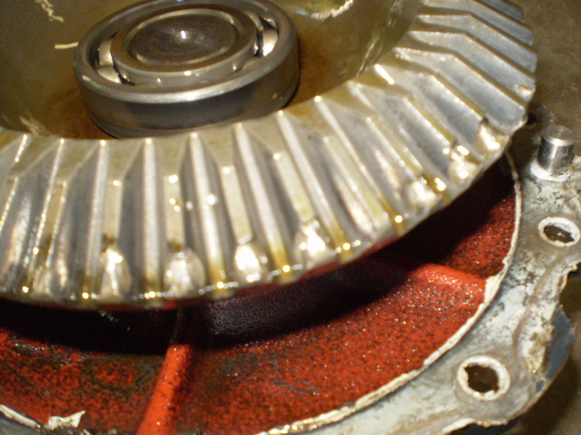

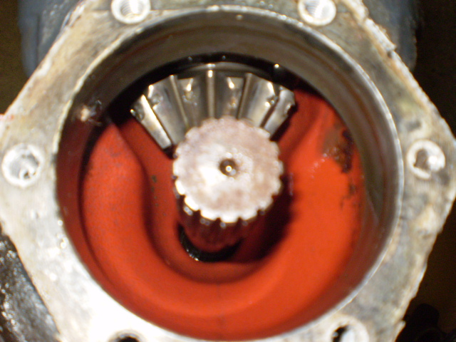

I,m needing gears & Brgs for the left front Hub & axle on My Isiki . Needing the large Hub gear, axle gear & lower spindle gear & all brgs for the left side .
The fender says 255 landleader but the tags have these numbers on them .
85050
TA250F
TL28F
UKWX
04552
The #,s on the gears I cant find but I think these are the #,s on the brgs .
KOYS 6207 axle gear brg
N&M 2202 Hub brg
NSK 6208 Top spindle brg
Also need the lower spidle brg but dont have a # yet .
Pics are the damaged gears needed . New , Used will consider anything , Thanks for any info or help .

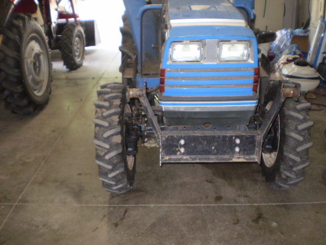

I thought I,d update this for anyone that might run into this type of problem down the road as I have had no luck locating any parts yet . Also my other tractor is down as well so I need my tractor back for mowing .
I decided to leave out the 2 lower spindle gears , as well as the axle gears & axles , That way the damaged hub gears can cause no further damage & it operates just fine in 2WD . This is the first job I,ve ever done that I intentially have parts left over :laughing:
Top right pic are the parts I left out , Bottom 2 pics are where I removed them from . This eliminates any gear meshing with damaged ones .
I hope this may come in handy for someone . I am still in nead of the parts listed & will restore it back to 4WD when I can find them . :D

These Gears look very repairable to me. I have Tig Welded similar Ring and Pinion gears on ATV's. I used a 312 Stainless Filler Rod that will machine down for a time before work hardening. You should have no trouble getting a shop in your area to fix these up.
Bummer but good luck.

Yeah, I'm sure there is not a good way to Machine these with a lathe or mill. I used a Die Grinder with Cutoff Wheels, Carbide Burrs and Files. You can get nearly an exact repair with these tools. If it's only 98% perfect, It will wear in to work fine. It will take some time but it can be done.
Good Luck.
