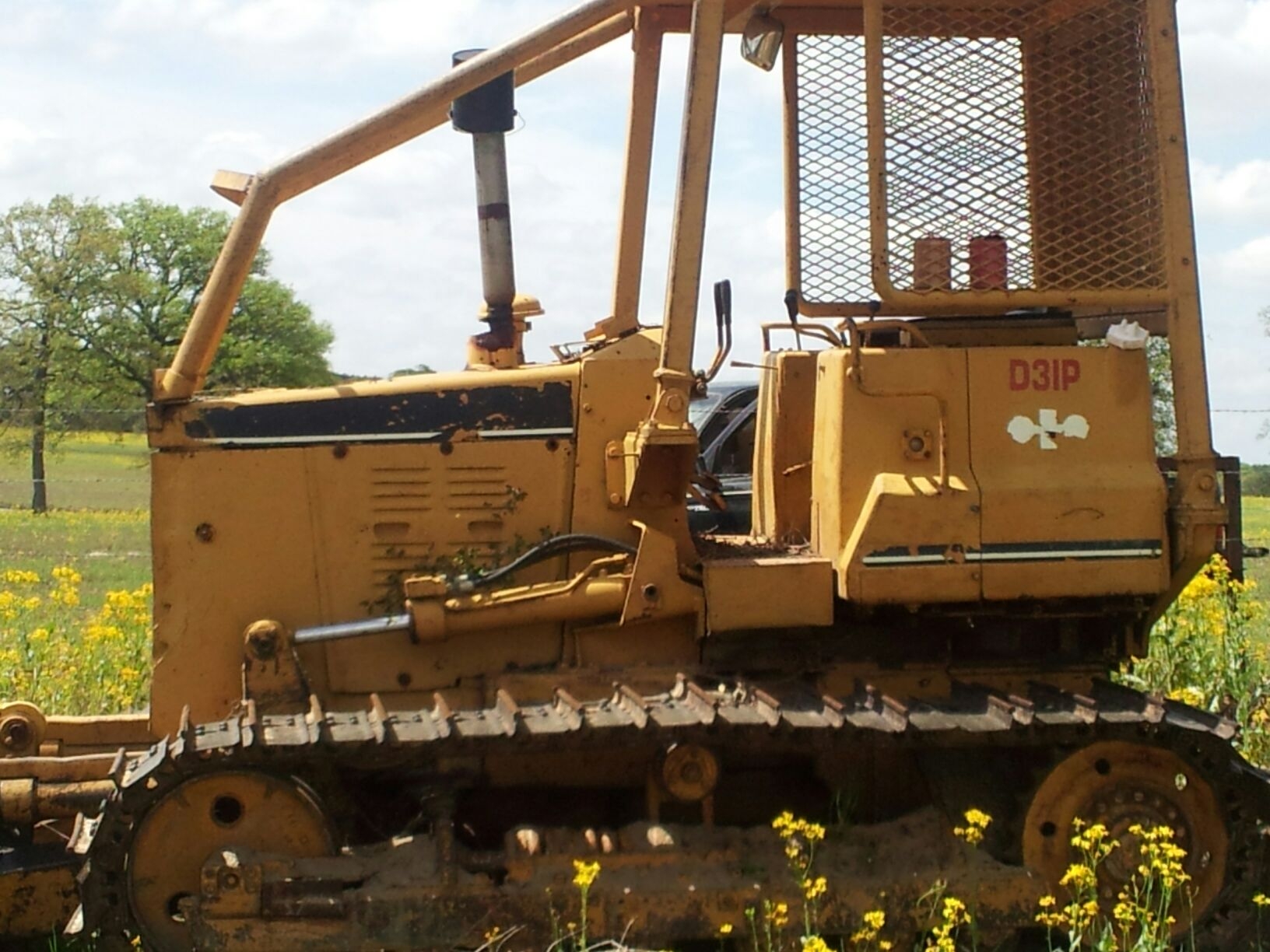

The Mahindra could probably get alittle more HP and alot more weight. Guessing going with 4x4 and loader grapple? All mentioned are good tractors but neither going to be new long cleaning up brush,sticks going places they shouldnt,etc. I bought a small dozer couple years back,its not the best but I only gave 6,500. Its had small issues along the way,i had to do some welding on such but has long since paid for itself and when I think got all the good,selling it for parts or scrap. It can do way more than I would put my tractor in. I higher the larger clearing out but tell them just rough it in,I will do the finish work. Maybe even get a mulcher machine come in,that just my two cents... d31p komatsu.JPG

Yes i would like to have a dozer myself but finding one for that price is extremely rare, thats not a bad looking dozer you have for the price. Most older used d3 or d4s are running around 20k. And ive looked at skid steers over a tractor for reason being i could get a shredder, and more that a tractor could do but the price difference is outragous!! And GmanBart i have seen the LS but i havnt looked into them because first thought i figured they were a cheap tractor for i havent heard of them before, but you say they are a pull off of new holland?
