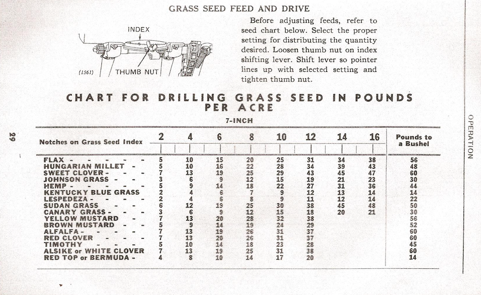

DUH I now understand GRASS seed chart! I'll try again. You should be able to order a chart from your friendly JD dealer. M16634 Chart - CHART SEED 7 INCH ADD 23.29 USD
   / NEEDED: Grass Seed Box Chart for John Deere Van Brunt FB-A Grain Drill #7
Here you go.
