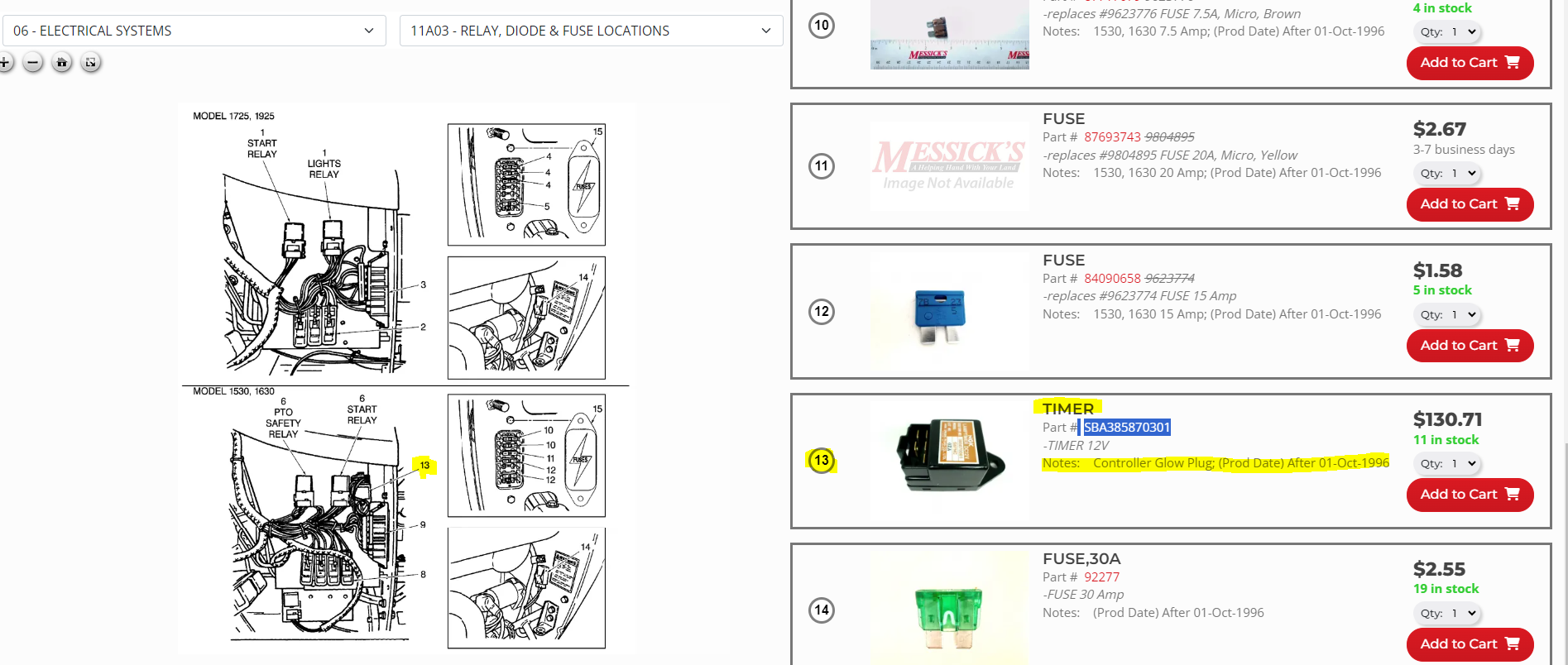

I have a Ford New Holland Boomer (model 1925) built in 1998, I need to know if my tractor has a glow plug timer and if so where is it located at, please send me a diagram of the location, I cannot find it on my tractor.

Welcome.
06- Electrical systems 11A03 -Relay/diodefuse diagram
