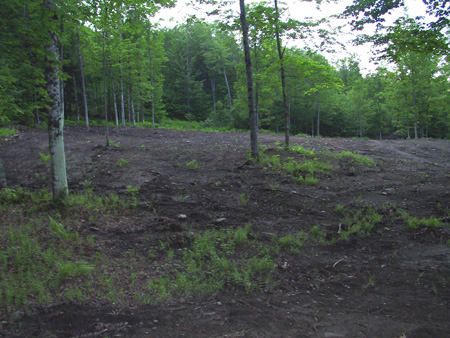

I need to decide which Kubota makes the most sense for me. My property is 10 hilly, rocky acres in Vermont. Realistically, however, more than half of the property will probably never be touched by the tractor, so effectively I have about 4-5 acres to deal with. Here's what I anticipate needing to do:
1) Removing rocks, smoothing and seeding 2 acres that were recently cleared and stumped.

I've attached a picture of my 2 acres I just had cleared and will attach a picture of my driveway shortly.

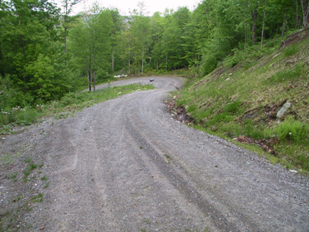

And here's the driveway. Yes, it's pretty steep. You're seeing about 1/3 of it in this shot.

Looking at your pictures and using the thought that pictures do not show how steep a slope is. It looks to me that you may not be looking at big enough tractor in the B series for Vermont weather. /forums/images/graemlins/blush.gif

Altitude, hills, snow, mud and rocks, I would want the horsepower, weight and lifting power of the B7800. From what others have said about the spring mud season up your way I think finish mowing with any of them may be a problem. You can get a pretty good dedicated riding mower for the price of a MMM. That would leave your tire options open and make the tractor better suited for the roads up keep with mud, snow and gravel. We have a road similar to yours at our weekend home and keeping a gravel drive on grade in shape takes some work. I don't get snow and would still be worried about turf tires on gravel with that hill. If you're going to pave the situation may be different. You will, even if you don't plan on it now, end up in the woods some and loaded R4's with their wide foot print sure do help with stability on the hills.
