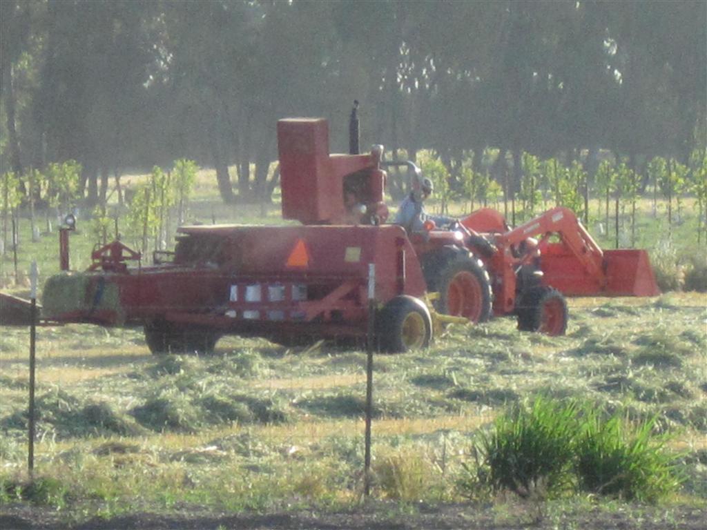

My neighbor bales about 7 acres of forage mix with his Kubota L4400 (45 hp engine, 37 hp pto, 3500 tractor weight) using a 3-twine baler with an on-board engine to run the baler.
His hayfield is flat and level.
