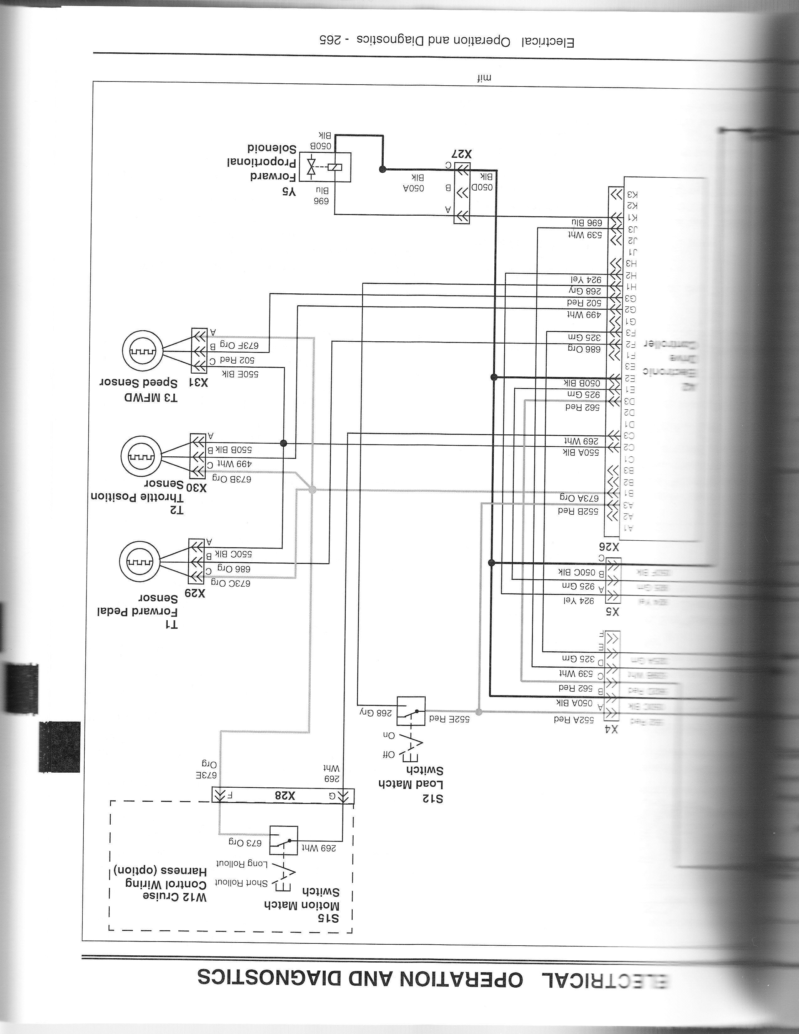

Clearing out the land for a new house, I ran over a random branch that pulled a few wires out of a connector (IE, the connector is still attached, the wires are not though) underneath the tractor. This has caused Error Code 06 to come on constantly since it happened. I know it is the wire to the MFWD sensor. The problem is that I don't know which order they go back in. This is the connector just behind the sensor, 3 wires. If someone could tell me or take a picture of this connector, I would be appreciative.
Seeing as there are a ton of connectors down there, I will probably have to take a picture of the right one.
As an aside, I sincerely wish John Deere either put those wires in a more protected location or made a skid plate. I had another stick pull the HST pedal wire out and stopped me dead in my tracks. Fortunately, the connector separated and the wires were still in there. A plug in and a restart solved that.

Here's a schematic of my 4120 MFWD. I don't know if it's typical, but would think so. I'll try to take a shot of it also, when I get outside.
Hope this helps,
Jon

Here you are... 4120 mfwd connector.
If the colors match up, you should be good go.
Jon

Wow! Thanks. That is exactly what I need. The wires on the right pulled out of the slot (the white bracket is no longer there).
Thanks again!
