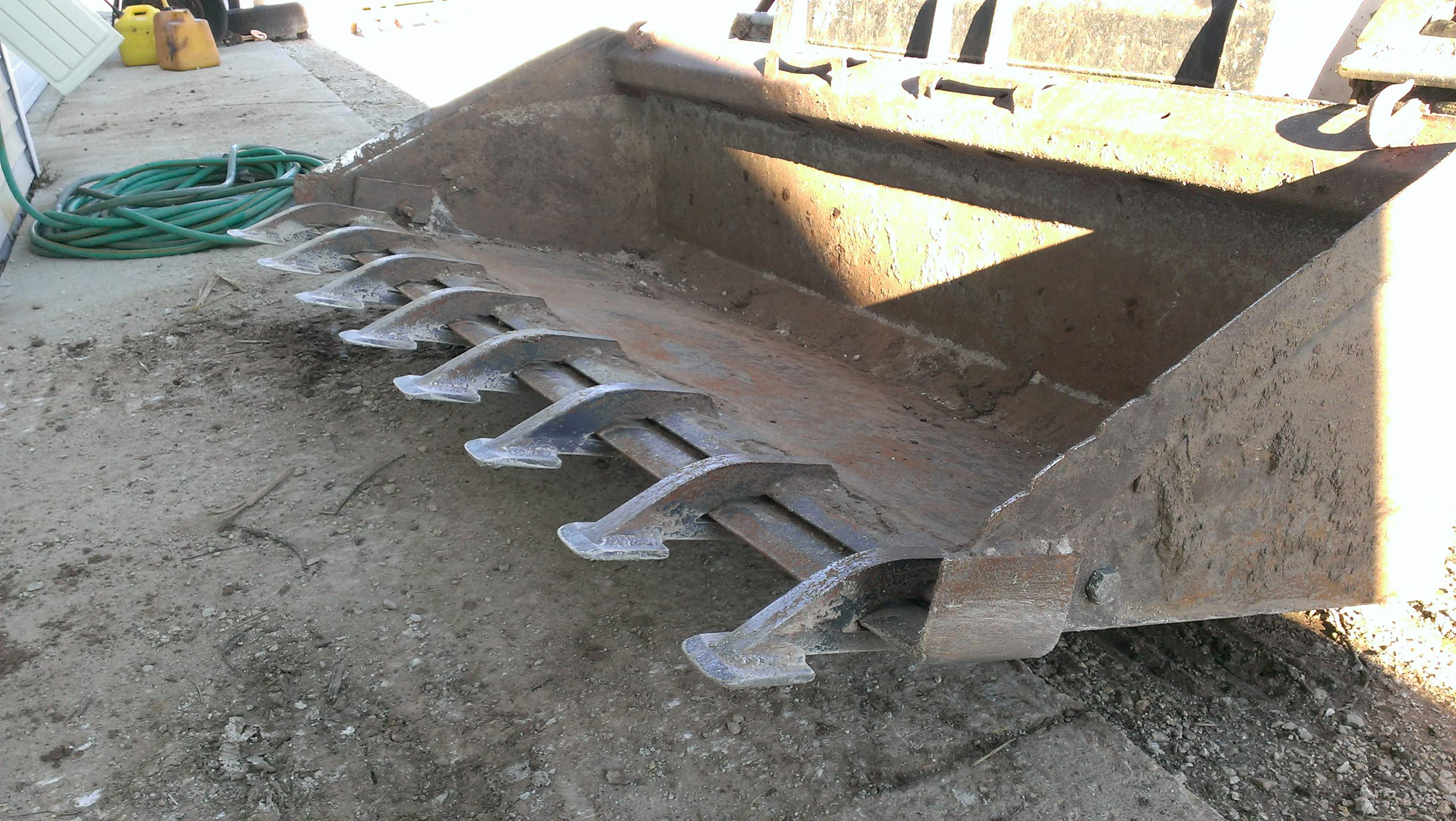

I really like the looks of the Piranha bar. It's been almost three years since I had any dirt work to do so getting one isn't a priority. I have a sketch of something similar that is scaled to the bucket on my present tractor's bucket. The intent was to send one of our waterjet vendors a CADD drawing and have him squirt one out of a piece of stainless bar I found and do a couple of weldments to bolt it on. There aren't any projects here that require digging in the dirt, so maybe that'll never happen. I do have a fencerow that could use a cleanup, but it's only 300' long and a ratchet rake would be a better tool for that.
Here's a picture of the toothbar I made back in '02. Not sure why it doesn't show as a thumbnail:

Something like this? I made it sort of, had the brackets cut that tuck under the bucket and hold the teeth, made the rest and welded together. Get the general idea, its bullet proof goes on and off, not the easiest in the world, but not too bad. We have clay and rocks, one is even bent.

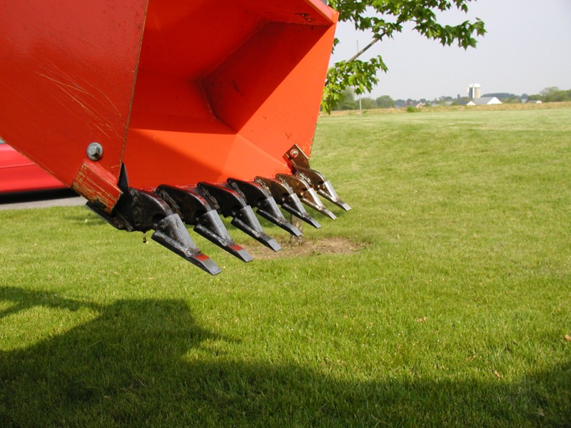

I went to the local bobcat dealer and bought 8 bolt on bucket teeth. They were $30 a piece which included the bolt on piece and the replaceable teeth. They looked like this: http://www.terracutsupply.com/wp-co..._images/Bobcat BoltOn Roll pinTooth Assem.jpg
They required two bolts each and my Deere bucket only has one row of holes. Also the bolts are countersunk and didn't match the countersunk holes on my bucket. They were cast steel so I just welded them on to the top of the bucket with my mig. There is about six inches on each side to weld on plus the front and back so I don't think they are going anywhere. Another plus is the teeth are flush with the bottom of the bucket with nothing protruding below so I can still backdrag.
We dug out and hauled off about 80 yards of dirt today and they were a definite improvement.
I didn't want to weld anything on my kubota backhoe bucket so I ordered a piranha bar for it today. I am excited to see how it will perform.
