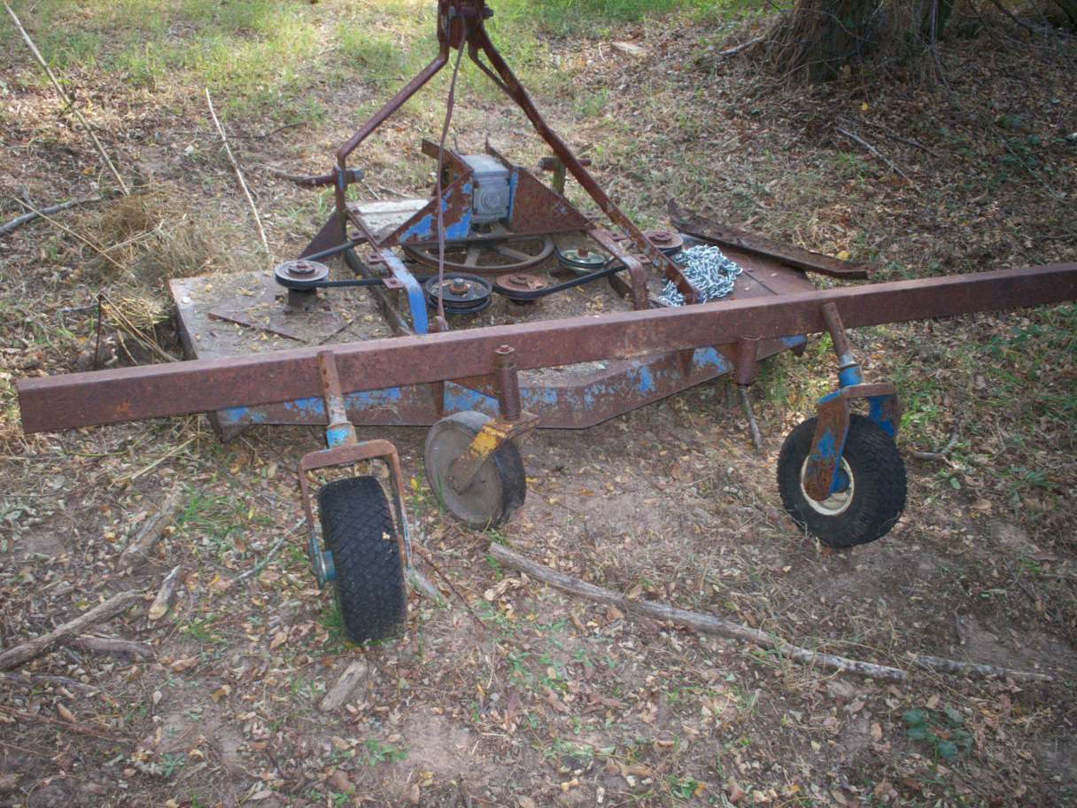

Bought this mower new in 83 when we purchased our Ford 1300, which was also bought new, but from a different dealer. Mower was about 600.00. It has since had the deck reworked where the bearings go (you can see the metal plates that were used). The skid shoe needs repair and welding back on, and the tail wheel needs some attention.

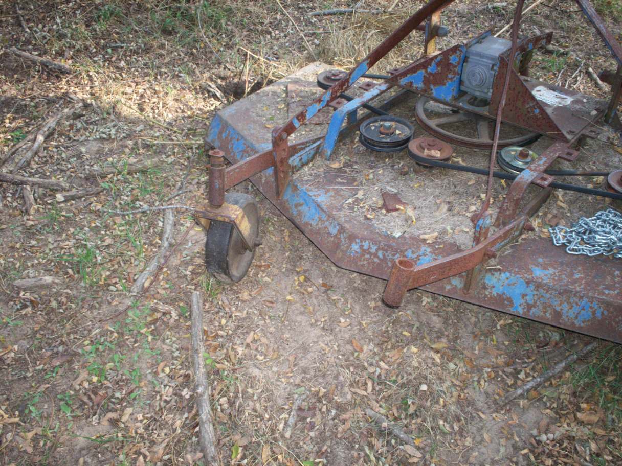

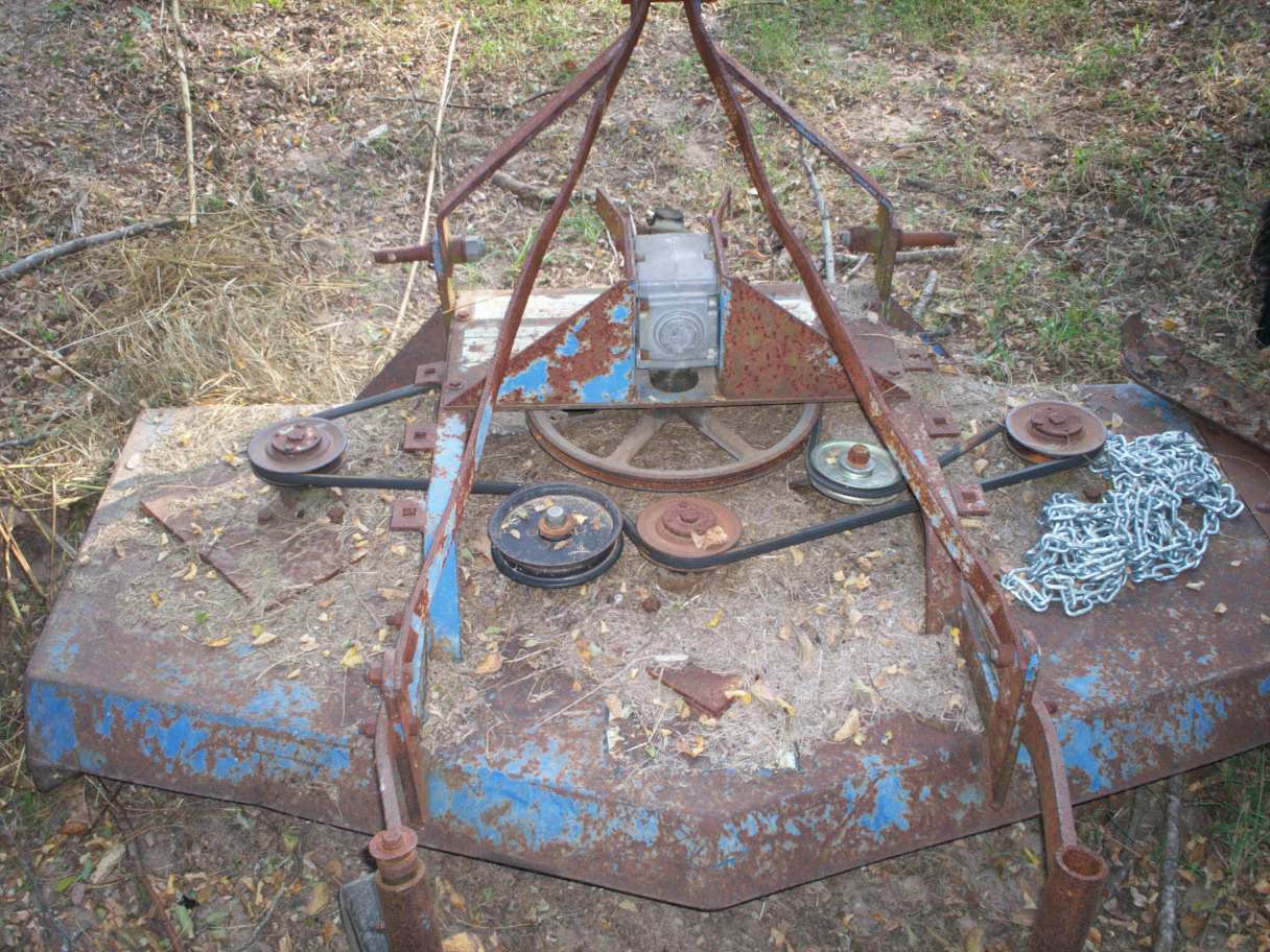

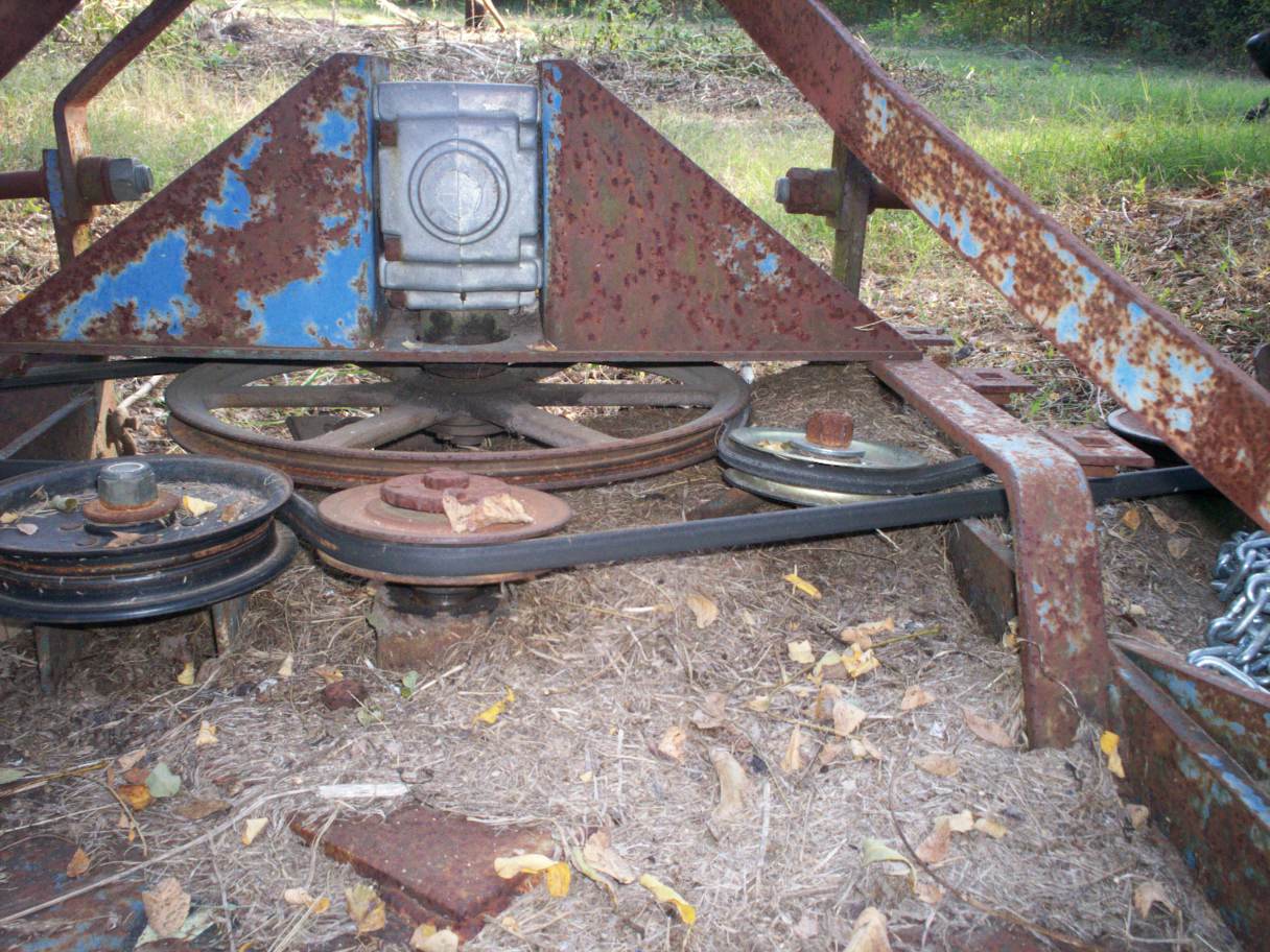

This pic is of the rear of the mower. You can see I have replaced the idler pulley and the belt tensioner pulley (the shiny one) in the past, but now the spring tensioner arm is weak where it goes to deck of mower and is not running true.

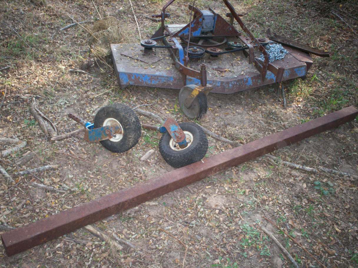

This shows the wheel that needs replacing and the one that is missing. Next couple show the tube and some wheels that I will attempt to install to remedy this situation. Not in a hurry, so this will probably be a nice winter project.
