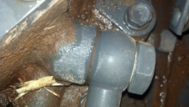

Need some help guys. Putting a third function kit on my 5240 and not sure what or if any fitting adapter will work in that banjo type port. If some of you with a WR Long true third function kit have it on your l40 series tractors with a LA854 loader can you take a peek and see what kinda fitting they are using? Pics would be great too :) thanks in advance

Can you not use the PB port off of the hyd block to add the 3ed function, and then direct the fluid to the 3pt?

JJ the banjo fitting i'm referring to is the power beyond i do believe. Its comes off the loader valve and goes up to the 3point area. It is labeled "BY" on the valve. I could be wrong on this though

I think i might have a fitting that will work! Will find out in the morning

JJ I'm not real sure about those fittings. They're a good thought but have a tendency to fail in high vibration areas. My tractor vibrates but not sure if its enough to cause them to fail. Rather use something more suited for my application.
