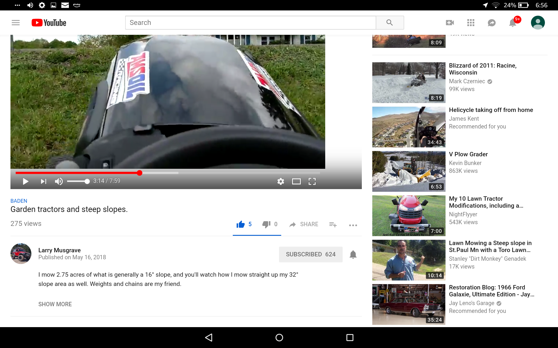

Speciality equipment is expensive. Power Trac offers steep slope mowers. Some folks on TBN swear by certain zero turns. I use a compact tractor and rear 3point mower w/ no issues. Take a look @ Larry Musgrave you tube channel.
He has several videos addressing mowing on steep slopes. He goes by Rock Crawler on TBN

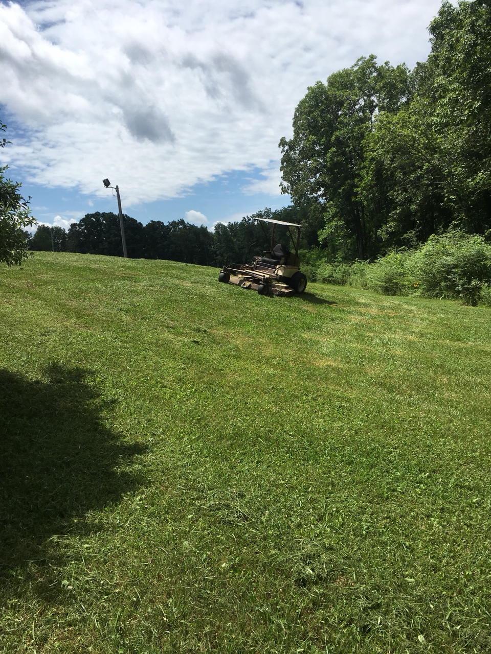

No doubt a ventrac is the best, but I don’t believe it’s needed for 19 degrees. If he can afford it than a ventrac would be great but I think it’s about 25k new. This hill is 17 degrees and I can mow it up, down, or sideways on my ZTR.IMG_4349.JPG
