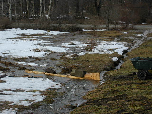

HorseMom, I think others have given you some good advice here. Your choice of solutions will be based on personal preference for surface or subsurface drainage, among other things. If you go the surface water route, be very aware that it doesn't take a lot of slope for water to start "doing it's thing". Depending on your particular setting, if you divert down the existing natural drainage, you may initiate more erosion. The elevation difference between the "inlet" and the "outlet" and grade control and bank resistance (or lack thereof) will determine that outcome. Water in a confined channel will do more work/erosion than unconfined water.
The attached picture shows a diversion I created in response to high flows earlier this year. The ditch at the far downstream end by the road was so saturated it was "headcutting" the small channel back up the hill. Had I not diverted it and spread the water out, I'm pretty sure it would have eroded several feet down and probably about 100 feet back up the hill.
In any event, you may want to consider asking your local County Conservation District for assistance. They often deal with similar drainage issues and probably have considerable experience in your area. Good luck!
