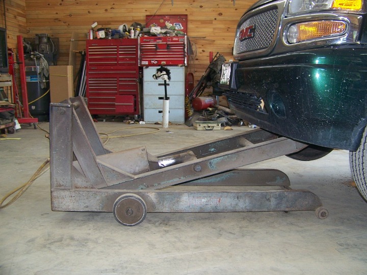

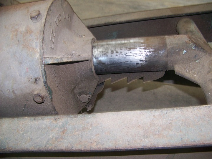

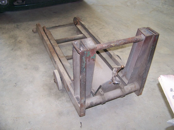

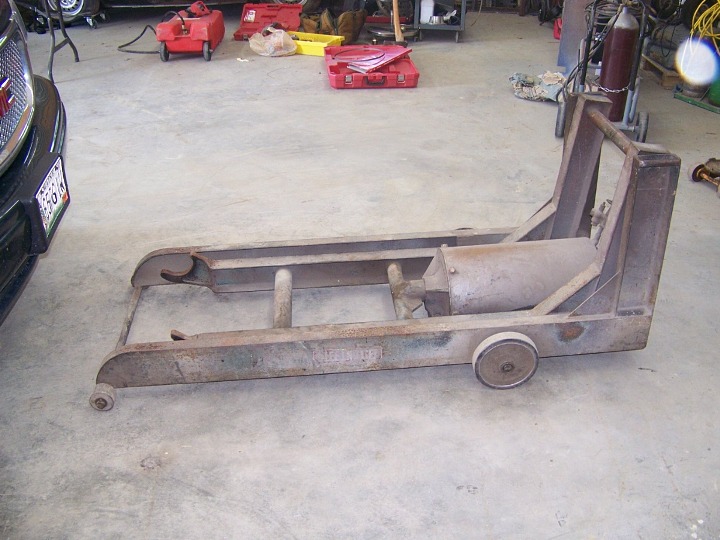

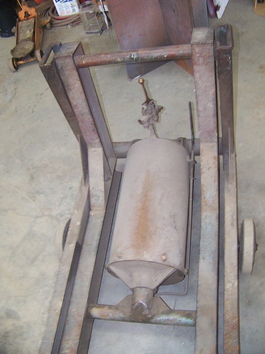

I think my floor jack is just what you described. My father had this in his auto body shop.
pond6 9 18 07 029.jpgpond6 9 18 07 030.jpgpond6 9 18 07 031.jpgpond6 9 18 07 032.jpgpond6 9 18 07 033.jpg
This thing will lift the axle up about 3.5' it is an air cylinder with a built in rack lock. I don't know the brand but it's not home made.
View attachment 108746View attachment 108747View attachment 108748View attachment 108749View attachment 108750
They are called a mobile bay lift. Now obsolete, the most recent ones were made by Blackhawk. They are a very safe self locking jack. They will go higher than 3 1/2'. The newer ones will do almost 5'
They usually go $250-$500 used.
If you have 2, you can pick up both ends as long as the vehicle is not real heavy.
They work great with a straight axle. We stopped using them in the 80's because newer independent suspension systems do not work well with them.
I have the newer version, it has 2 cylinders and lifts a little higher.
